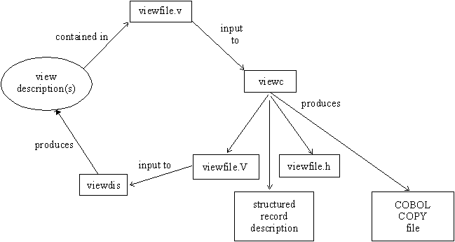

As mentioned in Chapter 2, "Overview," FML VIEWS is a mechanism that allows the exchange of data between fielded buffers and C structures or COBOL records. This capability is provided since it is usually more efficient to perform lengthy manipulations on C structures with C functions than on fielded buffers with FML functions. It also provides a way for a COBOL program to send and receive messages with a C program that handles FML fielded records.
This section discusses VIEWS and how to use it to provide fielded buffer/structure mappings. The figure below shows the various components of VIEWS and how they relate to one another. Each component is explained in the following sections.
Figure 4-1 Views
Source viewfiles are standard text files (created through any standard text editor, such as vi) that contain one or more source view descriptions (the actual field-to-structure mappings).
The view compiler produces (among other things) object viewfiles containing the compiled object view descriptions. These object viewfiles can in turn be used as input to the view disassembler (viewdis or viewdis32), which translates the object view descriptions back into their source format (for verification or editing).
You create and edit the source view descriptions (or edit the output of viewdis) only; compiled view descriptions are not readable by an editor.
Besides the actual view description(s), viewfiles can contain comment lines, beginning with # or $. Blank lines and lines beginning with # are ignored by the view compiler, while lines beginning with $ are passed by the view compiler to any header files generated. This lets you pass C comments, what strings, etc., to C header files produced by the view compiler; they are not passed through to the COBOL copy files.
