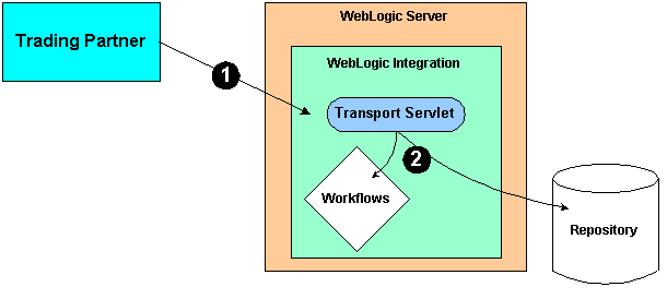

Authentication of the Trading Partner Message
After a trading partner's certificate has been validated by WebLogic Server, the B2B engine needs to authenticate the trading partner message before the message itself can be serviced. Authenticating the trading partner message involves verifying that the sender of the business message is a valid trading partner listed in the WebLogic Integration repository. After a trading partner message has been authenticated, the trading partner's identity becomes recognized for full access to B2B resources.
The following figure shows the process of authenticating a trading partner message.
Figure 2-2 Authenticating the Trading Partner Message
In the preceding figure, note the following:
Note: Only trading partners can be authenticated to use the B2B transport servlet. If the B2B system user attempts to access the transport servlet to access B2B resources, the access is denied by WebLogic Server. This mechanism ensures that no remote entity can gain access to B2B resources assuming the identity of a B2B system user.
