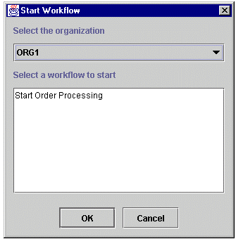

  1. From the Workflow menu, choose Start Workflow to display the Start Workflow dialog box.
    Figure 5-2 Start Workflow Dialog Box

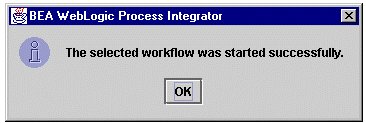

  2. Select the Start Order Processing workflow and click OK. The workflow is instantiated and a confirmation message is displayed.
    Figure 5-3 Workflow Successfully Started
  3. Click OK.

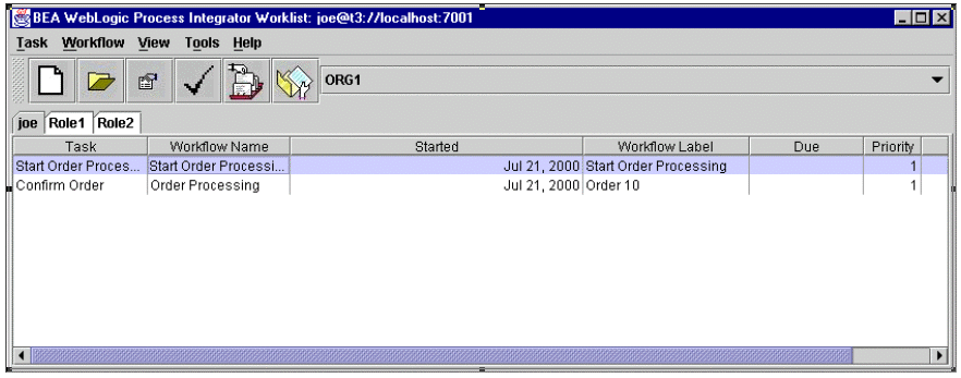

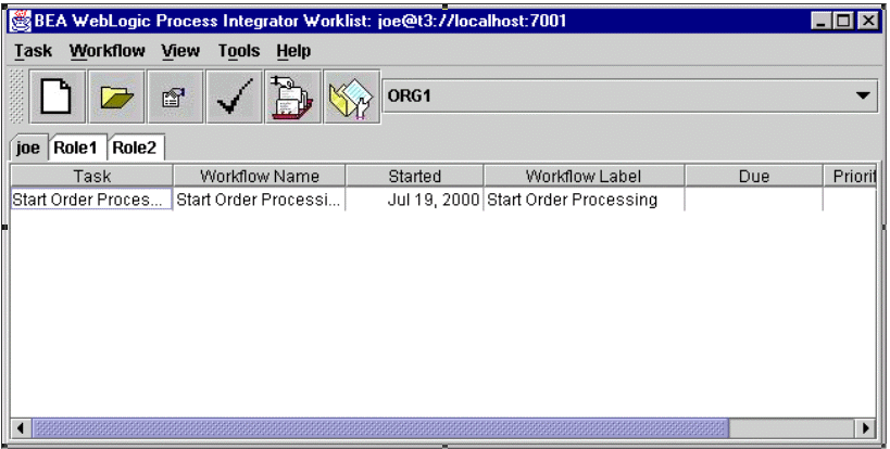

    The first and only task of the Start Order Processing workflow is assigned to the user joe and is displayed on the worklist.
    Figure 5-4 Worklist Application: Task List
  4. Double-click the Start Order Processing task to execute the actions defined earlier under the Executed event of the Start Order Processing task; in this case, the creation of an XML document that triggers the Order Processing workflow.
    The first task of the Order Processing workflow is Confirm Order, which is assigned to the user joe. This task is displayed on Joe's worklist, once the workflow is triggered.

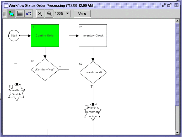

  5. To verify that the Order Processing workflow has been triggered, you open the instances window of that workflow. In the WebLogic Process Integrator Studio, right-click the workflow template definition for the Order Processing workflow and choose Instances from the pop-up menu. The following dialog box is displayed.
    Figure 5-6 Workflow Status Dialog Box
    The diagram shows the instance that has been started.
  6. Right-click anywhere in the instance diagram to display a menu with the following options:
  7. Choose Workflow Status to find out which node is the current active one.
    The Confirm Order task will be highlighted, showing that it is active and not yet executed.

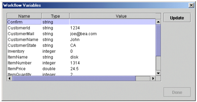

  8. Choose the Variables option to display the list of Order Processing workflow variables and their current values.
    Note that all variables defined in the Start node are populated by the values coming from the XML document. The variable Confirm is still empty because the user has not confirmed the order yet.

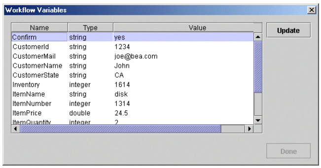

  10. Click Yes to make the flow proceed and call the Inventory bean. Check the status of the Order Processing workflow again in the instances dialog box and particularly the values of the variables.
    The dialog box shows that both Confirm and Inventory now have values.

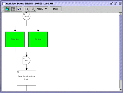

  11. In the Studio application, right-click the ShipBill workflow template definition in the folder tree and choose Instances from the pop-up menu to display the started instance of the ShipBill workflow.
    Figure 5-11 Workflow Status: ShipBill Workflow
    Note that the Shipping and Billing tasks are highlighted in green, because they are still active and have not been executed and marked done.

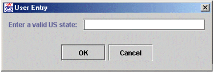

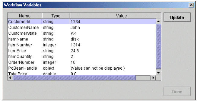

  13. In the worklist, double-click the Billing task to execute it. The Billing task attempts to call the POBean, but since it purposefully (for this demonstration) contains an invalid parameter (state abbreviation KK), the exception handler is invoked.
    Note that the CustomerState variable contains an invalid value: KK.
    Figure 5-12 Invalid Workflow Variable Value
    When WebLogic Process Integrator invokes the exception handler, the Send XML to Client action is executed and you are prompted to enter a valid United States state abbreviation.
    Figure 5-13 User Entry Dialog Box
  14. Enter a valid state abbreviation and click OK to continue the workflow.

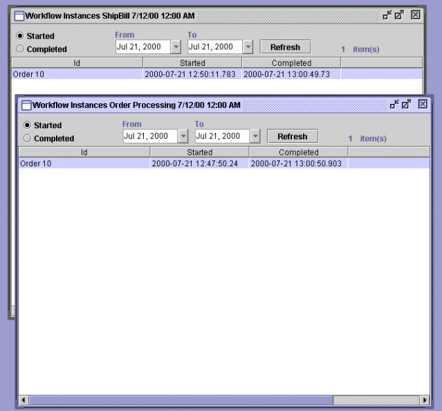

  16. Double-click the Send Confirmation Back task to execute it and send an XML message back to the Order Processing workflow that completes the process.

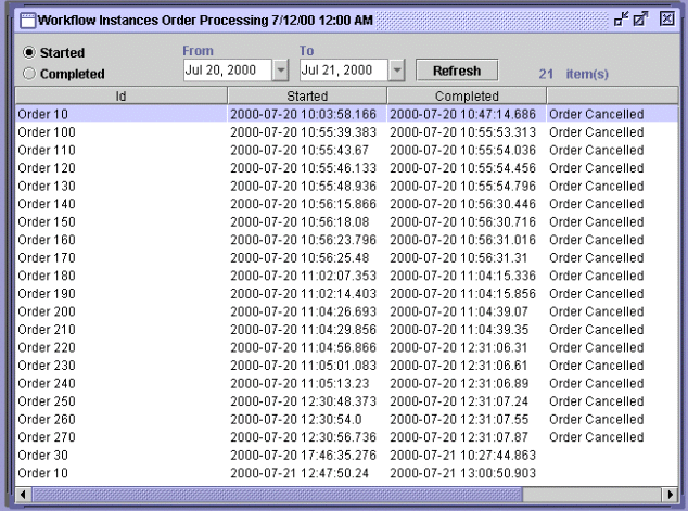

    The Order Processing and ShipBill workflow instances are marked as complete as reflected in the monitoring dialog boxes. The completed date and time are displayed.
    Figure 5-15 Workflow Instances Dialog Boxes: Completed Date and Time
    The preceding procedure is one scenario for this process. Another scenario that can be tested is to answer No to the confirmation and cause the order to cancel. In this case, the monitoring dialog box shows the instance of the Order Processing workflow with the comment Workflow Cancelled as defined in the Set Workflow Comment action.
