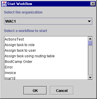

Starting a Workflow
To start a workflow for you as the user or you in a role to which a task is assigned:
  1. Select Workflow —> Start a Workflow from the menu bar. The Start Workflow dialog box displays.
    Figure 3-1 Start Workflow Dialog Box
  2. Select the organization that contains the workflow you want to start in the Select the organization drop-down list. This list displays all the organizations to which you belong.
  3. Select the workflow to start from the Select a workflow to start scroll list. The workflows that appear in this list represent all available workflow template definitions that you can start manually. Such workflows are marked active or manual start at workflow design time.
  4. Click the OK button to start the workflow. The processing that occurs during startup depends on the definition of the workflow created at design time. See BEA WebLogic Process Integrator Studio User Guide for more information.
    After the workflow starts successfully, the BEA WebLogic Process Integrator dialog box displays.

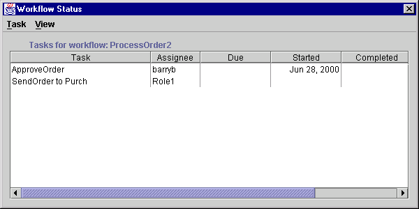

Viewing Workflow Status
To view the status of all tasks associated with the workflow of the selected task:
  1. Select the task whose workflow status you want to view on the User ID tab or the appropriate Role tab.
  2. Select Workflow —> Workflow Status from the menu bar. The Workflow Status dialog box displays.
    Figure 3-3 Workflow Status Dialog Box
    Optionally, right click on any task listed in the Task column. A popup menu displays showing all the actions you can do with tasks.
