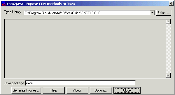

Start com2java by typing it in a command shell or double clicking its icon.
When you start com2java, this is the dialog that is displayed:
Selecting the Type Library
Click the Select button to select the type library that the tool should process.
Remember that type libraries can sometimes be hidden inside executable files, such as the executable or dynamic link library (DLL) containing your COM component.
The com2java tool will remember a list of the last type libraries you successfully opened and generated proxies for.
Specifying the Java Package Name
The com2java tool generates a set of Java source files corresponding to the COM classes and interfaces in the type library. You will probably want to have the generated files in a specific package. For example you may want to put all the files for the Excel type library in a Java package called excel.
In the Java package text box, specify the name of the package to which the generated files to belong.
The com2java tool remembers the last package name you specified for a particular type library.

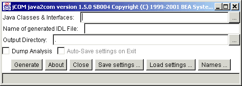

To generate the IDL file and the wrappers, first start the java2com tool using the command:
java com.bea.java2com.Main
The java2com tool displays the following dialog box:
The dialog box has the following fields (any changes to the configuration are automatically saved when you exit the dialog box).
Field
Description
Java Classes and Interfaces
These are the 'root' Java classes and interfaces that you want java2com to analyze. They must be accessible in your CLASSPATH. WebLogic jCOM analyzes these classes, and generates COM IDL definitions and Java DCOM marshalling code which can be used to access the Java class from COM. It then performs the same analysis on any classes or interfaces used in parameters or fields in that class, recursively, until all Java classes and interfaces accessible in this manner have been analyzed.
Separate the names with spaces. Click on the ... button to display a dialog that lists the classes and lets you add/remove from the list.
Name of Generated IDL File
This is the name of the COM Interface Definition Language (IDL) file which will be generated. If you specify myjvm, then myjvm.idl will be generated. This name is also used for the name of the type library generated when you compile myjvm.idl using Microsoft's MIDL compiler.
Output Directory
The directory to which java2com should output the files it generates. The default is the current directory (".").
Dump Analysis
Displays the classes that the java2com discovers, as it discovers them.
Save Settings/Load Settings
Click on the Save Settings button to save the current java2com settings. Do this before you click Generate.
When java2com starts, it checks to see if there is a java2com.ser setting file in the current directory. If present, it loads the settings from that file automatically.
Names
Clicking the Names button displays the following dialog box:
When '*' is selected from the class/interfaces names drop-down list, a text box is displayed into which you can type the name of a member (field or class) name. You may specify a corresponding COM name to be used whenever that member name is encountered in any class or interface being generated. If you leave the name blank then that Java member will not have a corresponding member generated in any COM interface.
When a specific COM class name or interface is selected from the class/interfaces names drop-down list, the set of members in that class or interface is listed below it. You may specify a COM name to be used, and by clicking on Add this Class Name map you map the selected class/interface to the specified COM name. By clicking on Add this Member Name map you may map the selected member to the specified COM name.
Generate button
Click this button to generate the wrappers and IDL file.

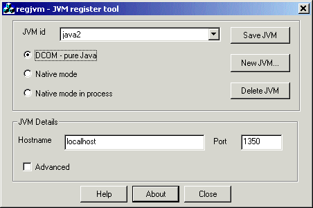

DCOM mode
DCOM mode does not require any native code on the Java server side, which means your Java code may be located on a Unix machine or any machine with a Java Virtual Machine installed. When you register the JVM on the Windows client machine you define the name of the server host machine (it may be localhost for local components) and a port number.
The Java code in the JVM must call com.bea.jcom.Jvm.register(<jvm id>), where <jvm id> is the id of the JVM as defined in regjvm.

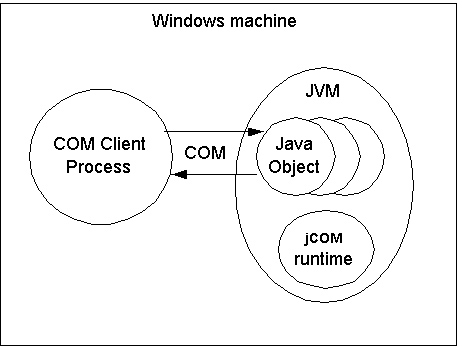

Native Mode in Process
Using native mode in process allows the user to actually load the Java object into the same process as the COM client. Both objects must of course be located on the same machine.
The JVM need not call com.bea.jcom.Jvm.register() or be started as an extra process to the client.

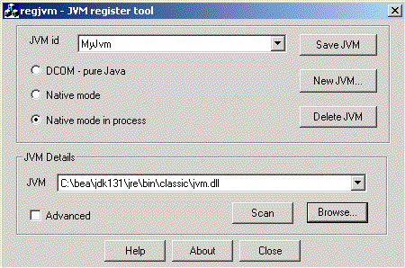

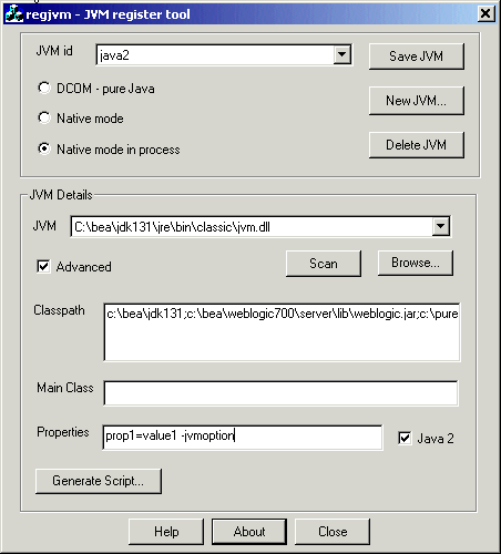

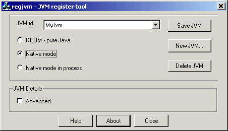

The User Interface of the regjvm GUI Tool
Run the regjvm tool to display the following dialog box.

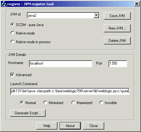

DCOM Mode Options for the regjvm GUI Tool
Standard Options
Advanced Options

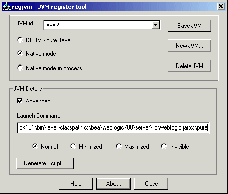

Native Mode Options for the regjvm GUI Tool
Standard Options
Advanced Options
The advanced options are identical to those of DCOM mode. See DCOM Mode Options for the regjvm GUI Tool.
Native Mode in Process Options for the regjvm GUI Tool
Standard Options
Advanced Options

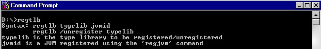

WebLogic jCOM's regtlb tool registers a type library on a COM Windows client that needs to access Java objects using COM's early binding mechanism. regtlb takes two parameters. The first is the name of the type library file to be registered. The second is the ID of the JVM in which the COM classes described in the type library are to be found.
If the type library was generated from an IDL file that was in turn generated by the WebLogic jCOM java2com tool, then the regtlb command can automatically determine the Java class name corresponding to each COM class in the type library (the COM class descriptions in the type library are of the form:
Java class java.util.Observable (via jCOM))
If the type library was not generated from a java2com generated IDL file, you will be prompted to give the name of the Java class which is to be instantiated for each COM class:
This means that when someone attempts to create an instance of Atldll.Apple, WebLogic jCOM will instantiate com.bea.MyAppleClass in the JVM MyJvm. The MyAppleClass class should implement the Java interfaces generated by WebLogic jCOM's java2com tool from atldll.tlb that are implemented by the COM class Atldll.Apple.
