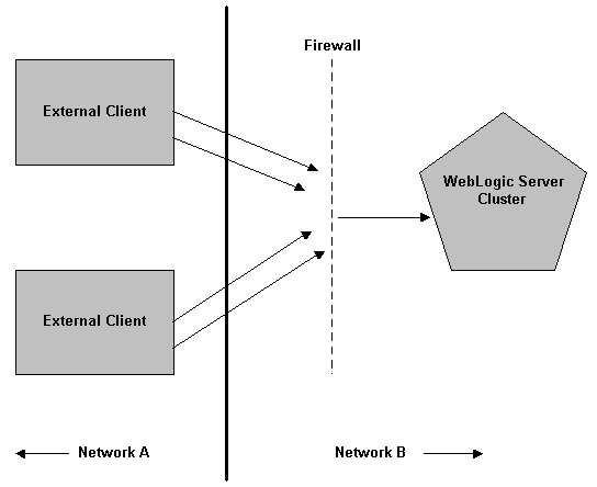

There are many ways to combine firewalls, WebLogic Server, and other network servers. Figure 2-1 illustrates a typical setup with a firewall that filters traffic destined for a WebLogic Server cluster.
Figure 2-1 Typical Firewall Setup

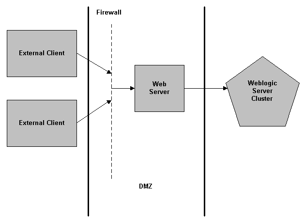

Another common firewall configuration restricts access to only HTTP or HTTPS Web connections. The firewall permits clients to connect only to a Web server which usually runs at the standard HTTP port 80 or HTTPs port 443. The Web server may be a WebLogic Server or a third-party Web server set up to proxy requests to a WebLogic Server. For example, Netscape Enterprise Server, Microsoft Internet Server, and Apache Server can be set up to serve static Web pages and proxy servlet and JSP requests to WebLogic Server. Figure 2-2 illustrates this configuration.
In Figure 2-2, the Web server is a gateway operating in a demilitarized zone (DMZ). In computer networks, a DMZ is a computer host or small network inserted as a neutral zone between a company's private network and the outside public network. It prevents outside users from getting direct access to a server on which company data resides. A DMZ is an optional and more secure implementation of a firewall which can also act as a proxy server. WebLogic Server connections come only from proxied Web server requests, enhancing the security of your WebLogic Server applications and back-end resources. In the configuration shown in Figure 2-2, clients interact exclusively with the Web server and WebLogic Server connections are made only by proxied Web server requests. As a result, the security of WebLogic Server applications and back-end resources that are configured in this way are enhanced.
Figure 2-2 Firewall with Web Server Gateway
