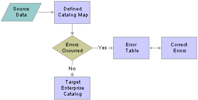

After a partner's offering data has been successfully imported into Catalog Management, it can be transformed into the enterprise catalog format and then loaded into the enterprise catalog.
The transformation of data is based on the catalog map that you defined for the partner's source file.
You can use three different methods to load offering data into the enterprise catalog:
The following diagram illustrates the transformation and loading data process:
Transformation and loading of source data
Note. The process of transferring and loading data from a shared catalog source to the enterprise catalog format, using a master data map is similar to transferring and loading data for a single partner. The only difference is when you select the catalog map object. The selection is restricted to master catalog maps associated to the selected partner.
