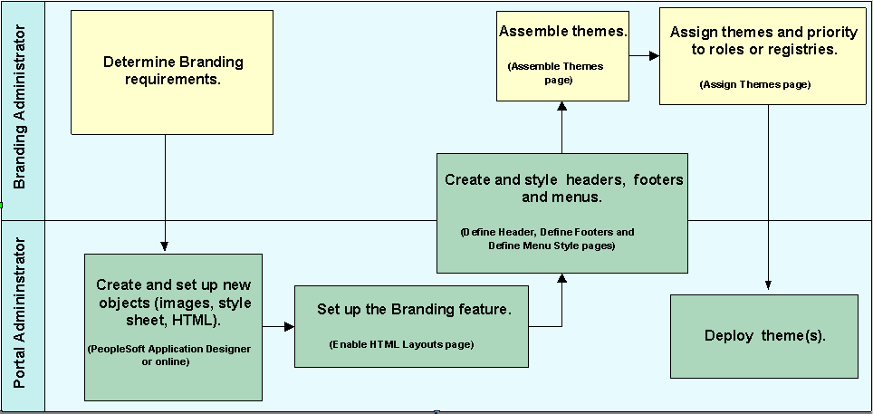

Branding Theme Development Process FlowThis section discusses:
Determining branding requirements
Creating and setting up new objects
Setting up the branding feature
Creating and styling headers, footers, and menus
Assembling branding themes
Assigning roles to themes and creating role precedence lists
Deploying roles and theme assignments
Branding development process flow
Determining Branding Requirements
To determine the branding requirements of your organization, you most likely will work with a branding administrator, a communications manager, or someone in a similar role, to determine the look and feel that you want to produce on the portal.
The next step is to preview the delivered branding themes and determine one or more themes to implement that match your business requirements
After you identify these themes, you can determine any custom images (such as your company logo), styles, color schemes, and so on that need to be included in the theme(s).
You then provide these styles and images to the portal administrator, so that he or she can transform the design components into objects that you can use with Enterprise Portal Branding.
Creating and Setting Up New Objects
Using the images and color schemes identified as branding requirements, the portal administrator creates new objects using PeopleSoft Application Designer or can upload them using the branding pages.
Objects that you might want to upload or modify typically include:
Image objects. Images utilized by the HTML layouts of the header, footer and menu pagelets.
Style sheet objects. Style sheets for borders, fonts, and colors.
Snippets of HTML. Used for adding free-form HTML and other objects, such as dynamic information, to a layout at predefined HTML-configurable positions.
HTML objects. HTML for the header and footer. (If you create your own HTML layouts from scratch.)
Setting Up the Branding Feature
Enterprise Portal Branding is delivered enabled.
Note. If you disable Enterprise Portal Branding, the system reverts to the standard PeopleTools branding functionality, where there is little flexibility for configuration and dynamic changes.
Therefore, the only steps the portal administrator needs to perform to set up the feature are:
View the system elements to review and specify elements that sites can override.
Enable the HTML layouts.
Creating and Styling Headers, Footers, and Menus
You must configure the components and elements that you will use in themes, such as headers, footers, style sheets and menus, including the images and links that you will use on these items.
Note. The delivered headers, footers and menus consist of system data. During the upgrade process new system data will overwrite existing system data. Therefore, to support software upgrades, use the Copy Header and Copy Footer features to create headers and footers with unique header and footer names. In the case of menus, create new ones.
The Enterprise Portal Branding application pages allow you to:
Assign and refine images.
Construct links.
Modify delivered headers, footers and so on.
Copy an existing header or footer to use as a starting point for your configuration.
Create versioned (effective-dated) headers and footers.
Select the bar elements to display and use in headers, such as Home, Worklist, Add to My Links, and Signout.
Configure the special elements, like Search options, My Links, homepage Help and homepage tabs.
After you configure components and elements, you assemble them into a theme or themes.
Assigning Roles to Themes and Creating Role Precedence Lists
After you define themes, you can create the hierarchy of when specific themes are to appear to different registries or users.
There is a default theme for each of the portal registries and the database as a whole, and you can optionally assign themes to user roles and set the theme priorities. All the theme assignments are effective dated.
If no theme assignments exists, the branding defaults to the database default theme. If no theme is designated as the database default, the branding will fall back to the PeopleTools-delivered look.
See Default Branding Themes and the Branding Theme Hierarchy.
Deploying Role and Theme Assignments
After you customize branding themes you must deploy the role and theme assignments. The steps to accomplish this task vary, depending on the environment (development or production) that you use to develop the themes.
See Deploying Branding Themes.
