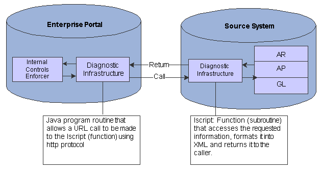

Diagnostic ArchitectureThe diagnostic architecture is designed to track external source system configuration data that is either low in volume, or is exception information from high volume tables. For example, a diagnostic should not query the entire customer list, rather it should look for specific exceptions to the customer list, such as customers that do not have a defined credit limit. If the queries and functions that are used by diagnostics are not designed using this principal, system performance will severely degrade and the diagnostic could fail; a diagnostic report is limited to 1000 rows and 30 columns.
This diagram depicts the diagnostic architecture.
Diagnostic architecture

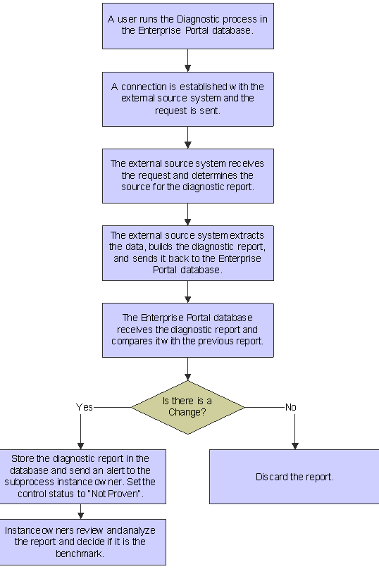

Diagnostics Data Feed Process Flow This diagram shows the process flow for the Diagnostic Data Feed Application Engine process (EPQ_DIAG_FCH).
Diagnostic Data Feed process flow
