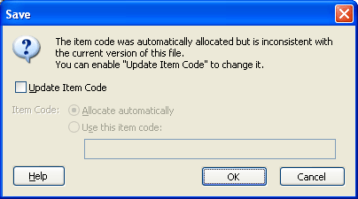

This dialog will be displayed if you try to save a sealed document with an out of date item code and you have the right to update the item code (Set Item Code right). This may happen when you rename a sealed document, then edit it and save it.
| Element | Description |
| Update Item Code (checkbox) | Normally unchecked. Check if you want to update the out of date item code. |
| Item Code | Allocate automatically: Select to have a new item code generated by Oracle IRM Desktop.
Use this item code: Select if you already have an item code that you want to allocate to this document. Selecting this option activates the accompanying input box, into which you can enter the new item code. |

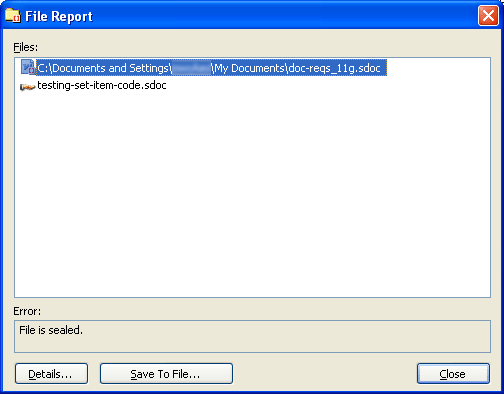

This dialog shows the results of a sealing operation when one or more files failed to seal.
| Files (list) | Lists the files that were not sealed during the recent sealing operation. |
| Error (display) | Shows the error related to the highlighted item in the Files list. Gives the reason why a file was not sealed. |
| Details (button) | Opens a dialog showing more details, if available, about why the file was not sealed. |
| Save to File (button) | Opens the Save As dialog to let you save the details in this report dialog as a text file. |

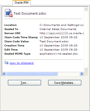

Open the tab by right-clicking the filename of a sealed document in a file browser and selecting Properties, then selecting the Oracle IRM tab.
| Scrollable display area | Shows the properties of the document you are currently viewing. |
| Copy to clipboard (link) | Copies the properties information to the clipboard, from where it can be pasted into a text application. |
| Test (button) | Opens the Oracle IRM Server Connection Test Dialog, through which you can test your connection to servers. |
| Save Metadata (button) | Enables you to save a copy of the sealed file metadata in XML format. |

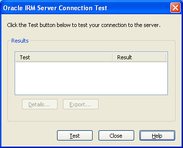

This dialog is available from Oracle IRM Desktop status pages, and from the Test button on the Oracle IRM tab in the properties dialogs for sealed documents.
The Server Connection Test dialog can help to diagnose network problems and help your administrator to resolve them.
| Results | Test column: Identifies each test. Usually includes a simple connection test to the server, which requires no authentication of the user. Also usually includes an authenticated connection to the server, for which user credentials may have to be supplied through the Oracle IRM Server Credentials dialog.
Result column: Shows the result of the test (Pass, Fail, Canceled). Details button: Select to open a message box with more information about the tests, if there is any. Export button: Select to open a dialog through which you can save the test information as an HTML document. |
| Test (button) | Starts the test routine. |

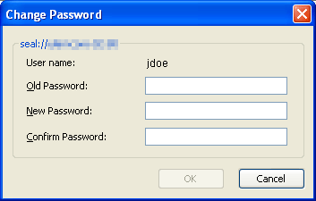

This dialog is available from the Change Password link on the Account tab of the Oracle IRM Desktop Control Panel. The Account tab is available only for some documents sealed against a 10g server.
Use this dialog to change the password used by the current user to access documents sealed on a 10g server.
| Server name (display) | Shows the name of the server on which the current document is sealed, and for which the password change will apply. |
| User name (display) | Shows the name of the current user. |
| Old Password (text box) | Enter the current password for the user shown above. |
| New Password (text box) | Enter the new password to be used for the user shown above. |
| Confirm Password (text box) | Enter the new password again, in exactly the same way. |
