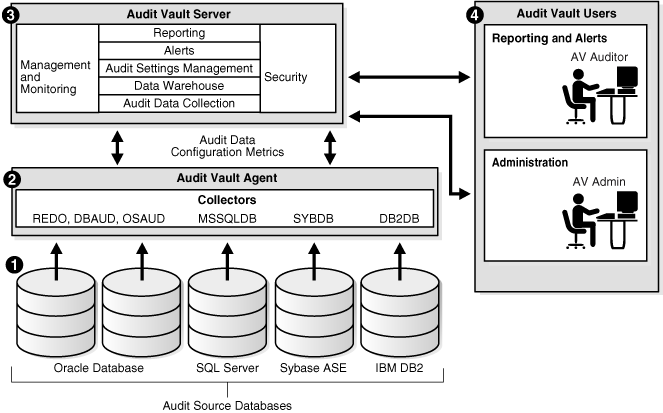

Figure 1-1 provides a high-level overview of how the Oracle Audit Vault components work together.
Figure 1-1 Overview of the Oracle Audit Vault Components
The process flow for the Oracle Audit Vault components works as follows:
The source databases, Oracle Database, SQL Server, Sybase ASE, and IBM DB2, have all been configured to use their respective collectors:
Oracle Database uses the REDO, DBAUD, and OSAUD collectors.
SQL Server uses the MSSQLDB collector.
Sybase ASE uses the SYBDB collector.
IBM DB2 uses the DB2DB collector.
As Figure 1-1 shows, you can configure multiple databases from different database product families using the same Audit Vault collection agent to connect to the same Audit Vault Server.
The collectors listed in Step 1 retrieve the audit data from their source databases and send this data to the Audit Vault Server.
The Audit Vault Server collects and stores this data in the database, and then makes it available in the warehouse.
The data warehouse organizes this data into a set of internal dimension tables. The Audit Vault Server stores other information as well, for both the auditor and the administrator.
Once the audit data is in the data warehouse dimension tables, an auditor can retrieve this data to generate and customize reports, as well as send e-mail notifications and trouble ticket alerts.
Any settings that you, the administrator, create, such as security settings, are contained in this server. The Audit Vault Server stores all the tools that you need to configure the Audit Vault components and source databases.

This section contains:
About Planning the Source Database and Collector Configuration
Planning the Oracle Source Database and Collector Configuration
Planning the Microsoft SQL Server Source Database and Collector Configuration
Planning the Sybase ASE Source Database and Collector Configuration
Planning the IBM DB2 Source Database and Collector Configuration
This section provides guidelines for selecting the correct Oracle Audit Vault collector for the source databases from which you want to extract audit data. In brief, for Oracle Database, the type of collector that you select depends on the type of auditing that you have enabled in the source database. The Microsoft SQL Server, Sybase ASE, and IBM DB2 databases each use one collector specific to each of these database products.
After you understand which collector to choose, you are ready to register the source database and collector with Oracle Audit Vault.
To plan the Oracle Database source database and collector configuration:
Ensure that auditing has been enabled, and find the type of auditing that the Oracle source database uses.
See Oracle Audit Vault Auditor's Guide for more information about the Oracle Database requirements.
Based on the audit trail setting, determine which collector to use.
The type of auditing that has been enabled determines the collector you will choose. The types of collectors available are as follows:
OSAUD collector. Use this collector if the audit trail is being written to operating system files. Table 1-8 lists the operating system audit trail settings that use the OSAUD collector.
DBAUD collector. Use this collector if the audit trail is being written to the database audit trail. Table 1-9 lists of the database audit trail settings that use the DBAUD collector.
REDO collector. Use this collector if the database is collecting audit data from the redo logs. Table 1-10 shows more information about redo logs.
Register the Oracle source database and the appropriate collector with Oracle Audit Vault, as described in Section 2.3.
