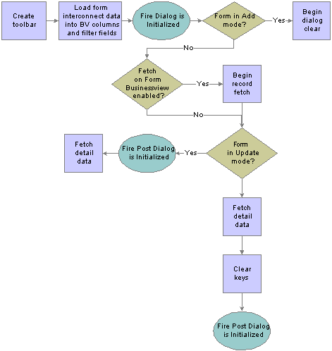

This flowchart illustrates the tasks that runtime performs after initializing these objects to complete dialog initialization:
Header detail form initialization
This list discusses how runtime clears the form in preparation to display retrieved data:
If the form was called in Copy mode, clear the key (primary index) controls for which the Do not clear after add option was enabled.
If the form was not called in Copy mode, clear all form controls for which the Do not clear after add option has been disabled.
Fire the Clear Screen Before Add event.
Fire the Post Dialog is Initialized event.
After dialog initialization, runtime populates the form only if it is in Update mode. Then, it seeks to populate the header if the Fetch on Form Businessview option is enabled. If enabled, runtime fetches the header record and populates the controls in the header.
Next, runtime performs a fetch and populates the grid if the Automatically Find on Entry and the Fetch on Grid Businessview options are both enabled. The fetch an populate process used is standard for grid controls.
See How Runtime Processes the Grid Control.

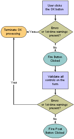

OK is a standard button on header detail forms that appears by default. It causes runtime to validate the information on the form and update or add it to the database through JDEKRNL function calls.
This flowchart illustrates the initial tasks that constitute runtime processing for the OK button:
Header detail OK button processing, part 1 of 4

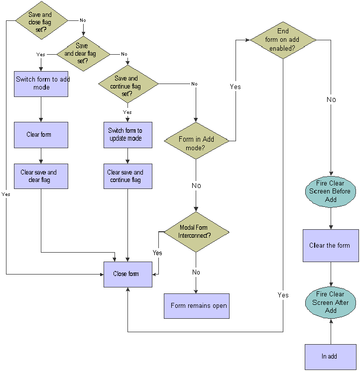

This flowchart illustrates how runtime processes any mode changes during OK button processing:
Header detail OK button processing, part 3 of 4
