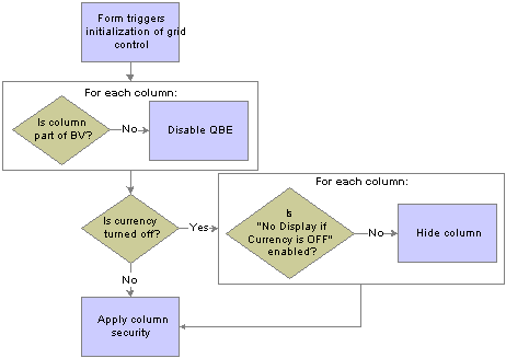

Click to jump to parent topicGrid Control Design-Time Considerations
Grid columns can have a heading row and might also have a QBE row to facilitate user searches. Additionally, you can specify rows or columns to display information that you acquire or calculate during runtime. Typically, the rest of the rows contain data. Generally, this data comes from database tables.
Usually, when you make the grid control, you place data items in the grid. The data items can come from the BV attached to the form, or they can be based on DD items. Either way, each data item becomes a column. Just as the grid control itself has a variety of property settings, you can set property values for each column in the grid as well.
You have a great deal of control, both at design time and at runtime, over how the grid appears, what it displays, and how it functions.

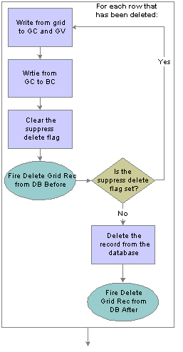

The pattern for deleting a row is similar except that runtime notifies you before and after the user action as well as the commits:

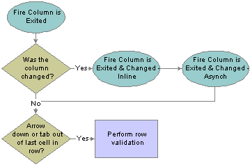

Finally, runtime signals as the user works through the grid, starting when the grid gets focus and ending when the grid loses focus.

This flowchart illustrates the initialization process for a grid control:
Grid control initialization

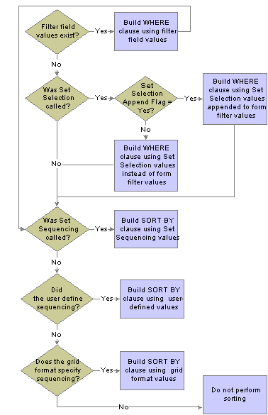

This flowchart illustrates how the system creates the SQL statement:
Grid control SQL processing

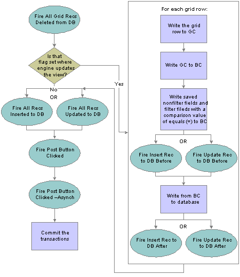

This three-part flowchart illustrates how runtime processes the act of writing data from the grid and committing the change to the database:
Grid control database commit, part 1 of 3
Grid control database commit, part 2 of 3
Grid control database commit, part 3 of 3

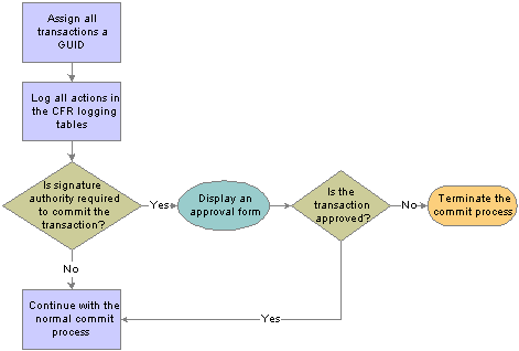

This flowchart illustrates 21 CFR 11 validation:
Grid control 21 CFR validation

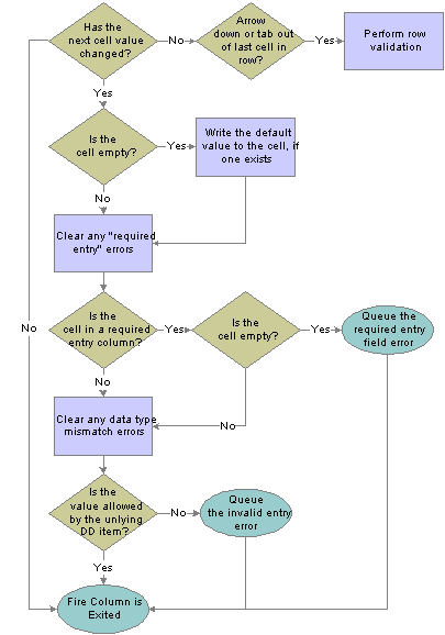

This two-part flowchart illustrates grid data validation:
Grid control data validation, part 1 of 2
Grid control data validation, part 2 of 2

Click to jump to top of pageClick to jump to parent topicSet Selection
Description
Use this system function to create the WHERE clause of a SQL search statement for use in a succeeding fetch.
Parameters
Grid
Input, required. The grid FC to affect.
Table
Input, required. The source from which to acquire comparison data. Set the parameter to an alphanumeric constant (<Literal>), <Null>, or an applicable object from the object list.
Alias
Input, required. The column of the table from which to acquire comparison data. Set the parameter to an alphanumeric constant (<Literal>), <Null>, or an applicable object from the object list.
Comparison Type
Input, required. The comparison operator to use. Set the parameter to the comparison operator to use (<Equal To>, <Not Equal To>, and so forth).
Comparison Value
Input, required. The comparison value to use. Set the parameter to an alphanumeric constant (<Literal>), <Blank>, <Zero>, or applicable object from the object list.
And/Or
Input, required. Indicates whether to append another WHERE clause to the SQL statement and how the new statement relates to the one before it (AND or OR). Set the parameter to <And>, <Or> or <None>.
Additional Notes
In general, this system function should not be used in cases where the user can affect the select. For example, QBE and filter fields are ways the user can affect the select. If the user can affect the select, then the user's select information should always be taken into consideration. This system function can be used in conjunction with Set Selection Append Flag to either append or replace the QBE or filter selection with the system function selection.
See Also
Clear Selection
Set Lower Limit
Set Sequencing
Click to jump to top of pageClick to jump to parent topicSet Selection Group
Description
The Set Selection Group system function enables you to group together fetching criteria; this is the only characteristic of this system function that makes it different from the Set Selection system function. If you are not familiar with the Set Selection system function, please review the Grid Control System Functions section in the Form Design Aid guide.
The following three examples describe how Set Selection and Set Selection Group perform, and illustrate the differences in their functionality.
The result is that all employee records with the name ABC and all customer records are fetched.
Example
Example 1 – Set Selection
A form has a filter field called Alpha Name (ALPH), which is associated with the Alpha Name column in the F0101 table. In addition, there are two Set Selection system functions under the Find Button Clicked event. These two system functions are as follows:
AT1 is the Search Type column in table F0101. Value ‘E’ is for Employee and value ‘C’ is for Customer.
When a user enters ABC in the filter field and then clicks the Find button, the following conceptual WHERE clause is created:
WHERE ALPH=ABC AND AT1=E OR AT1=C
Example 2 – Set Selection Group
A form has a filter field called Alpha Name (ALPH), which is associated with the Alpha Name column in the F0101 table. In addition, there are two Set Selection Group system functions under the Find Button Clicked event. These two system functions are as follows:
AT1 is the Search Type column in the F0101 table. Value ‘E’ is for Employee and value ‘C’ is for Customer.
WHERE ALPH=ABC AND (AT1=E OR AT1=C)
The result is that all employee and all customer records with the name ABC are fetched.
Example 3 – Set Selection and Set Selection Group
A form has a filter field called Alpha Name (ALPH), which is associated with the Alpha Name column in the F0101 table. In addition, there are two Set Selection system functions and two Set Selection Group system functions under the Find Button Clicked event. These four system functions are as follows:
AN8 is the Address Number column in the F0101 table; AT1 is the Search Type column in the F0101 table. Value ‘E’ is for Employee and value ‘C’ is for Customer.
WHERE ALPH=ABC AND AN8>100 AND AN8<200 AND (AT1=E OR AT1=C)
The result is that all employee and all customer records with the name ABC and address number in the range of 100 to 200 are fetched.
Although shown in this example, the usage of mixed Set Selection and Set Selection Group is not a good practice. The purpose of this example is to show the runtime behavior - Set Selection Group system functions are grouped and appended to the WHERE clause at the end.
Click to jump to top of pageClick to jump to parent topicSet Selection Append Flag
Description
When building a SQL statement programmatically, use this system function to indicate whether the returned value should replace the existing data or be appended to it.
Parameters
Grid
Append?
Input, required. Indicates whether to append or replace. Set the parameter to append (<Yes>) or replace (<No>).
See Also
Set Selection
Click to jump to top of pageClick to jump to parent topicSet Sequencing
Description
Use this system function to create the ORDER BY clause of a SQL search statement for use in a succeeding fetch.
Note. Use of this system function implies that grid formats that include sequencing will not be used in the SQL.
Parameters
Grid
Table
Alias
Sort Order
Input, required. Whether to sort in ascending or descending order. Set the parameter to <Ascending> or <Descending>.
Additional Notes
See Also
Clear Sequencing
Clear Sequencing
Set Selection
