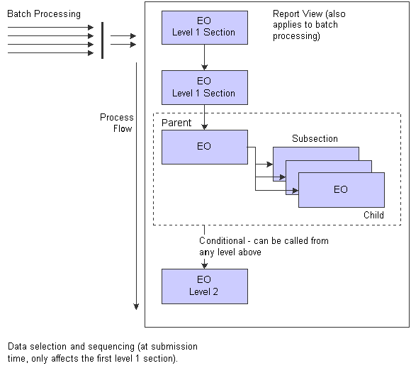

Batch engine processing flow
Processing Sequence
The sequence in which the level-one sections of the report appear in the RDA workspace determines the process flow of the level-one sections. For example, if a report has multiple level-one sections and each has its own business view, then the first level-one section executes before the next level-one section executes. Any level-two sections that exist between the level-one sections are processed when and if they are called from a level-one section. If the report includes a subsection join following the level-one sections, which creates a parent/child relationship, then the parent/child sections are processed independently of the first level-two section.
If level-one sections are moved within the report template, the execution sequence is affected. In report processing, the system processes all level-one sections in the order in which they appear. Level-two sections, however, are processed as dependents of level-one sections. Moving conditional sections, subsections, level break sections, page headers, page footers, and report headers does not affect the sequence of execution. Report execution takes place from top-to-bottom for sections; and from top-to-bottom and left-to-right for objects within a section.
The system reads and processes all records in a section from beginning to end based on the defined data selection. If you do not specify data selection, then the system reads all of the records in the table until it reaches the end of the file.
Note. Data sequencing and data selection defined at runtime affects only the first level-one section of the report or batch process.
Therefore, when you design a report or batch process, consider how users will be affected since they cannot easily change
data selection and sequencing for additional level-one sections.
A level-one section is executed at least once whether or not it has a business view attached to it. Consider this fact in
your decision to execute special event rule logic using the Do Section event of that section.
Subsection Joins
The parent/child relationship shown in the previous graphic illustrates the flow of joined sections. Parent/child sections can be called at any point within the process flow. Depending on how the parent and child sections are joined (one-to-one, one-to-many, or many-to-many), records are fetched first from the parent business view and then from the child business view for each corresponding parent record. When all parent records have processed, the system continues to the next section. If any database updates are performed in one of the first level-one sections, that change is reflected in the records fetched for the parent/child sections.
If the report contains a subsection join following a level-one section, then the parent/child section is processed independently of the first section.

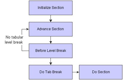

Group and Columnar Section Event Flow
The system processes group and columnar sections alike because they both write to the output after each record is read. This processing is unlike tabular section processing, which writes to the output only when a level break is encountered. The output is determined by the data selection and data sequencing defined in the section.
This diagram illustrates the typical event flow for group and columnar sections:
Event flow for group and columnar sections

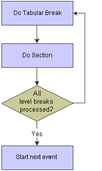

Tabular sections are comprised of columns, rows, and cells. You can use calculations to define the information contained in each column, row, or cell. You can use column inclusion event rules to define the information to be contained in each column.
You can include a set of criteria, a business function, or a named event rule in column inclusion event rules. One advantage of tabular sections is that you do not have to define additional sections for level break logic or processing, as you do with group and columnar sections. However, totaling and Row Description columns in tabular sections are dependent on the level breaks that you define. Pay close attention when defining data sequencing and level breaks in tabular sections.
This diagram illustrates the typical event flow for tabular sections:
Event flow for tabular section
Tabular sections summarize information and write to the output only when a level break is encountered. Level breaks are dependent on data sequencing and can be modified to make records as detailed or as general as the business need requires. The more fields that you define as level break fields, the more detailed the report. For example, you create a tabular section report to present open purchase orders. You sequence the data on Address Number, Document Number, and 2nd Item Number. You define all three fields as level break fields. The report displays the amount open for each 2nd Item Number for each document for each supplier. If you modify the data sequencing to include only Address Number and Document Number, and define only Document Number as a level break field, the report rolls up all the information and displays the total amount open for each document number. The result is a summary of the data included in the first report.
This diagram illustrates a tabular section level:
Tabular section level
Additional features in tabular sections that affect processing include:

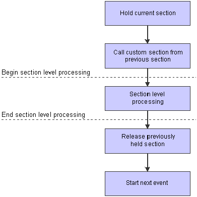

Custom Sections
Custom sections enable you to use event rules to control the information that prints on a report. Using custom sections, you can force a page break by creating a section with no objects and then activating Page Break After Print in the Section Properties. You can also use custom sections to print variable text and to present the same information but in different formats. An example would be a report that exists in two different modules but, depending on the user, calls a different section to present information specific to a particular module.
This diagram illustrates the process flow for custom sections called from event rules:
Process flow of a custom section called from event rules
When you run a report that includes a custom section, the batch engine calls and processes each section until it encounters the system function call to the custom section. The batch engine then processes the custom section. When the batch engine finishes processing the custom section, it continues processing the previous section.
You can call custom sections from any event except:
Initialize Section
Initialize Column
Report Level Events
Do Initialize Printer
Initialize Report
End Report
If you try to call a custom section from one of the exception events, the report writes a warning to the log, ignores the call to the custom section, and continues with the main section.
The custom section processes in the same manner as the type of section that it is (columnar, group, or tabular).

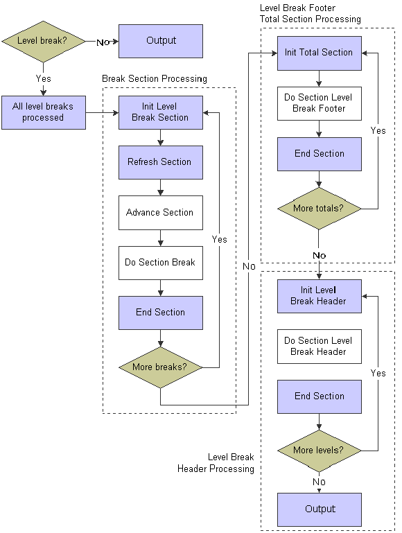

Level Break Processing
The system identifies a change in the data of a specific field by comparing the current record to the previous record. A level break occurs when the system identifies the change between the records for the fields that you define as level break fields.
You can use level breaks to organize the data of a large report into smaller, logical groups of data that are easier to review. Typically, the system displays a descriptive header before the associated data. For example, you can group address book records by search type. All records with the search type of E are grouped together with an appropriate heading. When the value in the search type field changes, a level break occurs and a new grouping begins.
Level breaks can be set up to initiate page breaks, totals, headers, and footers. Only business view fields can be defined as level break fields.
A single business view field can be attached to one level break header and one level break footer in a report template. If more than one level break header or level break footer is attached to a business view field, the batch engine processes only the first level break header or level break footer section and ignores the others.
This diagram illustrates level break logic processing:
Level break logic processing
Before a level break section is processed, the batch engine issues the Init Break Section event. This event stops processing for the current section and begins processing the level break footer section. After the level break footer section is processed, the batch engine processes the level break header if one is defined.
When a report containing level break sections is processed, the system automatically calls the Init Lvl Brk Footer Section event or the Init Lvl Brk Header Section event. You can attach event rules to these events to control the flow of logic processed by the batch engine.
For example, if you want to create a report that summarizes information by company, you can create a level break footer to organize the data by company. You can define Company as a level break field and, when the company value changes, the batch engine will call the level break footer for the detail section.
You can also call business functions, define table input/outputs (table I/O), and include other logic in level break section events.
Init Lvl Brk Footer Section Event
A level break occurs when a new value for the level break field is encountered. Therefore, the new level break value is held in memory at the time that the level break occurs. When the batch system calls the Init Lvl Brk Footer Section event, the values for the previous level are accessed and either summarized or totaled. For example, if you have a level break footer defined to total revenue by company, the level break footer inserts the total following all the associated records that have been processed for a specific company. The Init Lvl Brk Footer Section event is attached to the level break footer section.
If you set up multiple level break footers for a report section, the batch system processes the footers from the lowest level to the highest level. For example, if you define two level break footers, one on business unit and one on company, the system processes the aggregates for business unit first and then the aggregates for the associated company.
When attaching logic to a level break footer, attach it to the End Lvl Brk Footer Section event rather than to the End Section event.
Init Lvl Brk Header Section Event
The Init Lvl Brk Header Section event is called after a level finishes processing and the system has encountered a new value for the level break field. It is also called after the Init Lvl Brk Footer Section event if you have a level break footer defined. The Init Lvl Brk Header Section event locates the header section associated with the previous level and processes the information in the level break header.
For example, if you define a level break header and a level break footer in a report, the system processes the level break footer before the level break header, as shown in the previous Level break logic processing diagram.
If you set up multiple level break headers for a report section, the batch system processes the headers from the highest level in the report to the lowest level in the report. For example, if you define two level break headers, one on business unit and one on company, the company level break header processes first, and then the business unit level break header processes.
End Lvl Brk Header and Footer Section Events
After the initialize level break events are processed, the system processes the End Lvl Brk Header Section and End Lvl Brk Footer Section events. These events end the level break process and return to the detail section. You can attach logic to the End Lvl Brk Section event to call a custom section. For example, you might want to print text, such as a disclaimer, after a level break footer. In this case, you can create a custom section that contains the information you want to print and attach the custom section logic to the End Lvl Brk Section event. When you process the report, the disclaimer appears following the level break footer section.
