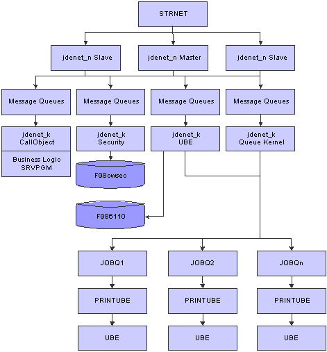

This flowchart illustrates the actions that the host server processes perform:
iSeries Process Flow
All communications between the client and the host server occur using sockets. The communications between JDENET_N (network processes) and JDENET_K (kernel processes) occur with shared memory.
The process flow is:
The STRNET command runs the master NETWORK (JDENET_N) job in a newly started subsystem. The jdenet_n Master process spawns jdenet_n slave and jdenet_k processes (also called kernels) at startup or as they are needed. JD Edwards EnterpriseOne uses a number of different types of kernels to handle different types of processing, even though all of these have the same process name in the operating system (jdenet_k). The definitions for the number of processes to start and what types to start are stored in the jde.ini file.
The JDENET_N process listens to the socket (port) as specified in the jde.ini file by the keywords ServiceNameListen and ServiceNameConnect. These two keywords should be set to the same number, and this number must be the same for every client who wants to connect to the JD Edwards EnterpriseOne server. The definitions for the particular jdenet_k processes to start are also given in the jde.ini file. They are listed in the sections headed by [JDENET_KERNEL_DEFx]. Each of these entries lists the type of jdenet_k processes to start and the maximum number of JDENET_K processes of this type to start.
The number of JDENET_N slave processes to start is listed in the jde.ini file under the keyword maxNetProcesses. The purpose of these slave processes is to provide parallel processing for the job of listening to the socket and to put the associated messages on the message queues for the JDENET_K processes to finish.
JDENET_K processes (kernel processes) do the actual work on the enterprise server. When a JDENET_K process starts, it can be any type of kernel process. The JDENET_N process assigns each kernel process to a certain type.
The JDENET_K process that becomes a CallObject kernel has the job of calling business function logic on the server. Business function logic is written in C code and compiled into Service Program (SRVPGM). SRVPGM is loaded onto the JDENET_K processes and then called directly through a C function call.
The JDENET_K process that becomes a batch process kernel waits for requests to run batch processes from the client. When a request to run a batch process is submitted, these events occur:
JDENET_K (UBE kernel) adds a record to the F986110 database table with a status of W for waiting.
JDENET_K (UBE kernel) submits a job to the queue
If you are using native iSeries job queues, JDENET_K submits a job to the iSeries queue. This job calls the JD Edwards EnterpriseOne program PRINTUBE on the iSeries enterprise server.
If you are using the JD Edwards EnterpriseOne queue kernel, JDENET_K sends a message to the queue kernel, alerting it that a new job request was submitted. When the job is ready, the queue kernel executes the PRINTUBE program.
The PRINTUBE process runs the batch application, and changes the status of the record in the F986110 table to P for processing.
If the batch application runs successfully, the software changes the status of the record in the F986110 table to D for done.
If the batch application fails, JD Edwards EnterpriseOne changes the status of the record in the F986110 table to E for error.

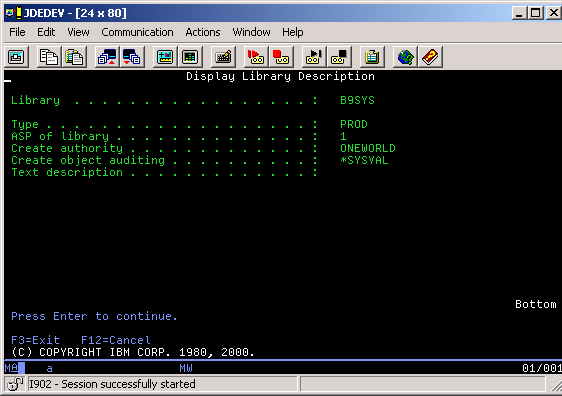

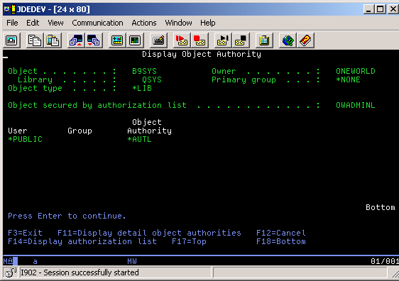

Sample Results for SETOWAUT
You can expect these examples for each of the various commands. Using Client Access, sign onto the iSeries, type each command on the command line, and press F4. For libraries (data sources and pathcodes), the required parameters are object type (*LIB) and the name of the library.
If you set up multiple instances of JD Edwards EnterpriseOne, the owner of each instance is the user profile that you entered in the JD Edwards EnterpriseOne User Profile parameter during the authority setup. If you set up a single instance of JD Edwards EnterpriseOne, the owner is ONEWORLD.
Similarly, if you set up multiple instances of JD Edwards EnterpriseOne and you display object authority, the value that appears is the name of the user profile for all objects except the SYSTEM library. The object authority for the SYSTEM library when you run multiple instances of JD Edwards EnterpriseOne is the name of the Admin. Authorization List. If you set up a single instance of JD Edwards EnterpriseOne, all objects are secured by the authorization list, except the SYSTEM library, which is secured by the OWADMINL authorization list.
This is an example of the data source DSPOBJAUT:
Data Source DSPOBJAUT
Pathcode DSPOBJAUT

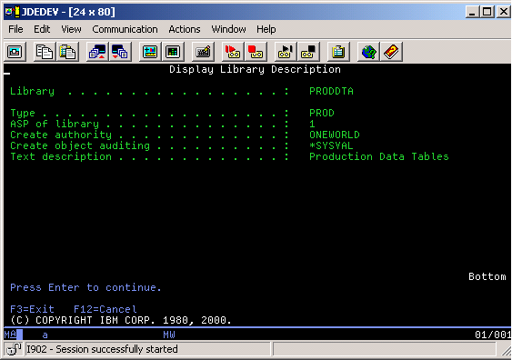

This is an example of the data source DSPLIBD:
Data source DSPLIBD
This is an example of the pathcode DISLIBD:
Pathcode DSPLIBD
Note. Authority for objects in data sources and pathcodes should remain the same after you run SETOWAUT. You can see this by displaying
the authority for an object in each library before and after you run SETOWAUT. The forms should be identical. The required
parameters are object name, object type (*FILE or *PGM), and the library name in which the object resides.
Owner, object security, and authority creation differ depending on whether you are running a single instance of JD Edwards
EnterpriseOne or multiple instances.
SETOWAUT changes the authority on system libraries. You can view this for both DSPOBJAUT and DSPLIBD on system libraries. The shaded information in these illustrations should correspond to the information that appears on the form. The required parameters are the object name, object type (*PGM), and the name of the library in which these objects reside.
This is an example of the system library DSPOBJAUT:
System library DSPOBJAUT
This is an example of the system library DSPLIBD:
System library DSPLIBD
The authority changes for objects within system libraries that either contain the attributes CLLE or CLP or that share the same name. You can use commands to review the authority on these objects. The required parameters are object name, object type (*PGM or *CMD), and the name of the library in which these objects reside.

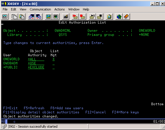

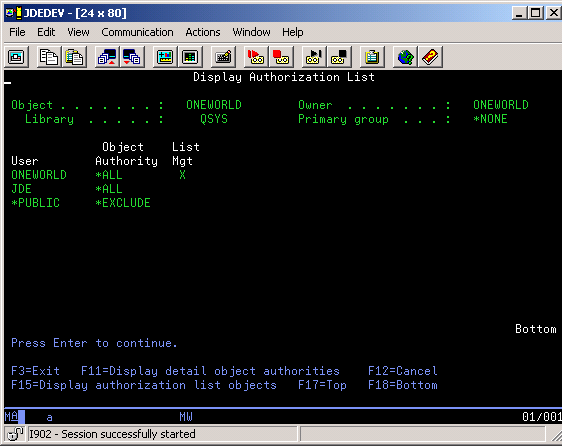

Sample Results for Authorization Lists
Use these commands to view the authorization list authorities. The name of the list is the only necessary parameter:
This is an example of DSPAUTL:
Display Authorization List
Edit Authorization List

Displaying User Profile Information
After you run SETOWAUT, you can review user profiles and authorization lists to verify that the information is correct.
On the command line, enter this command:
DSPUSRPRF
On Display User Profile (DSPUSRPRF), type the name of a user profile in the User Profile field, and then press Enter.
Information similar to this example appears:
User profile . . . . . . . . . . . . . . . : ONEWORLD Previous sign-on . . . . . . . . . . . . . : 03/23/04 15:16:53 Sign-on attempts not valid . . . . . . . . : 0 Status . . . . . . . . . . . . . . . . . . : *ENABLED Date password last changed . . . . . . . . : 02/27/03 Password expiration interval . . . . . . . : *NOMAX Set password to expired . . . . . . . . . : *NO User class . . . . . . . . . . . . . . . . : *USER Special authority . . . . . . . . . . . . : *JOBCTL Group profile . . . . . . . . . . . . . . : *NONE Owner . . . . . . . . . . . . . . . . . . : *USRPRF Group authority . . . . . . . . . . . . . : *NONE Group authority type . . . . . . . . . . . : *PRIVATE Supplemental groups . . . . . . . . . . . : *NONE Assistance level . . . . . . . . . . . . . : *SYSVAL Current library . . . . . . . . . . . . . : *CRTDFT Initial program . . . . . . . . . . . . . : *NONE Library . . . . . . . . . . . . . . . . : Initial menu . . . . . . . . . . . . . . . : *SIGNOFF Library . . . . . . . . . . . . . . . . : Limit capabilities . . . . . . . . . . . . : *NO Text . . . . . . . . . . . . . . . . . . . : Display sign-on information . . . . . . . : *SYSVAL Limit device sessions . . . . . . . . . . : *SYSVAL Keyboard buffering . . . . . . . . . . . . : *SYSVAL Storage information: Maximum storage allowed . . . . . . . . : *NOMAX Storage used . . . . . . . . . . . . . . : 286236536 Storage used on independent ASP . . . . : *NO Highest scheduling priority . . . . . . . : 3 Job description . . . . . . . . . . . . . : ONEWORLD Library . . . . . . . . . . . . . . . . : QGPL Accounting code . . . . . . . . . . . . . : Message queue . . . . . . . . . . . . . . : ONEWORLD Library . . . . . . . . . . . . . . . . : QUSRSYS Message queue delivery . . . . . . . . . . : *NOTIFY Message queue severity . . . . . . . . . . : 00 Output queue . . . . . . . . . . . . . . . : *WRKSTN Library . . . . . . . . . . . . . . . . : Printer device . . . . . . . . . . . . . . : *WRKSTN Special environment . . . . . . . . . . . : *SYSVAL Attention program . . . . . . . . . . . . : *SYSVAL Library . . . . . . . . . . . . . . . . : Sort sequence . . . . . . . . . . . . . . : *SYSVAL Library . . . . . . . . . . . . . . . . : Language identifier . . . . . . . . . . . : *SYSVAL Country identifier . . . . . . . . . . . . : *SYSVAL Coded character set identifier . . . . . . : *SYSVAL Character identifier control . . . . . . . : *SYSVAL Locale job attributes . . . . . . . . . . : *SYSVAL User profile . . . . . . . . . . . . . . . : JDE Previous sign-on . . . . . . . . . . . . . : 03/23/04 15:25:53 Sign-on attempts not valid . . . . . . . . : 0 Status . . . . . . . . . . . . . . . . . . : *ENABLED Date password last changed . . . . . . . . : 02/27/03 Password expiration interval . . . . . . . : *NOMAX Set password to expired . . . . . . . . . : *NO User class . . . . . . . . . . . . . . . . : *USER Special authority . . . . . . . . . . . . : *JOBCTL *SAVSYS Group profile . . . . . . . . . . . . . . : *NONE Owner . . . . . . . . . . . . . . . . . . : *USRPRF Group authority . . . . . . . . . . . . . : *NONE Group authority type . . . . . . . . . . . : *PRIVATE Supplemental groups . . . . . . . . . . . : *NONE Assistance level . . . . . . . . . . . . . : *SYSVAL Current library . . . . . . . . . . . . . : *CRTDFT Initial program . . . . . . . . . . . . . : J98INIT Library . . . . . . . . . . . . . . . . : JDFOBJ7R2 Initial menu . . . . . . . . . . . . . . . : *MAIN Library . . . . . . . . . . . . . . . . : *LIBL Limit capabilities . . . . . . . . . . . . : *NO Text . . . . . . . . . . . . . . . . . . . : Display sign-on information . . . . . . . : *SYSVAL Limit device sessions . . . . . . . . . . : *SYSVAL Keyboard buffering . . . . . . . . . . . . : *SYSVAL Storage information: Maximum storage allowed . . . . . . . . : *NOMAX Storage used . . . . . . . . . . . . . . : 11243168 Storage used on independent ASP . . . . : *NO Highest scheduling priority . . . . . . . : 3 Job description . . . . . . . . . . . . . : JDE Library . . . . . . . . . . . . . . . . : QGPL Accounting code . . . . . . . . . . . . . : Message queue . . . . . . . . . . . . . . : JDE Library . . . . . . . . . . . . . . . . : QUSRSYS Message queue delivery . . . . . . . . . . : *NOTIFY Message queue severity . . . . . . . . . . : 00 Output queue . . . . . . . . . . . . . . . : *DEV Library . . . . . . . . . . . . . . . . : Printer device . . . . . . . . . . . . . . : *WRKSTN Special environment . . . . . . . . . . . : *SYSVAL Attention program . . . . . . . . . . . . : *SYSVAL Library . . . . . . . . . . . . . . . . : Sort sequence . . . . . . . . . . . . . . : *SYSVAL Library . . . . . . . . . . . . . . . . : Language identifier . . . . . . . . . . . : *SYSVAL Country identifier . . . . . . . . . . . . : *SYSVAL Coded character set identifier . . . . . . : *SYSVAL Character identifier control . . . . . . . : *SYSVAL Locale job attributes . . . . . . . . . . : *SYSVAL User profile . . . . . . . . . . . . . . . : JDEOW Previous sign-on . . . . . . . . . . . . . : 03/23/04 15:28:02 Sign-on attempts not valid . . . . . . . . : 0 Status . . . . . . . . . . . . . . . . . . : *ENABLED Date password last changed . . . . . . . . : 02/27/03 Password expiration interval . . . . . . . : *NOMAX Set password to expired . . . . . . . . . : *NO User class . . . . . . . . . . . . . . . . : *USER Special authority . . . . . . . . . . . . : *NONE Group profile . . . . . . . . . . . . . . : ONEWORLD Owner . . . . . . . . . . . . . . . . . . : *GRPPRF Group authority . . . . . . . . . . . . . : *NONE Group authority type . . . . . . . . . . . : *PRIVATE Supplemental groups . . . . . . . . . . . : JDE Assistance level . . . . . . . . . . . . . : *SYSVAL Current library . . . . . . . . . . . . . : *CRTDFT Initial program . . . . . . . . . . . . . : *NONE Library . . . . . . . . . . . . . . . . : Initial menu . . . . . . . . . . . . . . . : *SIGNOFF Library . . . . . . . . . . . . . . . . : Limit capabilities . . . . . . . . . . . . : *NO Text . . . . . . . . . . . . . . . . . . . : Display sign-on information . . . . . . . : *SYSVAL Limit device sessions . . . . . . . . . . : *SYSVAL Keyboard buffering . . . . . . . . . . . . : *SYSVAL Storage information: Maximum storage allowed . . . . . . . . : *NOMAX Storage used . . . . . . . . . . . . . . : 147904 Storage used on independent ASP . . . . : *NO Highest scheduling priority . . . . . . . : 3 Job description . . . . . . . . . . . . . : QDFTJOBD Library . . . . . . . . . . . . . . . . : QGPL Accounting code . . . . . . . . . . . . . : Message queue . . . . . . . . . . . . . . : JDEOW Library . . . . . . . . . . . . . . . . : QUSRSYS Message queue delivery . . . . . . . . . . : *NOTIFY Message queue severity . . . . . . . . . . : 00 Output queue . . . . . . . . . . . . . . . : *WRKSTN Library . . . . . . . . . . . . . . . . : Printer device . . . . . . . . . . . . . . : *WRKSTN Special environment . . . . . . . . . . . : *SYSVAL Attention program . . . . . . . . . . . . : *SYSVAL Library . . . . . . . . . . . . . . . . : Sort sequence . . . . . . . . . . . . . . : *SYSVAL Library . . . . . . . . . . . . . . . . : Language identifier . . . . . . . . . . . : *SYSVAL Country identifier . . . . . . . . . . . . : *SYSVAL Coded character set identifier . . . . . . : *SYSVAL Character identifier control . . . . . . . : *SYSVAL Locale job attributes . . . . . . . . . . : *SYSVAL User profile . . . . . . . . . . . . . . . : OWDBADMIN Previous sign-on . . . . . . . . . . . . . : 03/23/04 15:30:12 Sign-on attempts not valid . . . . . . . . : 0 Status . . . . . . . . . . . . . . . . . . : *ENABLED Date password last changed . . . . . . . . : 02/27/03 Password expiration interval . . . . . . . : *NOMAX Set password to expired . . . . . . . . . : *NO User class . . . . . . . . . . . . . . . . : *PGMR Special authority . . . . . . . . . . . . : *NONE Group profile . . . . . . . . . . . . . . : ONEWORLD Owner . . . . . . . . . . . . . . . . . . : *GRPPRF Group authority . . . . . . . . . . . . . : *NONE Group authority type . . . . . . . . . . . : *PRIVATE Supplemental groups . . . . . . . . . . . : JDE Assistance level . . . . . . . . . . . . . : *SYSVAL Current library . . . . . . . . . . . . . : *CRTDFT Initial program . . . . . . . . . . . . . : *NONE Library . . . . . . . . . . . . . . . . : Initial menu . . . . . . . . . . . . . . . : MAIN Library . . . . . . . . . . . . . . . . : *LIBL Limit capabilities . . . . . . . . . . . . : *NO Text . . . . . . . . . . . . . . . . . . . : Display sign-on information . . . . . . . : *SYSVAL Limit device sessions . . . . . . . . . . : *SYSVAL Keyboard buffering . . . . . . . . . . . . : *SYSVAL Storage information: Maximum storage allowed . . . . . . . . : *NOMAX Storage used . . . . . . . . . . . . . . : 0 Storage used on independent ASP . . . . : *NO Highest scheduling priority . . . . . . . : 3 Job description . . . . . . . . . . . . . : QDFTJOBD Library . . . . . . . . . . . . . . . . : QGPL Accounting code . . . . . . . . . . . . . : Message queue . . . . . . . . . . . . . . : JDEOW Library . . . . . . . . . . . . . . . . : QUSRSYS Message queue delivery . . . . . . . . . . : *NOTIFY Message queue severity . . . . . . . . . . : 00 Output queue . . . . . . . . . . . . . . . : *WRKSTN Library . . . . . . . . . . . . . . . . : Printer device . . . . . . . . . . . . . . : *WRKSTN Special environment . . . . . . . . . . . : *SYSVAL Attention program . . . . . . . . . . . . : *SYSVAL Library . . . . . . . . . . . . . . . . : Sort sequence . . . . . . . . . . . . . . : *SYSVAL Library . . . . . . . . . . . . . . . . : Language identifier . . . . . . . . . . . : *SYSVAL Country identifier . . . . . . . . . . . . : *SYSVAL Coded character set identifier . . . . . . : *SYSVAL Character identifier control . . . . . . . : *SYSVAL Locale job attributes . . . . . . . . . . : *SYSVAL
