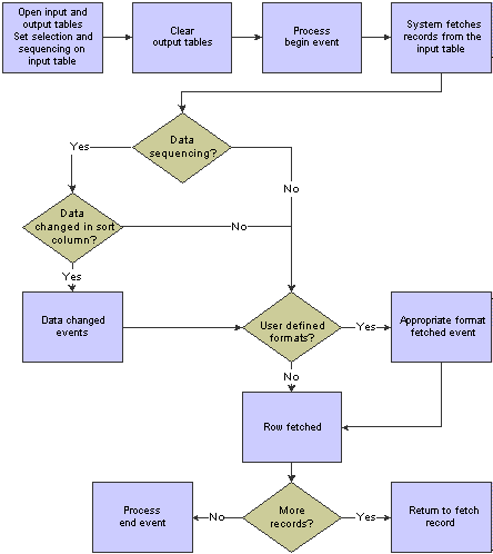

Understanding the Table Conversion Process FlowWhen you process a table conversion, the system triggers events that are similar to the events that are triggered when a report or application is run. These events are specific to the table conversion that you defined. Events provide pauses in the processing of the table conversion where you can attach logic.
In general, the event flow is the same for all table conversion types because these conversion types are all subsets of a data conversion:

Depending on the type of conversion that you define, some events might not be triggered. This diagram illustrates all events that can be triggered in a table conversion; events are indicated by yes or no decisions:
Table conversion event flow.
This table describes when each event occurs during the table conversion process:
Event |
Description |
Before fetching records from the input table, the system invokes the Process Begin event. At this point, you can attach logic that needs to run only once at the beginning of a table conversion, or attach any value that does not change for each record. This event is useful for mapping output fields that do not change for each record. |
When you use data sequencing, the system invokes a Data Changed event for any sequenced field that changes. Data Changed events are not cascaded or hierarchical. For example, you can attach an event rule to this event to total a field or group of values. |
When you use user-defined formats (also known as flat files) in the input table, the system invokes a Format Fetched event for each record that is fetched from the input table. If you use multiple user-defined formats in a table conversion, the Format Fetched event is called for the particular format that is found in the record. |
An input table invokes a Row Fetched event after each row is fetched from the input table. |
After the processing of all records is complete, the system invokes the Process End event. Attach event rules to the Process End event when you want the system to process logic after all input records have been read; for example, to write a total record to an output table or to write a record to a log file to record the status of the table conversion. |

Defining Batch Deletion ActionsAccess the JD Edwards EnterpriseOne Table Conversion Director.
Select Batch Delete, and click Next.
On the External Data form, select a processing option template, define a data structure, as appropriate, and click Next.
On the Select Environments form, select a source environment, and click Next.
On the Select Input form, drag the appropriate table to the Description column, and click Next.
To delete an input table, select it and press Delete.
Note. If you change the table, the system warns you that deleting tables removes all mappings from the table conversion.
On the Table Options form, select Run Currency Triggers, if appropriate, and click Next.
Select this option if a JD Edwards EnterpriseOne table included in the table conversion contains currency triggers. If a table contains currency fields and you do not select this option, the system cannot determine where the decimal should be placed within a field. If you do not select the currency trigger option and the source or destination fields are currency fields used in a calculation, you might receive unexpected results.
Do not select Run Currency Triggers if the input and output data sources are the same type (for example, Oracle, iSeries, or SQL Server) and no calculations are being performed. Selecting this option results in slower processing.
You should not use currency triggers for an environment that has a path code that is different from the sign-in environment.
On the Data Selection form, define data selection as appropriate.
Select the Row Fetched event when deleting rows; otherwise, no records are deleted.
When you run the table conversion, the system fetches the rows one at a time, runs the conversion for each row, and deletes the record from the input.
Click Advanced ER to insert additional event rule logic.
Verify that the Delete All Selected Records option is selected, and click Next.
This option inserts the Delete Current Input Row system function into event rules.
On the Logging Options form, select logging options, as appropriate, and click Next.
On the Finish form, select a version option, and click Finish.

Understanding Event Rules in Table ConversionsYou can use event rules to build complex functional logic into table conversions. For example, you can use event rules to insert information into a table or delete rows in a table based on specific conditions.
You attach event rules to an event, such as:
Process Begin
Row Fetched
Format Fetched
Process End
Event rules in table conversions include system functions that are specific to JD Edwards EnterpriseOne Table Conversion Design Aid.
