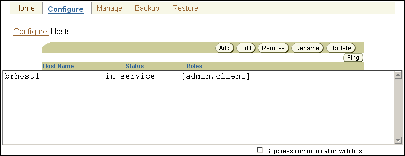

Figure 5-1 Oracle Secure Backup Web Tool: Hosts Page
To add a host to an administrative domain:
From the Home page, click the Configure tab.
Click Hosts in the Basic section to display the Hosts page.
Click Add to add a host.
The Oracle Secure Backup Web tool displays a form for entering configuration information about the host.

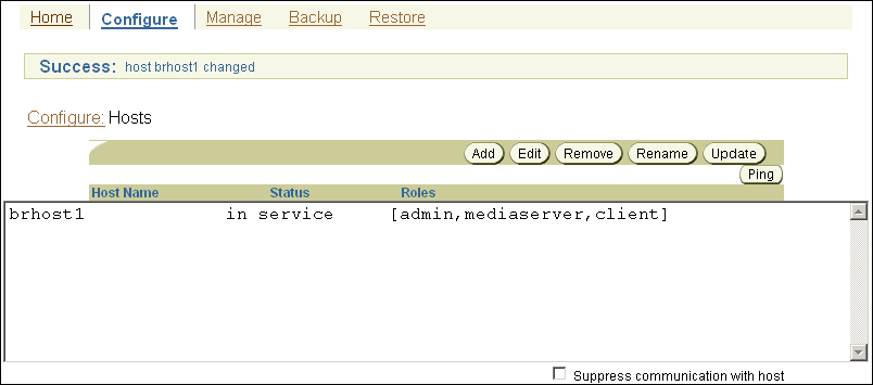

Follow these steps to add the media server role to an administrative server using the Oracle Secure Backup Web tool:
On the Configure page of the Oracle Secure Backup Web tool, click Hosts.
The Configure: Hosts page appears.
Select the administrative server and click Edit.
The Configure: Hosts > host_name page appears.
In the Roles list, shift-click to add the media server role and then click OK.
The Configure: Hosts page reappears with the media server role added to the administrative server host.

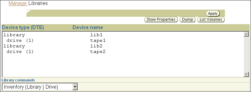

To update a tape library or tape drive inventory using the Oracle Secure Backup Web tool:
From the Oracle Secure Backup Web tool Home page, click Manage.
The Manage page appears.
In the Devices section, click Libraries.
The Manage: Libraries page appears.
Select the tape drive or tape library you want to inventory in the Devices table.
Select Inventory (Library | Drive) in the Library commands list.
In this example, lib1 is selected.
Click Apply.
Ensure that the Library list is set to the device you want to inventory.
Select the Force option.
Instead of reading from its cache, the tape library updates the inventory by physically scanning all tape library elements.
Click OK.
When the inventory is complete, the Manage: Libraries page reappears and displays a success message.
To see the results of the inventory, select the tape drive or tape library again and click List Volumes.
The Devices page, illustrated in Figure 5-2, lists each tape library and tape drive that is currently in the administrative domain. The page lists the type, status, and name of every tape device.

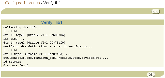

Oracle Secure Backup provides a method for checking for misconfigured tape and library devices:
From the Oracle Secure Backup Web tool home page, click Configure.
The Configure page appears
In the Basic section click Devices.
The Configure Devices page appears.
Select the drive whose configuration you want to check and click Verify.
The Configure: Libraries > Verify device_name page appears.
In this example, library lib1 is verified. No errors are found.

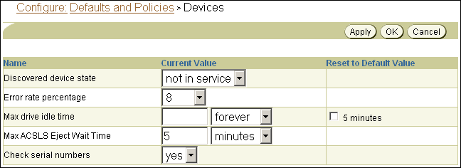

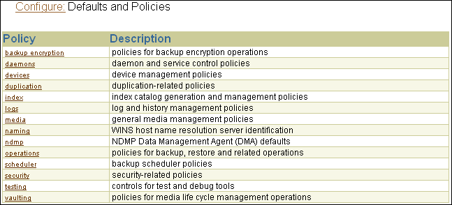

From the Oracle Secure Backup Web tool Home page, click Configure.
The Configure page appears.
In the Advanced section, click Defaults and Policies.
The Configure: Defaults and Policies page appears.
In the Policy column, click devices.
The Configure: Defaults and Policies > Devices page appears.
Do one of the following:
Select Yes from the Check serial numbers list to enable tape device serial number checking. This is the default setting.
Select No from the Check serial numbers list to disable tape device serial number checking.
Click OK.
The Configure: Defaults and Policies page appears with a success message.
