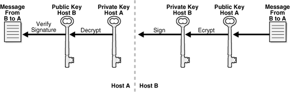

6.4.1 Identity Certificates and Public Key Cryptography
An identity certificate has both a body and a digital signature. The contents of a certificate include the following:
  • A public key
  • The identity of the host
  • What the host is authorized to do
Every host in the domain, including the administrative server, has a private key known only to that host that is stored with the host's identity certificate. This private key corresponds to a public key that is made available to other hosts in the administrative domain.
Any host in the domain can use a public key to send an encrypted message to another host. But only the host with the corresponding private key can decrypt the message. A host can use its private key to attach a digital signature to the message. The host creates a digital signature by submitting the message as input to a cryptographic hash function and then encrypting the output hash with a private key.
The receiving host authenticates the digital signature by decrypting it with the sending host's public key. Afterwards, the receiving host decrypts the encrypted message with its private key, inputs the decrypted message to the same hash function used to create the signature, and then compares the output hash to the decrypted signature. If the two hashes match, then the message has not been tampered with.
Figure 6-3 illustrates how host B can encrypt and sign a message to host A, which can in turn decrypt the message and verify the signature.
Figure 6-3 Using Public and Private Keys to Encrypt and Sign Messages
Description of Figure 6-3 follows
Description of "Figure 6-3 Using Public and Private Keys to Encrypt and Sign Messages"

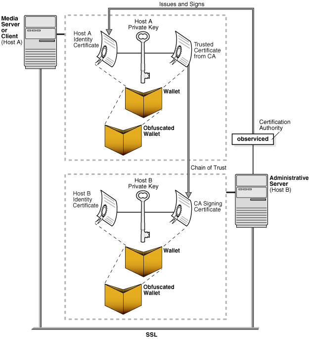

6.4.4 Oracle Wallet
Oracle Secure Backup stores every certificate in an Oracle wallet. The wallet is represented on the operating system as a password-protected, encrypted file. Each host in the administrative domain has its own wallet in which it stores its identity certificate, private key, and at least one trusted certificate. Oracle Secure Backup does not share its wallets with other Oracle products.
Besides maintaining its password-protected wallet, each host in the domain maintains an obfuscated wallet. This version of the wallet does not require a password. The obfuscated wallet, which is scrambled but not encrypted, enables the Oracle Secure Backup software to run without requiring a password during system startup.
To reduce risk of unauthorized access to obfuscated wallets, Oracle Secure Backup does not back them up. The obfuscated version of a wallet is named cwallet.sso. By default, the wallet is located in /usr/etc/ob/wallet on Linux and UNIX and C:\Program Files\Oracle\Backup\db\wallet on Windows.
The password for the password-protected wallet is generated by Oracle Secure Backup and not made available to the user. The password-protected wallet is not usually used after the security credentials for the host have been established, because the Oracle Secure Backup daemons use the obfuscated wallet.
Figure 6-4 illustrates the relationship between the certificate authority and other hosts in the domain.
Figure 6-4 Oracle Wallets
Description of Figure 6-4 follows
Description of "Figure 6-4 Oracle Wallets"

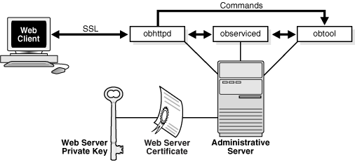

6.4.5 Web Server Authentication
The Apache Web server for the administrative domain runs on the administrative server as the obhttpd daemon. When you issue commands through the Oracle Secure Backup Web tool, obhttpd repackages them as obtool commands and passes them to an instance of obtool running on the administrative server.
The Web server requires a signed X.509 certificate and associated public key/private key pair to establish an Secure Sockets Layer (SSL) connection with a client Web browser. The X.509 certificate for the Web server is self-signed by the installob program when you install Oracle Secure Backup on the administrative server. Figure 6-5 shows the interaction between Web server and client.
Figure 6-5 Web Server Authentication
Description of Figure 6-5 follows
Description of "Figure 6-5 Web Server Authentication"
The Web server X.509 certificate and keys are not stored in the wallet used for host authentication in the Oracle Secure Backup administrative domain, but are stored in files in the /apache/conf subdirectory of the Oracle Secure Backup home. A single password protects the certificates and keys. This password is stored in encrypted form in the daemons file located in /admin/config/default. When the Web server starts, it obtains the password by using a mechanism specified in the Web server configuration file. This password is never transmitted over the network.

6.6 Default Security Configuration
When you install Oracle Secure Backup on the administrative server, the installation program configures the administrative server as the Certification Authority (CA) automatically. By default, security for an administrative domain is configured as follows:
When you add hosts to the administrative domain, Oracle Secure Backup creates the wallet, keys, and certificates for each host when you create the hosts in obtool or the Oracle Secure Backup Web tool. No additional intervention or configuration is required.
You can also change the default configuration in any of the following ways:
  • Disable SSL for inter-host authentication and communication by setting the securecomms security policy
  • Transmit identity certificates in manual certificate provisioning mode
  • Set the key size for a host to a value greater or less than the default of 1024 bits
  • Enable encryption for backup data in transit by setting the encryptdataintransit security policy
6.7 Configuring Security for the Administrative Domain
This section describes how to configure security for the administrative domain.
This section contains these topics:
6.7.1 Providing Certificates for Hosts in the Administrative Domain
Providing a certificate for each host in the Oracle Secure Backup administrative domain requires that you first configure the administrative server and then configure each media server and client.
6.7.1.1 Configuring the Administrative Server
If you install Oracle Secure Backup on a host and specify this host as the administrative server, then this server is the Certification Authority (CA) for the Oracle Secure Backup administrative domain. Oracle Secure Backup configures the host as the CA automatically as part of the standard installation. You are not required to take additional steps to provide a signing certificate for this server.
Oracle Secure Backup automatically creates the following items:
  • A host object corresponding to the administrative server in the object repository on the administrative server.
  • A wallet to contain the administrative server's certificates. The wallet resides in the directory tree of the Oracle Secure Backup home. Oracle Secure Backup uses the host ID as the wallet password.
  • A request for a signing certificate in the wallet.
  • A signed certificate in response to the request and stores the certificate in the wallet.
  • A request for an identity certificate in the wallet.
  • A signed certificate in response to the request and stores it in the wallet.
  • An obfuscated wallet in the local wallet directory.
The administrative server now has the signing certificate, which it must have to sign the identity certificates for other hosts, and its identity certificate, which it must have to establish authenticated Secure Sockets Layer (SSL) connections with other hosts in the domain.
