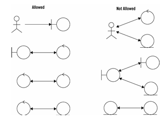

Figure A-2 illustrates the rules of robustness analysis.
Figure A-2 Rules of Robustness Analysis
The rules are as follows:
You can have one or more actors, boundary objects, controllers, and entity objects in a use case.
Actors can only talk to boundary objects.
Boundary objects can only talk to controllers and actors.
Entity objects can only talk to controllers.
Controllers can talk to boundary and entity objects, other controllers, but not to actors.
