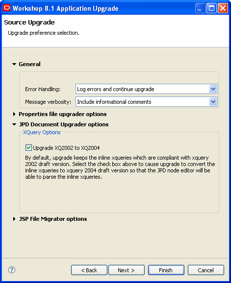

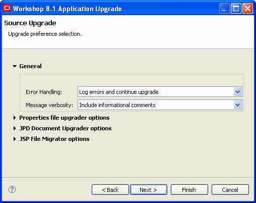

When you upgrade a WLI 8.x project to 10g Release 3 (10.1.3), by default, inline XQuery 2002 code (embedded in JPD files) is not converted to XQuery 2004. You can convert the inline XQuery code to XQuery 2004, by performing the following steps in the Source Upgrade screen of the upgrade wizard.
When the upgrade process is completed, XQuery 2002-compliant code that is embedded in JPD files (inline XQuery code) is converted to XQuery 2004.
