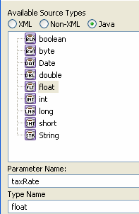

The available Java Types are displayed in the Available Source Types pane.
taxRate
as the Parameter Name.In this task, you select a target type for the transformation in the Target Types dialog box of New XQuery Transformation.
