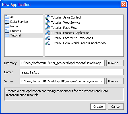

  1. In WebLogic Workshop 8.x select the File > New > Application... menu option. The New Application dialog box is displayed.
  2. In the left pane select Tutorial and in the right pane, select Tutorial: Process Application.
  3. In the Name: field, type the name sampleApp. The New Application dialog box is displayed as shown in Figure 1-1.
  4. Figure 1-1 Creating a New Application in WebLogic Platform 8.x
  5. Click Create.

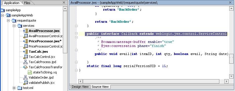

  6. In the Application pane of WebLogic Workshop, navigate to view the sampleApp > sampleAppWeb > requestquote > services > AvailProcessor.jws web service file.
  7. Double-click the file to view its Source View in the adjacent pane, as shown in Figure 1-2.
  8. Figure 1-2 Viewing the Web Service Source
  9. In the highlighted text (public interface Callback extends weblogic.jws.control.ServiceControl) of the source view, as shown in Figure 1-2, replace weblogic.jws.control.ServiceControl with com.bea.control.Control.
  10. At the beginning of the source file, replace import weblogic.jws.control.JwsContext with import com.bea.control.JwsContext.
  11. Note: The weblogic.jws.control.ServiceControl and the weblogic.jws.control.JwsContext are deprecated. You must replace these APIs in all the web services for an error-free upgrade to WLI 10g Release 3 (10.3.1).

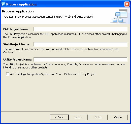

  1. In WebLogic Workshop 9.x or WLI 10.x select the File > New > Project > WebLogic Integration > Process Application menu option. The Process Application dialog box is displayed as shown in Figure 1-3.
  2. Figure 1-3 Create a new Process Application
  3. Enter an EAR Project name, Web Project name and Utility Project name and click Finish to create the project.
