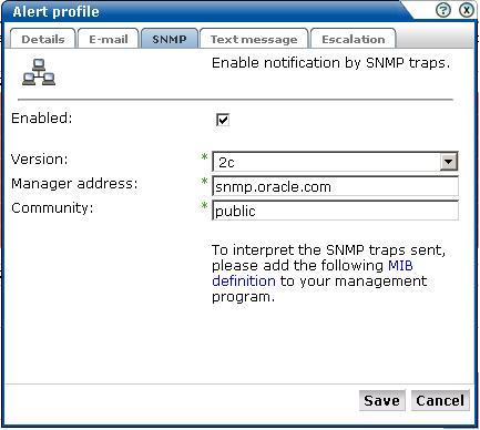

To define SNMP alert recipients, click the SNMP tab to open the SNMP dialog (shown in Figure 5-19) and do the following:
Use the Version list to specify which version of the SNMP protocol is being used. The default is version 2c.
Use the Manager address field to specify the client software address. This must be a valid network address, and can either IP address or a host name.
Use the Community field to specify the group to which information is sent. This string acts as a password to control the clients' access to the server.
Check the Enable check box to activate SNMP notification.
Download the Management Information Base (MIB) definition and incorporate it into your address book of managed objects. It contains necessary information about how the received SNMP messages should be interpreted. The structure of the MIB file is shown in Figure 5-20Foot 1 .
The available KPI information and metrics in the MIB represent the most important properties of every KPI configured within the system, and can be used as the basis for filtering and alerting. They are explained in Table 5-1.
