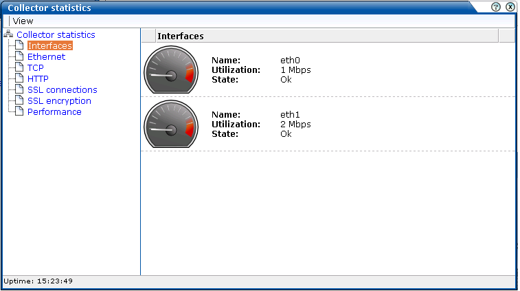

The information shown in this window (Figure 9-3) refers to the traffic monitored since midnight for the selected Collector, or the counters were reset. The Uptime field in the bottom left-hand corner of the window shows the time the Collector has been running. The uptime is reset when the Collector is restarted to update its configuration. You can reset all HTTP request counters shown in the window by selecting Reset counters from the View menu. Note that the counters will be reset the next time a network packet is detected. Hence, on an installation with no network traffic, the counters will never be reset. The display is automatically refreshed every two seconds.
The tabs available in the top-left part of the part of the window provide a detailed breakdown of the traffic monitored by the selected Collector. They are explained in Table 9-1:
Table 9-1 Collector Statistics Report Tabs
| Tab | Description |
Interfaces |
Provides information on the available network interfaces for data collection. The number of interfaces and their status depends on the system configuration. Note that you will not see any "normally" configured interfaces. For each available interface, the name (in the form ethx), utilization (that is, current bandwidth), and state are displayed. For each interface, the state can be indicated as "OK", "Down", "Not configured", "Not active", or "Not promiscous" (the network adapter is only able to see traffic sent to its MAC address). |
Ethernet |
Provides a breakdown of the raw packet data transmitted over the monitored ports in terms of its protocols (such as IPv4 and ARP), and the number of measured frames. The "Truncated" listing indicates corrupted or dropped frames. |
TCP |
Provides an analysis of the TCP stream. The following counters are reported:
The following network error meters are also shown:
HTTP |
Provides an analysis of the monitored HTTP stream. In particular, the type of requests (such as GET or POST) they contain. |
SSL connections |
Reports the encryption method used for packets of encrypted data. In particular:
Errors related to SSL key management are reported. In particular:
Information about (currently) unsupported encryption:
The Decrypt errors gauge indicates the connections which could not be decrypted. This can be caused by several reasons, such as the master key could not be decrypted, session keys were incorrectly computed, or a segment could not be decrypted. |
SSL encryption |
Provides a breakdown of the monitored encrypted data in terms of the employed encryption algorithm. The Used column indicates the amount (percentage) of total monitored SSL encrypted traffic that used an encryption algorithm, and the Errors column indicates the percentage of measured SSL encryption which failed (that is, could not be read). |
Performance |
Reports on the impact to the Collector. Note that if the peak load nears 100%, immediate action should be taken to prevent data being dropped by the Collector. See Section 8.2.2, "Limiting Overall Traffic" about traffic sampling. If this does not provide a solution, it is also recommended that you contact Customer Support. |

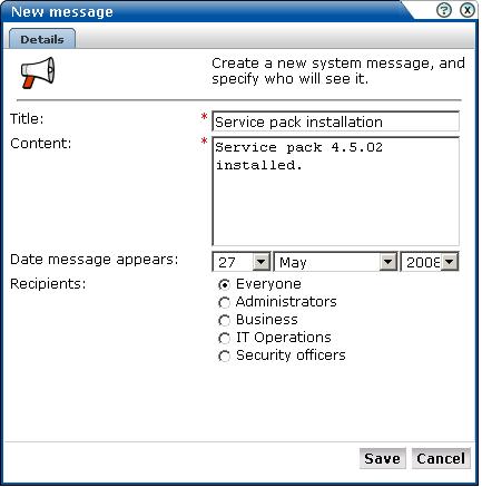

To create a system message, do the following:
Select System, then Messaging, and then New message. The dialog shown in Figure 9-7 appears:
Specify a brief descriptive title for the message.
Specify the content of the message. It is recommended that you try to keep this as brief as possible.
Use the Date fields to specify when the message should appear on users' message areas. Note the last three messages in the user's message stack are displayed. Hence, the message will remain on users' screens until either three new messages have been displayed, or you explicitly remove the message.
Use the Recipients field to specify the user roles that will receive the message. By default, messages are sent to all system users.
When ready, click Save to create the message, or Cancel to discard the message.
The message is displayed in the Messages section of the appropriate users' dashboard (see Figure 1-2).
To change an existing message (for example, to modify its text or recipients), right click the message, and select Edit from the menu. You can then modify the message's properties using the dialog shown in Figure 9-7.

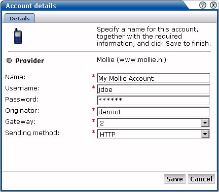

RUEI supports the use of text message notifications. In order to make use of this facility, all text message providers that you are planning to use must be configured and known to the system. To manage your provider information, select System, then Maintenance, and then Text message providers. The dialog shown in Figure 9-9 appears.
Do the following:
Click « Add new account » to define a new text message provider. The dialog shown in Figure 9-10 appears.
Figure 9-10 Select Text Message Provider Dialog
Select the required text message provider from the list. It contains a number of predefined supported services. Each of these require an account with the associated provider. When ready, click Next. A dialog similar to the one shown in Figure 9-11 appears.
Important:
If you specify a local GSM modem, a GSM modem must be installed on the system. The installed local modem must be a USB or serial GSM ETSI 07.05-compliant modem.The exact fields available within the dialog depend on the provider selected in Figure 9-10. For example, if you selected a local GSM modem, you are required to specify the local port and baud rate for the modem. If not known, automatic detection is available. Optionally, you can also specify a SIM PIN (if one is required).
If you selected the predefined Mollie or Clickatell services, you are required to specify the user name, password, originator, API ID, and protocol sending method used for the account. These should have been given to you by your account provider. When ready, click Save. You returned to the dialog box shown in Figure 9-9.
Right click the providers in the list and use the Move up and Move down options to control a provider's position in the list. Providers are tried in the order they appear in the list. Hence, the first account is tried and, on failure, the second one, and so on.
When ready, click Close to leave the dialog.

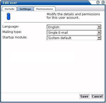

To change the settings for an existing user, do the following:
Select the required user within the user list shown in Figure 9-15. The Edit user dialog shown in Figure 9-20 appears:
Optionally, modify any of the displayed information. Note that the fields shown with a red asterisk indicate they are mandatory. That is, they can not be left blank. You can use the Disabled check box to prevent the user from using this account. You are free to enable them later. The Locked check box is normally activated automatically after a user has failed to correctly enter their password on five successive attempts. Password security is fully described in Section 9.15.4, "Enforcing Password Security Policies". You can use this check box to unlock the user's account.
Click the Settings tab to view the user settings dialog shown in Figure 9-17:
Within the Settings tab, you can modify the following:
Language: this is the language in which system messages and prompts appear. Currently, only English is available.
Mailing type: specifies whether the reports the user receives are sent in multiple e-mails (one for each report) or bundled into a single e-mail. The default is multiple e-mails.
Startup module: specifies the module in which the user starts their session. (For example, Reports, System, or User management). The default is the user's home page.
Optionally, click the Permissions tab, and use the check boxes and radio buttons to specify the permissions to be assigned to the user. These are explained in Section 1.3, "Understanding User Roles"Section 9.15.1, "Adding New Users".
When ready, click Save for the changes you have made to take effect. Otherwise, click Cancel to discard your changes.

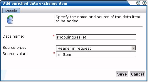

The Enriched data exchange facility enables the alternative analysis of the data collected by RUEI. In particular, it allows you to combine the data collected by RUEI with other data warehouse data. For example, a Customer Relationship Management (CRM) or Business Intelligence (BI) system. Using this facility, you can extract a rich set of collected data, such as product names, shopping basket values, and address information.
While the facility described in Section 2.11, "Exporting Report Data" is limited to report data, the enriched data exchange facility allows the export of all page-based data. In addition, report data export is based on HTTPS transfer, and enriched data exchange is based on SFTP file transfer. As described later, you can also customize the content of the exported data to include header information not normally collected by RUEI. Because the exported data is page-based, the available is restricted to applications, and does not include service-related data.
Enabling and Disabling Enriched Data Exchange
To enable Enriched data exchange, do the following:
Select Configuration, then Applications, and then Enriched data exchange. The window shown in Figure 9-23 appears.
Use the Enabled check box to enable or disable the Enriched data exchange facility. By default, it is enabled.
Optionally, you can define additional data items to be included in the exported data. Typically, these are elements in the client request or server response headers that are not normally collected by RUEI, but which you want included in the exported data. To do so, click «Add new item». The dialog shown in Figure 9-24 appears.
Figure 9-24 Add Enriched Data Export Item
Specify the name to be assigned to the data item. This become the item's element name. For example, if specify the name "product", any matched data will appear in the export file with the label <product>.
Use the Search type menu to define how the required item should be identified within the data collected by RUEI, and the scope of the search. You can specify to search within the client request header or server response header, using either a literal search or an XPath expression, or to search within a custom page-tagging implementation for a specific tag. Further information about support for custom page-tagging schemes is available in Appendix A, "Tagging Conventions".
When ready, click Save. The new data item, if found in the monitored traffic, will start to be reported in the exports within 5 to 10 minutes.
Existing data can be modified by right-clicking it, and selecting Edit. You can also select Remove to delete it, or select Remove all to delete all currently items.
