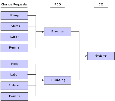

When you create hundreds of change requests, you create a change request hierarchy that has a high level of detail. Each change request in a high-detail level hierarchy is very specific. For example, you might create a change request that contains only line items for electrical wiring changes for the month of May, one that has wiring changes for June, one that has changes to fixtures for May, one with fixture changes for June, and so on. Each change request might have only a few line items, but you will need to keep track of many change requests.
This graphic shows an example of a hierarchy with a high level of detail:
Hierarchy with high level of detail

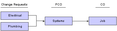

When you create fewer change requests that each have many line items, you create a low-detail level hierarchy. For example, you might create a change request for all electrical changes. That one change request might contain changes for wiring, fixtures, labor, and permits over the entire course of the job. Such a change request probably has dozens of line items, but you only need to review one change request when you are searching for information or must modify a line item.
This graphic shows an example of a hierarchy with a low level of detail:
Hierarchy with low level of detail
