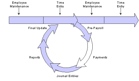

This process flow illustrates the location of the payments step in the payroll cycle:
Payroll cycle: payments
