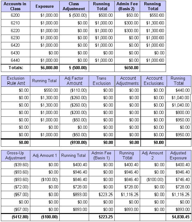

Understanding Expense Participation Calculations
To set up adjustment information on the expense participation record, you must understand how the system uses the information in the expense participation calculation. This example provides setup information and results of an expense participation calculation.
Here is the setup information for this example:
On the E.P. Class Information Revisions form, two account ranges exist for the E.P. Class CAMS:
Account range 6200–6230 with a fee rate of 0.30, a fee basis of 2, an adjustment factor of 0.80, and gross-up percent of .91.
Account range 6420–6440 with a fee rate of 0.25, a fee basis of 2, an adjustment factor of 0.95, and gross-up percent of .94.
On the E.P. Class Account Override Revisions form, the following account overrides are specified:
Account 6200 has a fee rate of 0.10.
Account 6230 is excluded from administration fees.
Account 6430 is excluded from the range.
On E.P. Class Adjustment Revisions form, the following class adjustments are specified:
Account 6200 has an adjustment amount of –500.00 USD, which is applied before the adjustment factor.
Account 6210 has an adjustment amount of –100.00 USD, which is applied before the administration fee.
Account 6210 has an adjustment amount of –100.00 USD, which is applied after the administration fee.
On the Expense Participation form, account 6440 is excluded from administration fees.
These tables show how the expense participation calculation process affects each account in the class:
Expense participation calculations
This table shows the results of the E.P. calculation example:
Expense participation calculation results

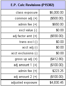

Revising Expense Participation Calculations
This section provides an overview of expense participation calculation revisions and discusses how to:
Set processing options for EP Calculation Revisions (P15382).
Revise expense participation calculations.
Review the share factor denominator.
Understanding Expense Participation Calculation RevisionsAfter you generate expense participation calculations in the E.P. Calculation Generation program (R15110), use the E.P. Calculation Revisions program (P15382) to review, revise, and recalculate the expense participation amounts. The system displays the expense participation calculations in the P15382 program in the same format as on the E.P. Calculation Register report (R1538).
This table lists the fields on the Page 1 tab in the E.P. Calculation Revisions program (P15382) and navigation information to the program and form from which the system retrieves information:

Revising Expense Participation CalculationsAccess the EP Calculation Revisions form.
Complete any of the input-capable fields on the Page 1 tab of the EP Calculation Revisions form.
Manual Rev |
Enter a value that specifies whether a billing record must be reviewed before it can be approved for posting. Values are: Blank: A review is not required. Y: A review is required. The batch retains a status of Error until the field for the billing record is changed from Y to blank. |
Sep Invoice (separate invoice) |
Enter the one-character alphanumeric code that indicates which billing records to print on the invoice. The system prints a separate invoice for each group of billing records that have the same lease number, alternate payee, and separate invoice code. |
Generation Type |
Enter the code that specifies the generation type for an expense participation billing line. |
Class Exp (class exposure) |
Enter the sum of the gross amounts for the accounts that are specified by the expense class for the expense participation billing period and that do not include exclusions (account, transaction, and tenant). |
From (MM/YYYY) |
Enter the beginning date that the system uses to retrieve expenses that are used to determine the total class exposure. |
To Ending Date |
Enter the ending date that the system uses to retrieve expenses that are used to determine the total class exposure. |
Common Adj (class common adjustment amount) |
Enter the sum of class adjustment amounts from the E.P. Class Adjustments Revisions form when the calculation placement control value is defined to place the adjustments before the adjustment factor. If you select the Common Adj link, the system accesses the Class Adjustments Audit File form which enables you to review historical class adjustment information. |
Admin Fee (administration fee) |
Enter the amount of the administration fee for the lease and expense class. |
Admin B/R Code |
Enter the code that the system uses in conjunction with the automatic accounting instruction (AAI) item to retrieve the account to update for the management fee amount that the system calculates when you run the E.P. Calculation Generation program. The system retrieves the appropriate account to bill based on the AAI item PMxxxx (for invoices) and RMxxxx (for vouchers), where xxxx is equal to the code that you enter. The system retrieves the offset account (Accounts Receivable trade or Accounts Payable trade), based on the AAI item RCxxxx (for invoices) and PCxxxx (for vouchers), where xxxx is equal to the code that you enter. If you leave this field blank, the system uses the same account that it uses for the billing amount. |
Excl. Value (exclusion value) |
Enter the amount to exclude based on either the tenant exclusion rule or the exclusion override in the expense participation information. |
Exclusion Rule |
Enter a value that identifies a tenant exclusion rule. The system does not include amounts specified by the tenant exclusion rule when it calculates the tenant's share factor. For example, a tenant exclusion rule might specify to deduct amounts associated with bill code EXPA from all tenants who lease any unit that is defined as an anchor and that has an area of more than 5,000 square feet. The system uses the tenant exclusion rule only when you assign it to the expense participation information for the lease. |
Adj Factor Amnt (class adjustment factor amount) |
Enter the sum amount of all adjustment factors as defined at the class level or at the account level. If you select the Adj Factor Amnt link, the system accesses the Adjustment Factor Audit File form, which enables you to review historical adjustment factor information. |
Trans Excl (transaction exclusions) |
Enter the amount to subtract from the class exposure. The system does not update this field; it is reserved for manual entry. |
Acct Adj (account adjustment) |
Enter the amount that the system subtracts from the class exposure based on the expense participation adjustment information. The account adjustment amount is the total amount of adjustments made to the EP Class as defined in the tenant Expense Participation billing information when the adjustment level type is set to 1 for adjustment. The amount represents either an account balance or an override adjustment amount, depending on the adjustment calculation methods. Method 5 is an amount adjustment to the account. The system adds or subtracts (depending on whether the amount specified is positive or negative) the adjustment amount from the class exposure amount. Method 6 calculates the account exclusion adjustment amount by multiplying the adjustment percentage by the account balance and then subtracting that result from the account balance. Note. If you specify a positive adjustment amount, the system adds it to the expense class (it appears as a negative amount that
is subtracted). If you specify a negative adjustment amount, the system subtracts it from the expense class (it appears as
a positive amount that the system subtracts). |
Acct Exclusions (account exclusions) |
Enter the amount that is excluded from the tenant's expense participation class based on the specific account factors defined in the tenant expense participation billing information. Select this link to access the Account Exclusions Audit File form, which enables you to review historical account exclusion information. |
Redistrib. Adj (redistribution adjustment) |
Select this link to access the Exclusion/Redistribution Adjustments Audit program (P1538B2), which enables you to review the account adjustments for leases participating in an expense. |
Gross Up Adj (gross up adjustment) |
Select this link to access the Gross Up Adjustments Audit program (P1538B1), which enables you to review the account adjustments for gross up processing. |
Adj Amount (1) (adjustment amount 1) |
Enter the amount that is added to the class exposure immediately before the system adds administration fee. Select this link to access the Class Adjustments Audit File form, which enables you to review historical class adjustment information. |
Cap Adj (C) (cap adjustment) |
Displays the amount of adjustment to exposure necessary based on a cap rule defined at the EP Class level, when the system calculates caps before the administration fee. Select this link to access the Expense Cap Detail program (P1538B3), which enables you to review cap details. |
Admin Fee |
Enter An amount that represents the administration fees associated with a tenant's expense participation. This fee is calculated by multiplying the tenant's billable amount by the fee rate. Fee Amount 2 refers specifically to the total amount of administration fee applied when Fee Basis is set to 1. |
Displays the amount of adjustment to exposure necessary based on a cap rule defined at the EP Class level, when the system calculates caps after the administration fee. Select this link to access the Expense Cap Detail program (P1538B3), which enables you to review cap details. |
Adj Amount (2) (adjustment amount 2) |
Enter the amount that the system adds to the class exposure immediately after the administration fee is added. Select this link to access the Class Adjustments Audit File form, which enables you to review historical class adjustment information. |
Total Exp (total exposure) |
Displays the calculated exposure. |
Max Limit (C) (maximum limit C) |
Enter the maximum allowable amount for the total class exposure. The system uses the value in this field for the adjusted class exposure when the calculated amount for the total class exposure is greater than this value. For example, if the total class exposure is 200,000 and the expense class limit is 175,000, the system uses 175,000 for the adjusted class exposure. |
Adj Amt (adjustment amount) |
Enter the adjustment amount. Depending on the adjustment calculation method, this value is the amount or percentage that the system uses to determine the minimum amount for the total class exposure. |
Calc (adjustment calculation) |
Enter a code from UDC 15/CE that specifies the adjustment calculation method that was entered in the corresponding field, Adj Calc,on the Expense Participation Adjustments form. |
Base |
Enter the amount from in the Adjustment Base field on the Expense Participation Adjustments form for the detail line that specifies an adjustment calculation method of C and a maximum adjustment amount. |
Yr (base year) |
Enter the value that defines the base year for the maximum amount to be charged for the class. |
Min Limit (C) (minimum limit C) |
Enter the minimum allowable amount for the total class exposure. The system uses the value in this field for the adjusted class exposure when the calculated amount for the total class exposure is less than this value. For example, if the total class exposure is 150,000 and the class limit minimum is 175,000, the system uses 175,000 for the adjusted class exposure. |
Adj Exp (adjustment exposure) |
Enter the amount from which the system subtracts any base exclusions to determine the net exposure amount. The system compares the total exposure amount to the maximum or minimum adjustment amounts to determine the value. |
