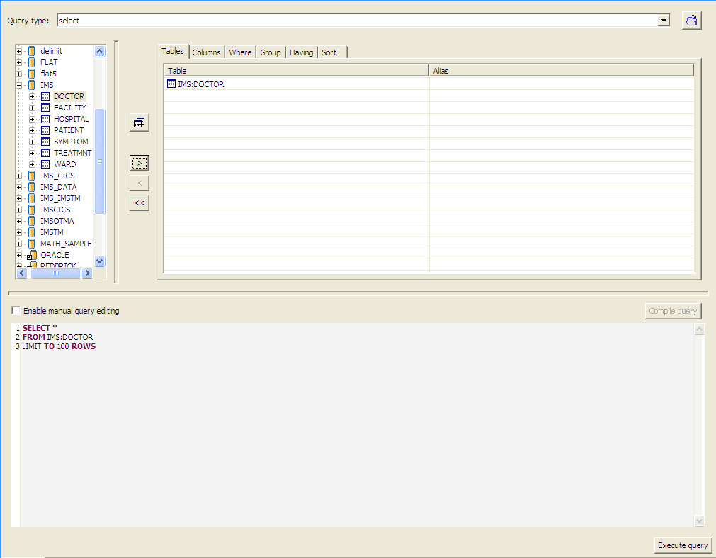

Perform the following procedure to test the IMS data source by query:
  1. Open Oracle Studio for IMS, VSAM, and Adabas Gateways.
  2. Expand the node of the required computer.
  3. Expand the node of the required binding.
  4. Expand the Data sources node.
  5. Right-click the required data source entity, and select Query Tool.
    The Select Workspace screen opens.
  6. Select Navigator and click OK.
    The Query Tool opens in the Editor pane, with the Build Query tab displayed (see Figure 7-1).
  7. Select the required query type from the Query Type list. The default is a SELECT-type query.
  8. Locate and expand the node of the required data source entity.
    The data source tables are listed.
  9. Select the required table and move it to the Table column by using the arrow button.
    Figure 7-1 The Query Tool screen
    Description of Figure 7-1 follows
    Description of "Figure 7-1 The Query Tool screen"
  10. Click Execute query.
    The Query Result tab opens, displaying the results of the query.
  11. Close the Query Tool in the Editor pane.

<IMSDB DP> >>>                 lastPCB=-1, cPCBs=1, PCBs=0
<IMSDB DP> >>>                 readahead=282, cSSAs=2
<IMSDB DP> >>>> READ HOSPITAL
<IMSDB DP> >>>>      DOCTOR
DLIPLUG Request:
09C90410 | 00000000C4D6C3E3D6D9404000010000 | ....DOCTOR  ....
09C90420 | 0000000000000000000000000000FF00 | ................
09C90430 | 0000001A000000500000000000000000 | .......&........
09C90440 | 0000000000000000000000000000011A | ................
09C90450 | 02000000000000000000000000000000 | ................
09C90460 | 000000000000001A0000000000000000 | ................
09C90470 | 00000000000000000000000000000000 | ................
09C90480 | 0000C8D6E2D7C9E3C1D3000000000000 | ..HOSPITAL......
09C90490 | 0000C4D6C3E3D6D94040000000000000 | ..DOCTOR  ......
09C904A0 | 0000                             | ..
CTDLI(2,GU  ,HOSPITAL ,DOCTOR   )
 GU  , DBD(HOSPDBD ), Segment(DOCTOR  ), SSA1(HOSPITAL ), SSA2(DOCTOR   ),
Buffer(Jane Doe            Behind the fireplace          392-600359Urology
 ), Status(  ), RC(0), KFB(Spalding
Rehabilitat2 017 )
CTDLI(2,GN  ,HOSPITAL ,DOCTOR   )
 GN  , DBD(HOSPDBD ), Segment(DOCTOR  ), SSA1(HOSPITAL ), SSA2(DOCTOR   ),
Buffer(Miki Mouse          Next to fireplace             424-337760Trauma & o
 ), Status(  ), RC(0), KFB(Swedish Medical
  1 041 )
Buffer(Yetti Bigfoot       Next to fireplace             392-693961Ear, nose
 ), Status(  ), RC(0), KFB(Presbyterian/St.
Luke1 059 )
Buffer(Blonde Genius       Next to fireplace             723-135562Ophthalmol
Luke2 060 )
Buffer(Gamma Tester        Next to fireplace             974-800964Oral surge
 ), Status(  ), RC(0), KFB(Good Samaritan
  1 061 )
Buffer(Dr. Verter          Next to fireplace             297-497895Restorativ
 ), Status(  ), RC(0), KFB(West Hills
Hospital 1 062 )
Buffer(Art                 Next to fireplace             594-056510Paediatric
 ), Status(  ), RC(0), KFB(Los Gatos
Surgical  1 064 )
Buffer(Joe Canabis         Next to fireplace             24-3377605Orthodonti
 ), Status(  ), RC(0), KFB(Los Robles
Regional 1 095 )
Buffer(Yoske Black         Next to fireplace             92-6939616Neurosurge
Regional 1 100 )
 GN  , DBD(HOSPDBD ), Segment(        ), SSA1(HOSPITAL ), SSA2(DOCTOR   ),
Buffer(
 ), Status(GB), RC(51138), KFB()
