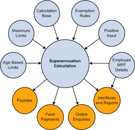

Understanding Superannuation Administration
The following diagram shows the settings you must specify to ensure correct superannuation calculation and output:
User input and system output for superannuation
