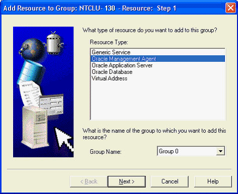

  1. From the Resources menu, click Add to Group. The Add Resource to Group Wizard opens.
    Figure 9-1 Add Resource to Group Wizard - Resource Page
    Description of Figure 9-1 follows
    Description of "Figure 9-1 Add Resource to Group Wizard - Resource Page"
  2. In the Resource Type box, select Oracle Management Agent.
  3. In the Group Name box, select the group to which you want to add Oracle Management Agent. This must be the group that contains the database you want to monitor with Oracle Management Agent.
  4. Click Next. The Management Agent Oracle Home page opens.

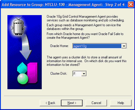

  5. In the Oracle Home box, select the Oracle home that you want to add to the group.
  6. Select the shared disk that will be used to store Management Agent context information.
  7. Click Next. The Management Agent Virtual Address page opens.

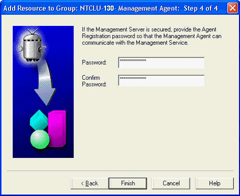

  11. Provide the password used for the Oracle Management Server.
  12. Click Finish. The Finish Adding Management Agent window opens.
  13. This window summarizes the properties you have set with the wizard. If the summary information is correct, then click OK. Otherwise, click Cancel and then click Back to find the page or pages in the wizard on which you want to change entries.
