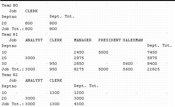

27.3 Add Labels and Lines for Summaries
To make your report more readable, it would be useful to add labels for the row and column summaries. It would also be nice to have lines above the column summaries to better distinguish them from the cell values.
To add labels:
  1. In the Paper Design view, click the Text tool in the tool palette.
  2. Click in the open space just below the first department number and to the left of the first total.
  3. Enter Job Tot.:, then click in a blank area of the Paper Design view. If you perform this step correctly, the label should now appear for all of the column summaries in the report.
  4. If necessary, use the arrow keys to better align the label with the summaries.
    Tip:
    If you want more precise movements, turn off Snap to Grid in the View menu. It may also be helpful for this step to turn off Flex mode by clicking the Flex Off button in the toolbar.
  5. Click the Text tool in the tool palette.
  6. Click in the open space just above the row summaries.
  7. Enter Dept. Tot., then click in a blank area of the Paper Design view. If you perform this step correctly, the label should now appear for all of the column summaries in the report.
  8. If necessary, use the arrow keys to better align the label with the summaries.
Figure 27-3 Matrix with group above report output with summary labels
Description of Figure 27-3 follows
Description of "Figure 27-3 Matrix with group above report output with summary labels"
