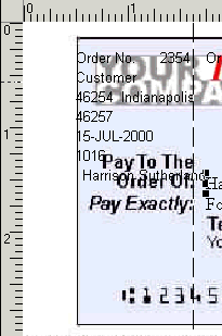

Click in the left, vertical ruler and drag your mouse to the right, so that the line is flush with the text "Pay Exactly."
When you release your mouse button, you will notice that a guideline displays, like the one in the following image:
Figure 31-21 Partial Paper Design view of the check report with horizontal guideline
Note: The guideline is a broken black line spanning across this image, to the right of "Pay Exactly." |

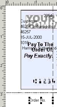

Click the Order No. boilerplate object (located in the upper left-hand corner of the check) and position it along the new guideline, and below the check image at 3.25 inches (8.5 centimeters), like this:
Figure 31-22 Partial Paper Design view of the check with Order No. boilerplate text

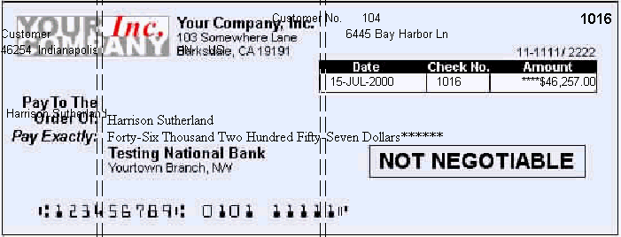

Create another pair of vertical guidelines that are aligned with the box containing the date, amount, and check number. The guidelines should appear here:
Figure 31-27 Second vertical guideline in the Paper Design view
Note: To create this guideline, click in the left-hand ruler, then drag your mouse until the line is aligned to the left of box containing Date, Check No., and Amount. |

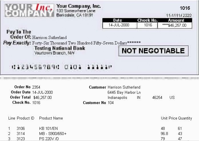

Your report should now look like this:
Figure 31-33 Final check report with spelled-out cash amounts and stub
