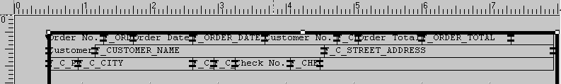

  2. Click the Edit Margin button in the toolbar.
  3. In the Paper Layout view, click the margin frame (the heavy black line) to select it.
  4. At the top of the frame, click the center black resizing square and drag it up, so that the margin is 0.25 inches (0.5 centimeters).
    Tip:
    When you click the center square, notice that a dotted guideline displays while your mouse button is depressed. You can use these guidelines to help place objects exactly where you want them in the Paper Layout view.
    When you are done, it should look something like this:

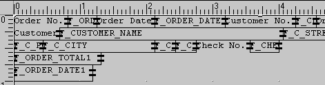

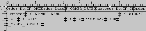

  5. In the Paper Layout view, click F_ORDER_TOTAL, then press CTRL+C on your keyboard.
  6. Click in the area below your layout objects and press CTRL+V.
    You should see a new field called F_ORDER_TOTAL1. If this field displays on top of the other layout objects, click and drag it down below the other layout objects so that your Paper Layout view now looks something like this:
    Figure 31-12 Partial Paper Layout view with F_ORDER_TOTAL1
    Description of Figure 31-12 follows
    Description of "Figure 31-12 Partial Paper Layout view with F_ORDER_TOTAL1"
  7. Copy the F_ORDER_DATE field and paste it below the other fields, so that your layout now looks like this:

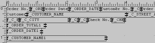

  8. Copy F_CUSTOMER_NAME and paste the field below the other layout objects, so that your layout looks like this:
    Figure 31-14 Partial Paper Layout view with F_CUSTOMER_NAME1
    Description of Figure 31-14 follows
    Description of "Figure 31-14 Partial Paper Layout view with F_CUSTOMER_NAME1"

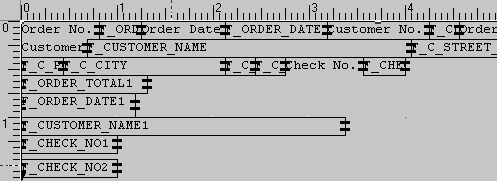

  9. Make two copies of F_CHECK_NO by pressing CTRL+C on your keyboard once, then CTRL+V twice.
    Since this field is small, it may be difficult to find. You can use the Object Navigator to find and select the field. When you click a field in the Object Navigator, under Paper Layout, the corresponding field is also selected in the Paper Layout view.
  10. Position these two new fields below the other layout objects, so that your layout looks like this:
    Figure 31-15 Partial Paper Layout view with F_CHECK_NO1 and F_CHECK_NO2
    Description of Figure 31-15 follows
    Description of "Figure 31-15 Partial Paper Layout view with F_CHECK_NO1 and F_CHECK_NO2"
    We have expanded the size of the two new fields (F_CHECK_NO1 and F_CHECK_NO2) to make them easier to see, but you do not need to resize these fields.

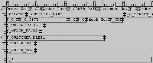

  11. Click the Field tool in the tool palette.
  12. Draw a field below the other layout objects about 5 inches (12.5 centimeters) long, so that your layout now looks like this:
    Figure 31-16 Partial Paper Layout view with F_1 field
    Description of Figure 31-16 follows
    Description of "Figure 31-16 Partial Paper Layout view with F_1 field"

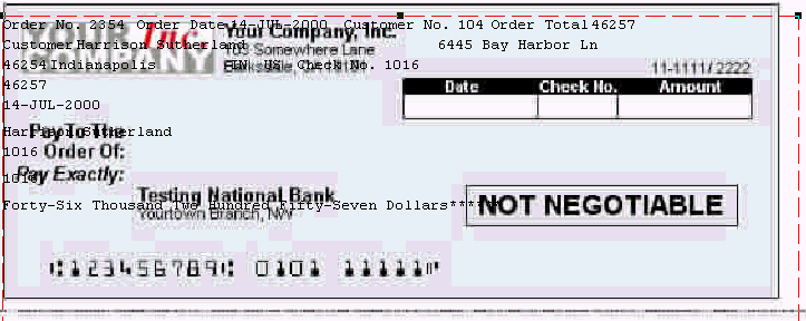

  1. Click the Paper Design button in the toolbar to display your report in the Paper Design view.
    When you click the Paper Design button while you are in another view (that is, Paper Layout view or Data Model view), Reports Builder runs your query and your layout. If you receive any error messages when you click the Paper Design button, go back to your original view to verify your changes. You can always compare your report against the sample report we have provided, called spellcash.rdf.
    You will see your layout objects, as well as the blank check image:
    Figure 31-17 Partial Paper Design view of the check report
    Description of Figure 31-17 follows
    Description of "Figure 31-17 Partial Paper Design view of the check report"
    You will see that the preview does not quite look like a check report. The steps in this section will show you how to move your fields so that your report looks like a proper check.

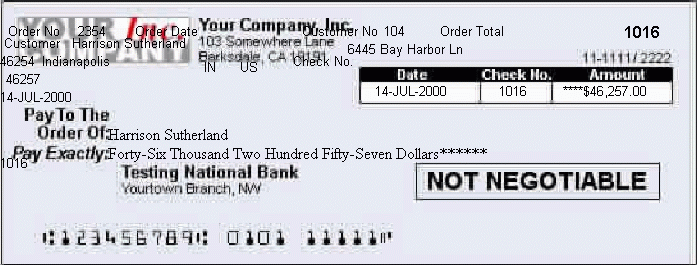

    The check should now look like this:
    Figure 31-19 Check image with fields positioned
    Description of Figure 31-19 follows
    Description of "Figure 31-19 Check image with fields positioned"

  11. Select the F_CUSTOMER_NAME and F_SPELLED_AMOUNT fields by Shift-clicking them, then change the font to Times New Roman, 12 point.
    Your report should now look something like this:
    Figure 31-20 Formatted Check
    Description of Figure 31-20 follows
    Description of "Figure 31-20 Formatted Check"
    You will notice that the other boilerplate text is still overlaying the image. We will rearrange this text later in the chapter.
