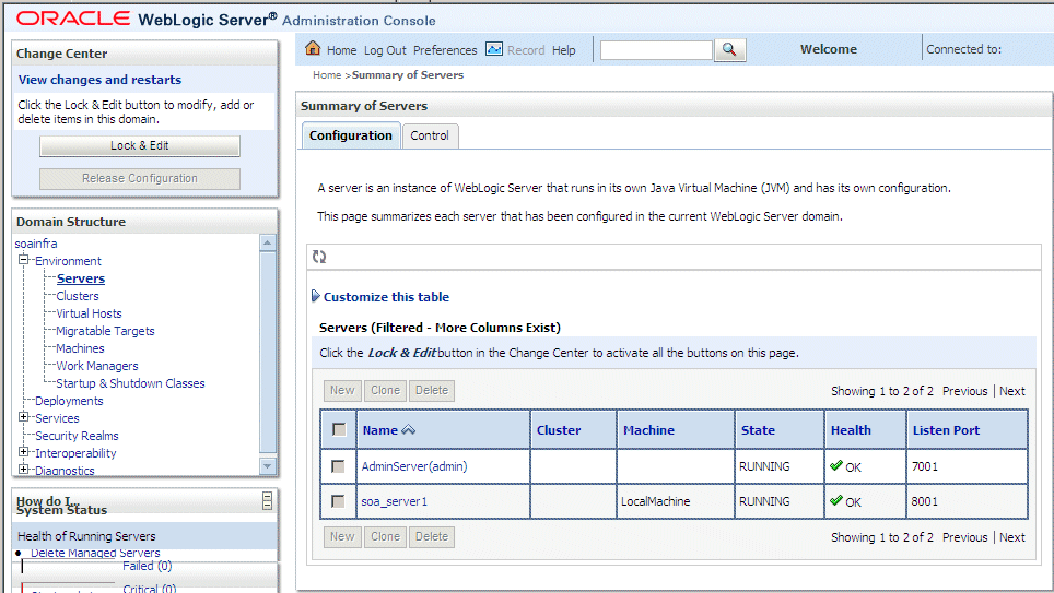

2.2.1 Finding Port Information
You can find port number information in the following ways:
  • From Oracle WebLogic Server Administration Console
    1. Log in to the console.
    2. In the Domain Structure pane, expand Environment and click Servers.
      Weblogic Console
    3. Note the Listen Port column for your server.

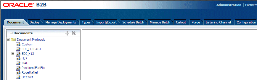

2.3.1 Administration
Use the tabs of the Administration page, shown in Figure 2-2, to manage document protocols, deployments, types, importing and exporting, batching, callouts, purging, listening channels, and configuration.
See Part III, "Oracle B2B Administration" for more information.

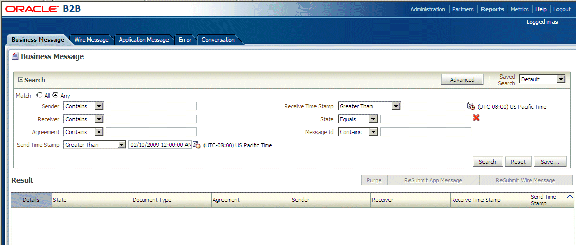

2.3.3 Reports
Use the tabs of the Reports page, shown in Figure 2-4, to create and view reports about the instance (run-time) data.
See Chapter 16, "Creating Reports," for more information.

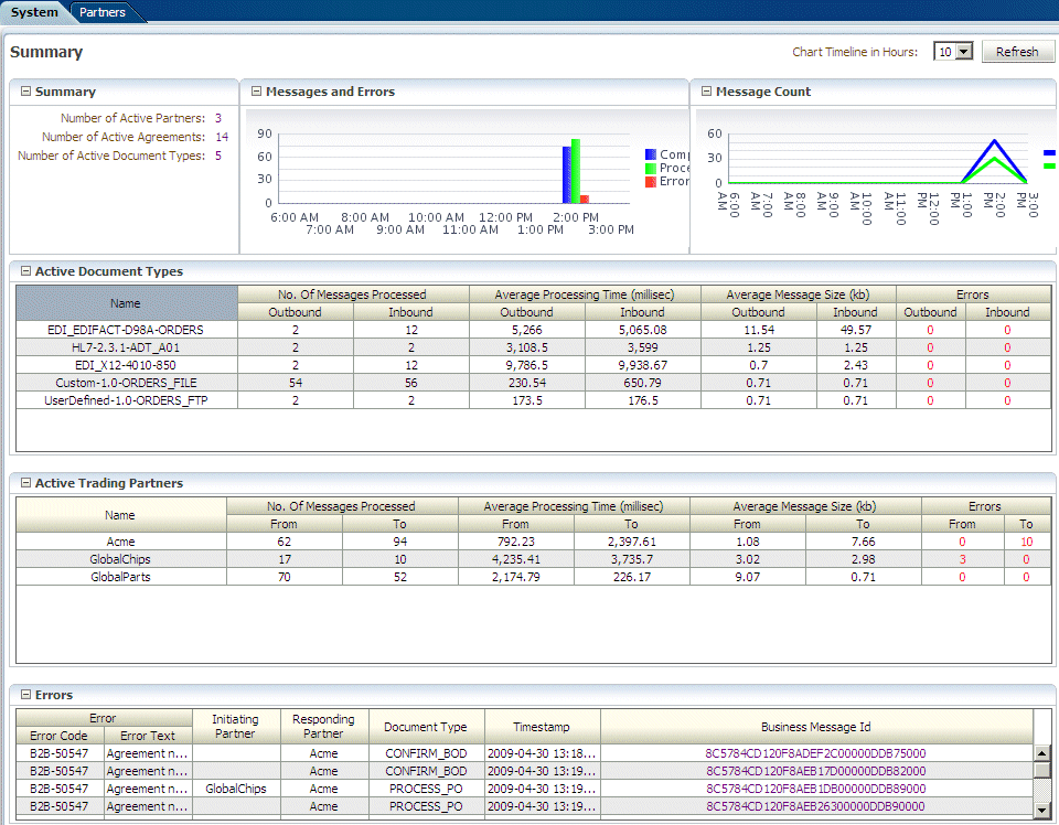

2.3.4 Metrics
Use the tabs of the Metrics page, as shown in Figure 2-5, to see information about deployed agreements, such as lists of the active document types and trading partners, and run-time status, such as error messages and message counts.
See Chapter 17, "Using B2B Metrics," for more information.

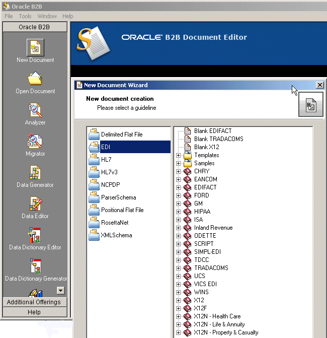

Step 1: Create guideline files (ECS and optional XSD files) in Oracle B2B Document Editor
Using Oracle B2B Document Editor, shown in Figure 2-7, create transaction documents based on templates for hundreds of industry-standard protocols. The Oracle B2B Document Editor is required only when translation is needed. For XML documents, the editor is not used.
Figure 2-7 Creating a Document in Oracle B2B Document Editor
Document editor
Description of "Figure 2-7 Creating a Document in Oracle B2B Document Editor"
For information on Oracle B2B Document Editor, see the following:

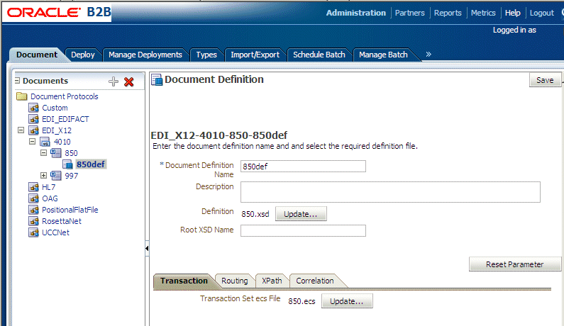

Step 2: Create document definitions
Using the Administration > Document tab of Oracle B2B, shown in Figure 2-9, select from a list of document protocols, and then provide a document protocol version name, a document type name, and a document definition name. (For a Custom document, rather than selecting from the list of document protocols, you add a custom protocol name to the list in the Document Protocols folder.)
Figure 2-9 Creating a Document Definition
Document definitions
Description of "Figure 2-9 Creating a Document Definition"
After selecting the ECS and optional XSD files you created in Step 1, you have created the document definition.
For more information, see Chapter 4, "Creating Document Definitions."

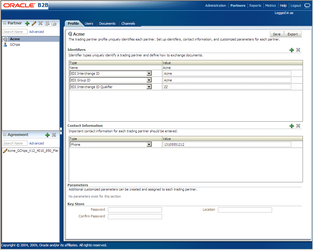

Step 3: Configure trading partners
Using the tabs of the Partners page of Oracle B2B, shown in Figure 2-10, add or update trading partner names, add identifiers and optional contact information, view parameters, add documents and delivery channels, and add key store information.
Figure 2-10 Configuring Trading Partners
Trading partner identifiers
Description of "Figure 2-10 Configuring Trading Partners"
For more information, see Chapter 5, "Configuring Trading Partners."

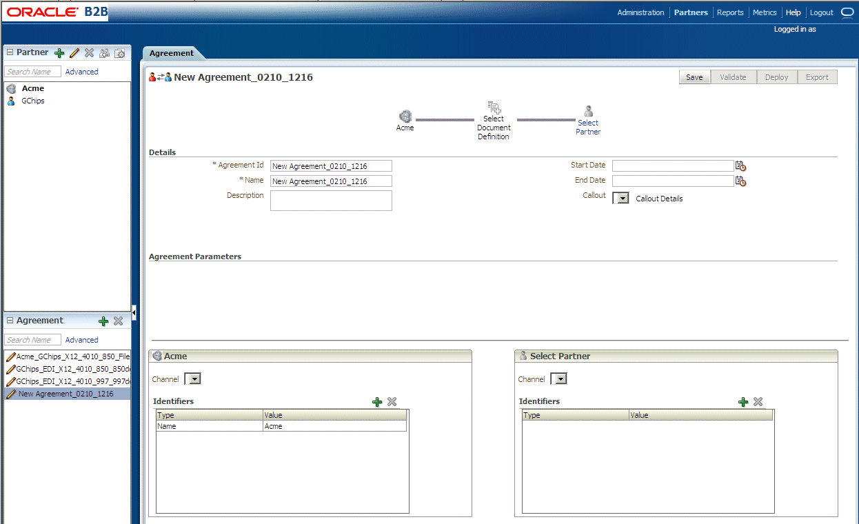

Step 4: Create agreements
Using the Partners > Agreement tab of Oracle B2B, shown in Figure 2-11, create an agreement that specifies the trading partners involved and associates the document definitions, channels, and identifiers with the agreement.
Figure 2-11 Creating a Trading Partner Agreement
Partner agreements
Description of "Figure 2-11 Creating a Trading Partner Agreement"
For more information, see Chapter 6, "Creating and Deploying Trading Partner Agreements."

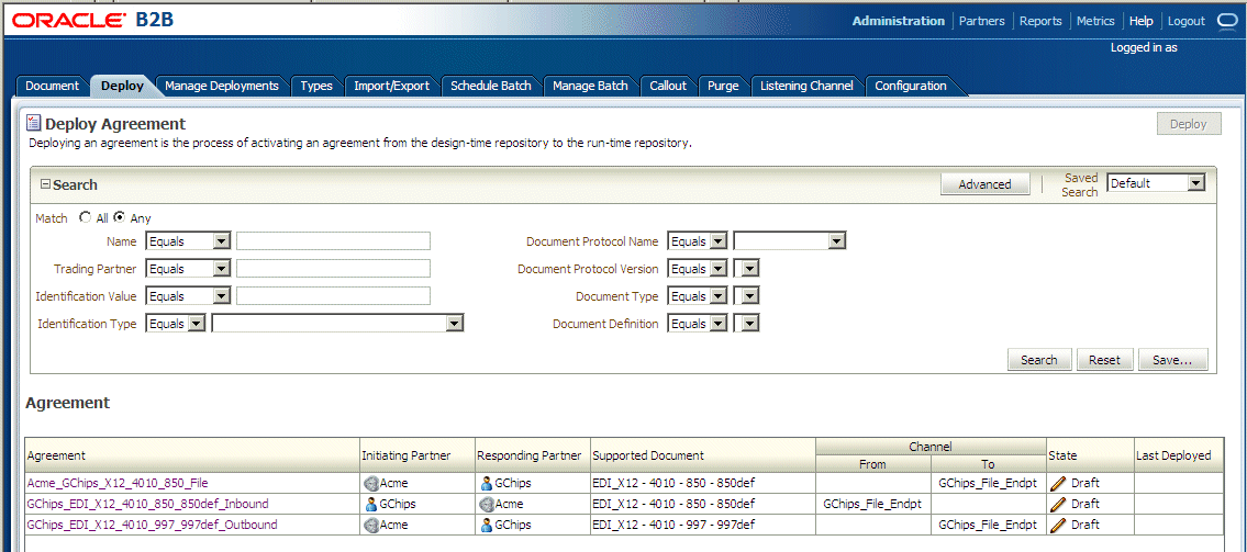

Step 5: Deploy agreements
Using the Administration > Deploy tab of Oracle B2B, shown in Figure 2-12, search for and deploy agreements.
Figure 2-12 Searching for and Deploying Agreements
Description of Figure 2-12 follows
Description of "Figure 2-12 Searching for and Deploying Agreements"

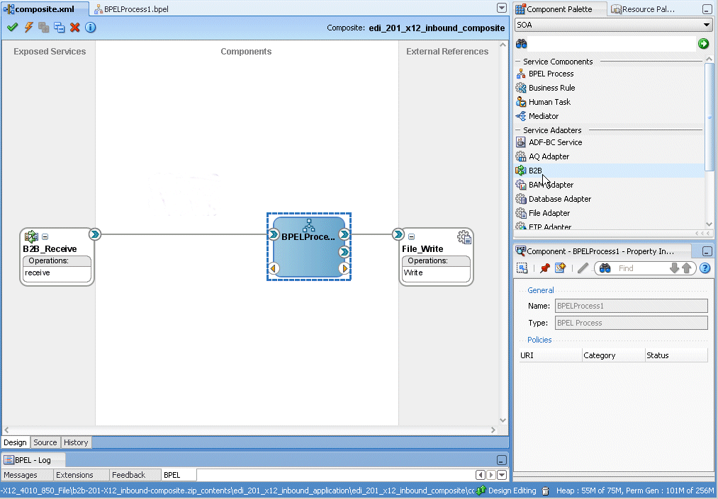

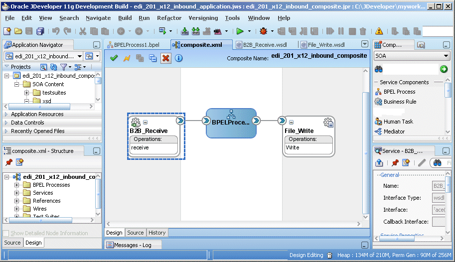

2.5 Using Oracle B2B in the Oracle JDeveloper Environment
To include Oracle B2B in an SOA composite application, use the B2B Configuration Wizard as follows:
To access the B2B binding component:
  1. In Oracle JDeveloper, open the composite for which you want to add a B2B binding component.
  2. From the SOA > Service Adapters panel of the Component Palette, drag B2B to one of the following:
    • To the Exposed Services area when B2B is used as a service (inbound) to receive messages from trading partners and deliver them to SOA composite applications. Oracle B2B is the entry point to the SOA composite application.
    • The External References area when B2B is used as a reference (outbound) to send messages from the SOA composite application to partners.
    B2B binding component in JDeveloper
  3. Follow the steps in the B2B Configuration Wizard of Oracle JDeveloper.
    Select a document definition that was previously created in Oracle B2B. Or, you can launch Oracle B2B from the wizard to create a document definition.
The JMS option on the B2B Integration Type page of the B2B Configuration Wizard is in preview mode. If you want to use this option to communicate with Oracle B2B through JMS queues, start Oracle JDeveloper in preview mode as follows:
ORACLE_JDEV_HOME\jdeveloper\jdeveloper -J"-DPREVIEW_MODE=true"
