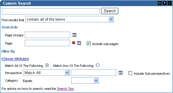

This section discusses the options available on the default Custom Search Form and how you can build your own customized versions. It includes the following subsections:
When you place the Custom Search portlet on a page, you get the default version of the Custom Search Form. You can edit the portlet defaults to display other content in lieu of the form, such as the search results. But the first thing you see, before you edit defaults, is the default version of the Custom Search Form. Table 17-6 lists and describes the elements that make up the default Custom Search Form.
Figure 17-1 The Default Version of the Custom Search Form (Oracle Text Enabled)
Table 17-6 Options Available on the Default Version of the Custom Search Form
| Option | Description |
Search field and button |
Enter the term(s) you want to search for. Separate terms with spaces. Enclose phrases in quotation marks. Click the Search button to execute the search. |
Find results that |
Use this list to specify how rigorously the search results should match the terms entered in the Search field. For example, if you enter three terms, policy, benefit, retirement, and you choose:
When Oracle Text is enabled, a larger set of operators are available for selection. For more detail, see Table 2-1, "Search Operators". Oracle Text is enabled by default, but portal administrators can enable/disable Oracle Text on the Global Settings: Search page. For more information, see the Oracle Fusion Middleware Administrator's Guide for Oracle Portal, available on the Oracle Portal documentation page of the Oracle Technology Network at |
Page Groups |
Use this to limit the range of the search to one or more selected page groups. Click the Browse icon to select from a list of page groups to search. This opens a secondary window where users can move one or more page groups from an Available to a Selected list. By default, all page groups are available. Note that searches can be restricted to one or more page groups or pages. When a page is selected, this Page Groups option is ignored. |
Page |
Use this to select a specific page to search. Clicking the Browse icon opens a secondary window where users may select a page. By default, any page from any page group may be selected. When a page is selected, this Page Groups option is ignored. |
Include sub-pages |
Select this option to include all sub-pages of the selected page in your search. |
Choose Attributes |
Click this link to choose which search attributes are displayed on the search form. Then define attribute values to filter search results. By default, you may filter search results by attributes such as Author, Base Item Type, Category, Character Set, Create Date, Creator, Date Updated, Description, Display Name, Expire Date, File Name, Item Type, Keywords, Last Updated By, MIME type, Name, Perspectives, Publish Date, URL, Version Number. See also Section A.2.4, "Base Searchable Attributes". |
Match All/Any Of The Following |
Use these options to further restrict your search:
Perspective Match All / Match Any |
(Oracle Text enabled) Specify which perspective(s) should apply to search results. Choose Match All or Match Any to perform a search that matches all/any of the perspectives you select. |
Include Sub-perspectives |
(Oracle Text enabled) Select this option to include all sub-perspectives of the perspectives you select. |
Perspective Equals |
(Oracle Text disabled) Specify which perspective should apply to the search results. |
Category Equals |
Specify which category should apply to the search results. |
For advice on how to search, read the Search Tips |
Click this link to open a list of tips for refining a search. |

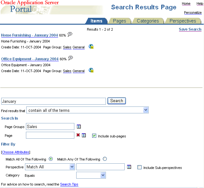

The Search Results Page is the default results page for Custom Search portlets and it is located in the Portal Design-Time Pages page group. This page displays the results of a search as well as any number of other services you may care to include. The objects displayed in the default Search Results Page (Figure 17-2) are listed and described in Table 17-7.
Figure 17-2 The Default Search Results Page
Table 17-7 Elements of the default Search Results Page
| Element | Description |
Tabs (Items, Pages, Categories, Perspectives) |
Each tab contains a Custom Search portlet that is set up to display search results for a different type of portal content. When you view results from an automatic search the tabs are not displayed as these searches can only return results of the same content type. |
Items tab |
This tab displays all returned results that are items. Items include files, images, page links, and the like. Users click a result, and the file is opened, the image is displayed, the link is executed, and so on. |
Pages tab |
This tab displays all returned results that are pages. Users click a result, and the page is opened. |
Categories tab |
This tab displays all returned results that are categories. Users click a result, and a page is opened with a list of portal content that is classified under that category. |
Perspectives tab |
This tab displays all returned results that are perspectives. Users click a result, and a page is opened with a list of portal content that is classified under that perspective. |
Results |
This informational field displays the range of results on the current page and the total number of results. |
Save Search |
Users click this button to save the search criteria specified for the current search. Users have the option of adding a Saved Searches portlet to any page. When they click Save Search, the current search criteria is added as a new link in the Saved Searches portlet. In the portlet, they click the link to a particular saved search to rerun the search. |
Result |
The result link jumps to the item, page, category or perspective that matches the search criteria. The user will not see content they are unauthorized to view, content that has expired, items that are not yet published, content that is derived from a template, portlet instances, Portal Smart Links, or multiple item versions (only the current version of an item is returned when versioning is enabled). Such content is not returned in search results. Note that new or recently modified portal content is not returned in search results until such changes are reflected in the Oracle Text search indexes.If your portal is installed in Oracle Database 10g, Oracle Text indexes can be set up to synchronize immediately after portal content is added, updated, or deleted. Contact your portal administrator to learn more about the current synchronization schedule for Oracle Text indexes in your portal. See also Oracle Fusion Middleware Administrator's Guide for Oracle Portal. |
Score |
The Oracle Text relevancy score, rating how well each result matches the search criteria. The score is high when terms are found in the title. If there are multiple terms in the title, the result ranks even higher. Weighting is also given when multiple terms are found close together, or when search results contain the most matches. |
Property sheet icon |
Click this icon to view the properties (attribute values) of a particular result, such as its description, its publish date, or its expiration period. |
Result Attributes |
The attributes displayed with each search result are configurable, see Section 17.3.4.3, "Customizing Search Results". The default attributes include the object's Create Date, its page group, and its classification category and perspective(s). |
Search Form |
By default, the Search Results Page displays a search form beneath the search results so that users may alter the search criteria and rerun the search without having to navigate back to the original search form. |

Click the Search Form tab:
Select Choose a page group to search to allow the user to further restrict which page groups are searched.
The list of available page groups displayed when the user clicks the Browse icon are those selected on the What to Search tab. If you want the user to always search in all the page groups you have selected, do not select this option.
Alternatively, select Choose a page to search to allow the user to select which page is searched.
Select Choose type of content to search to allow the user to restrict the search to items, categories, perspectives, or pages.
For this option to take effect, the Custom Search portlet setting What type of content should be searched? must be set to Any, on the What to Search tab. If it is not, only search results of the chosen content type are returned. The user is not given the option to choose a content type.
Click OK to save your changes and return to the page.

Click the Search Form tab to specify whether users can override the search criteria you have defined:
Select Search terms box, to allow users to enter their own search terms.
Select Search terms restriction selector, to allow users to choose their own operator for the search.
Hide any search attributes that you do not want users to change, by moving them to the Hidden Attributes list.
Click OK to save your search criteria and return to the page.
The Custom Search portlet is displayed with your search criteria defined.
You can configure a Custom Search portlet to submit search criteria to another, separate Custom Search portlet that displays the search results. If you do this, you must configure both portlets. Some configuration values are passed from the search submission portlet to the search results portlet, while others are not. Table 17-8 lists and explains the configuration settings that are passed over and those that are not.
To understand Table 17-8, imagine the following scenario:
Page A hosts Custom Search portlet A, which is set up to submit search criteria.
Page B hosts Custom Search portlet B, which is used to display results from search criteria defined in portlet A.
Table 17-8 Sharing of options between Custom Search form and results portlets
It is also important to understand how page group/page selection is resolved when a separate Custom Search portlet is used to display search results and the page groups/page selected on the two portlets do not match. Remember that you can select page groups/pages in two different places, on the Edit Defaults: What to Search tab and on the search form itself.
For example, if page groups PG1 and PG2 are selected in Portlet A, but the results Portlet B is configured to search:
a subset of these (PG2), then the common page groups are searched, that is, PG2.
different page groups (PG3 and PG4), then result Portlet B settings are used, that is, PG3 and PG4.
any page groups (nothing selected), then Portlet A settings are used, that is, PG1 and PG2.
Similarly, if Portlet A has no page groups selected, then results Portlet B settings are used. If a page group mismatch does occur, a message is displayed to warn the user that the page group selections on both portlets do not match.
Page selections are resolved slightly differently. If a page is selected in Portlet A, the page must reside within the set of searchable page groups (resolved using the rules described previously). Otherwise, no results are returned.
If you want the results on Portlet B to match the page group/page selection in Portlet A, ensure that the options set on Portlet A are a subset or the same as those on Portlet B. Alternatively, do not place any page group restrictions on the results portlet (choose Search in all page groups, including newly created page groups in the results portlet). See Table 17-2, "Custom Search Options on the Edit Defaults: What to Search tab".
