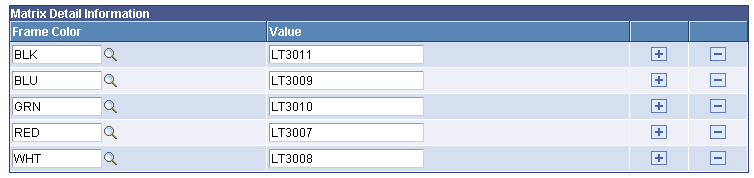

Matrix detail records are uniquely identified by an effective date, and you can access or test the matrix detail information based on this effective date. You can preset multiple detail sets that are activated automatically, based on an effective date.
In establishing the matrix variable details, you can specify wildcards (*) to aid in the maintenance when the system fails to find specific valid key field value combinations. The order of the key fields that are on the matrix controls the way that the system searches for a return value.
Note. You can use wildcards (*) anywhere in the matrix detail definition.
The system processes matrix details in the following order:
First, it looks for a matrix detail result that matches the values for all of the key fields.
If that fails, it tries again, but starts replacing values with a wildcard value (*) for the last key field on the matrix and moves forward.
This search is based on a boolean algorithm where 00000 represents all key fields matched and 11111 represents all wildcard values matched. The first search uses 00000 (no wildcards), then 00001 (1 wildcard in the last key), then 00010 (1 wildcard in the second to last key), then 00011 (2 wildcards—1 in the last key and in the second to last key), and so on.
If a result value is not defined for all wildcard key fields, and a result value is not found, the configuration engine generates a runtime error.
The following figure shows a sample matrix page with the key fields entered.
Example of Matrix Detail page
Here's how the return values appear for some key field values:
