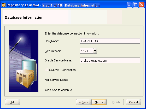

On the Database Information page, enter the host name, port number, and the service name where the OWB is installed.
Click Next.

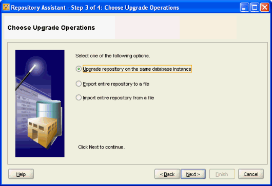

On the Choose Upgrade Operations page, select Upgrade repository on the same database instance.
Click Next.

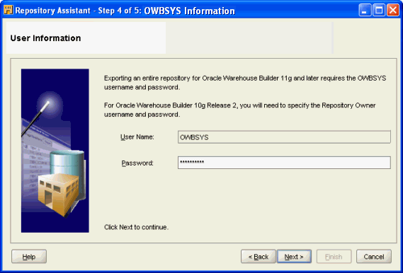

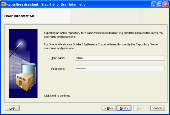

On the User Information page, enter the user name and password of the 10g R2 repository owner.
Click Next.

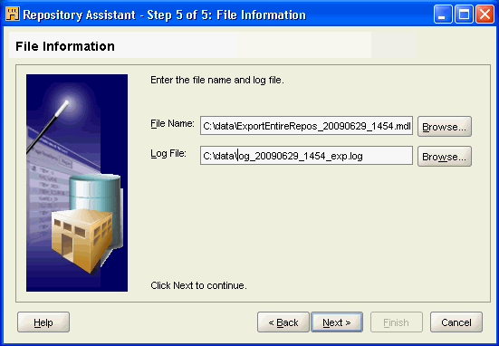

On the File Information page, fill these fields:
File Name: the name of the MDL file for storing the repository.
Log File: the name of the export operation log file that stores status and statistical information.
Click Next.

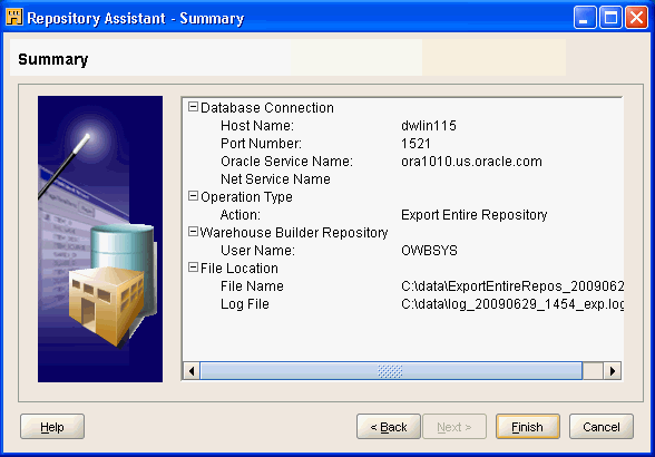

On the Summary page, click Finish.
An Export Repository Progress window appears showing progress.
At the end of the export process, a status message appears. The export operation creates the file.

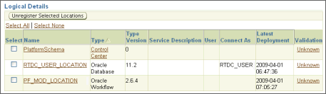

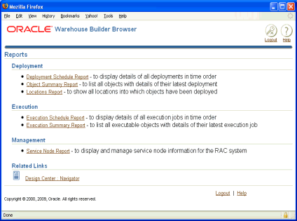

To upgrade the locations, use the Oracle Warehouse Browser Location Report and Locations Report in the Oracle Warehouse Browser.
In Oracle Warehouse Builder, select Control Center.
Click Reports.
In the Reports window, under Deployment, click Locations Reports.

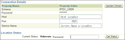

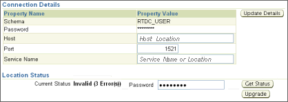

On the Locations Report, under Logical Details, in the Validation column of the table, click Unknown.
Under Connection details, because the status is Unknown, enter the Password and click Get Status.
Note that the Current Status is Invalid.
Under Location Status, click Upgrade.
Note that the Current Status is Valid.
