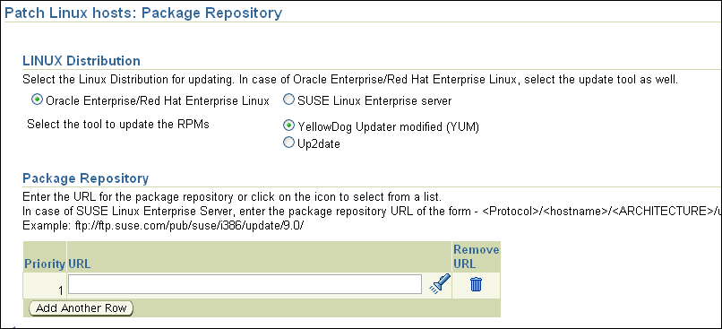

  1. In the Deployments tab, click Patching through Deployment Procedures. Select Patch Linux Hosts and click Schedule Deployment.
  2. In the Linux Distribution section, select the correct distribution and also select the update tool to use.
    Surrounding text describes patch_linux_package_repos.gif.
  3. In the Package Repository section, click the torch icon to select the RPM Repository.
