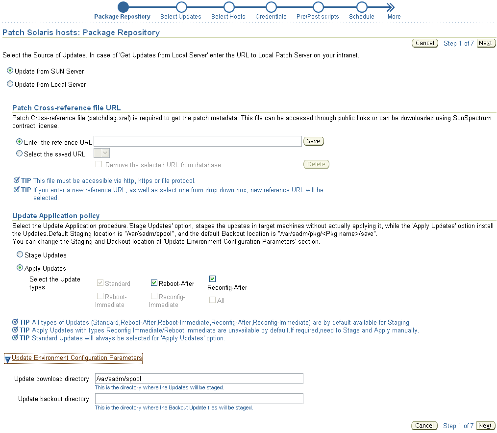

    Patch Solaris Hosts: Package Repository Page
  2. In the Package Repository page, specify the Solaris package repository source.
    You can choose to get the updates from the following locations:
    • Update from SUN Server - Connect to the SUN server and download the Solaris updates from this Web site.
    • Update from Local Server - set up a repository on a local server. To do this, you will require a Sun Spectrum contract account. Refer to the Sun web site for more details.
    Depending on the type of application policy you select, you can either just stage the updates (and not apply them automatically), or choose to stage and apply the updates when the deployment procedure is executed.
    To simply stage the updates and not apply, select Stage Updates.
    To stage and apply the updates, select Apply Updates.
    The patches when applied will have metadata (updates) that are classified as the following types:
    • Standard: Updates of this type will take effect as soon as they are applied. The effects of this patch are visible as soon as it is applied, unless the application being patched is running while the patch is applied.
    • Reboot-After: Updates of this type will take effect only after a reboot.
    • Reconfigure-After: Updates of this type will take effect only after the application is reconfigured.
    • Reboot-Immediate: If you select updates of this type, the selected hosts must be restarted immediately after the patch is applied.
    • Reconfigure-Immediate: If you select updates of this type, the selected hosts must be reconfigured immediately after the patch is applied. If the patched hosts are not reconfigured immediately, such hosts become unstable.

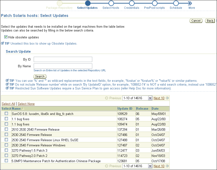

    Patch Solaris Hosts: Select Updates Page
  3. In the Select Updates page, select the packages to be updated. Click Next.

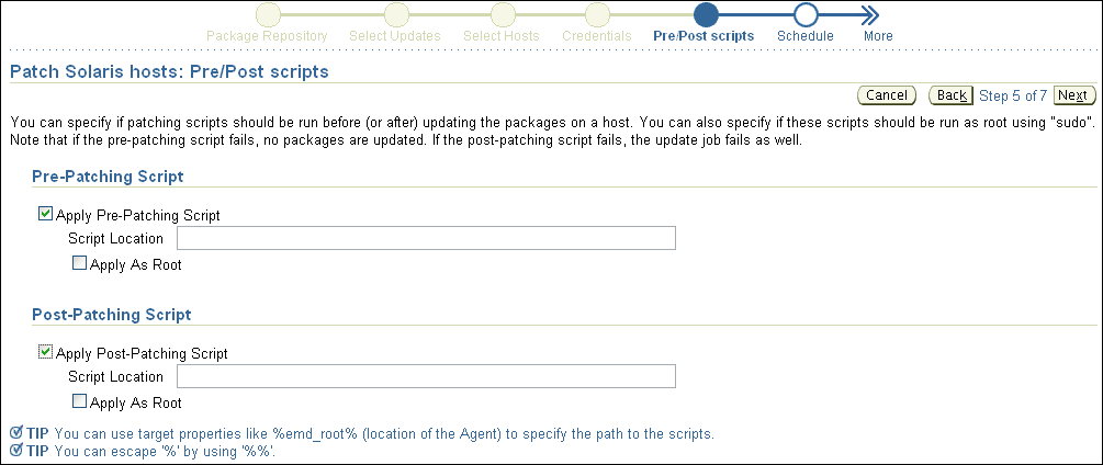

    Patch Solaris Hosts: Pre/Post Scripts Page
  6. In the Pre/Post Scripts page, specify any scripts to be run before and after patching. Click Next.
