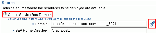

On the Select Source page, in the Source section, select Oracle Service Bus Domain.
For Domain, click the torch icon and select the Oracle Service Bus domain from where the resources can be exported and deployed to a target Oracle Service Bus domain. In the following page of the wizard, you will be allowed to select the domain's projects that you want to export.
For BEA Home Directory, specify the full path to the BEA home directory where all BEA product-related files are stored. For example, /home/mark/bea.

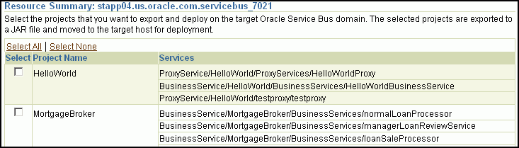

In the Resource Summary section, select the projects you want to export and deploy to the target OSB domain. The selected projects are exported to a JAR file, and the JAR file is moved to the host where the target OSB domain is running.
Note that the resources of the selected projects that exist in the target OSB domain but not in the exported JAR file will be deleted.

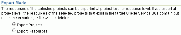

In the Export Mode section, do one of the following:
Select Export Projects if you want to export the resources at project level. While deploying the exported JAR file to the target host, the entire project is deployed. This may add, overwrite, or delete resources depending on the availability of resources on the target host.
Select Export Resources if you want to export the resources at resource level. While deploying the exported JAR file to the target host, only the resources are deployed. This may add or overwrite resources depending on the availability of resources on the target host.
To understand these options better, read the use cases described in Understanding Export Modes.

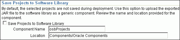

(Optional) In the Save Projects to Software Library section, select Save Projects to Software Library and specify a component name and location if you want to save the exported project JAR file as a generic component in the Software Library.
By default, the projects you select here are exported to a JAR file and moved to the host where the Administration server of the target Oracle Service Bus domain is running. However, the JAR files are not saved in the Software Library for future use. Using this option, you can save them as a component in the Software Library.

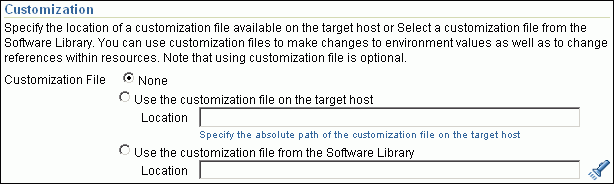

In the Customization section, provide details about the customization file that can be used to modify the environment settings in the target OSB domain.
If you do not want to use a customization file, select None.
If you are using a customization file and if it is available on the host where the target OSB domain is running, then select Use the Customization file on the target host and specify the full path to the location where the file is present.
If the customization file is stored as a generic component in Oracle Software Library, then select Select the customization file from the Software Library and specify the full path to the location in Oracle Software Library where the generic component is stored.
