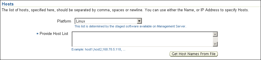

To perform a new Management Agent installation, complete the following steps:
  1. In Grid Control, click Deployments.
  2. On the Deployments page, from the Agent Installation section, click Install Agent.
  3. On the Agent Deploy home page, select Fresh Install. The Installation Details screen appears.

  7. In the Hosts section, do the following:
    Figure 10-2 Hosts Section of the Installation Details Page
    1. Select the appropriate platform on which you want to perform this installation.
    2. In the Provide Host List text box, specify all the hosts (host names or IP addresses) on which you want to perform the Management Agent installation.
      • Ensure that you do not specify duplicate entries of the host list. If there are duplicate host entries in this list, the application hangs. Also ensure that you use the same host names for which the SSH has been set.
      • When virtual host names are provided in Provide Host List and when Cluster Install checkbox is selected, the same virtual host names will be populated in Cluster Node List. These virtual host names listed in Cluster Node List must be changed to match the actual cluster node names of the hosts. The correct cluster node names can be found in OraInventory/ContentsXML/inventory.xml on each remote host.
      Alternatively, click Get Host Names From File to browse and select the file that contains a list of all the required host names.
      If you choose to select a file that contains a list of all required host names, then ensure that the file format is similar to /etc/hosts file. Note that the first column of the file must have the host name and when you provide multiple hosts, then ensure that the hosts are mentioned in separate lines.
