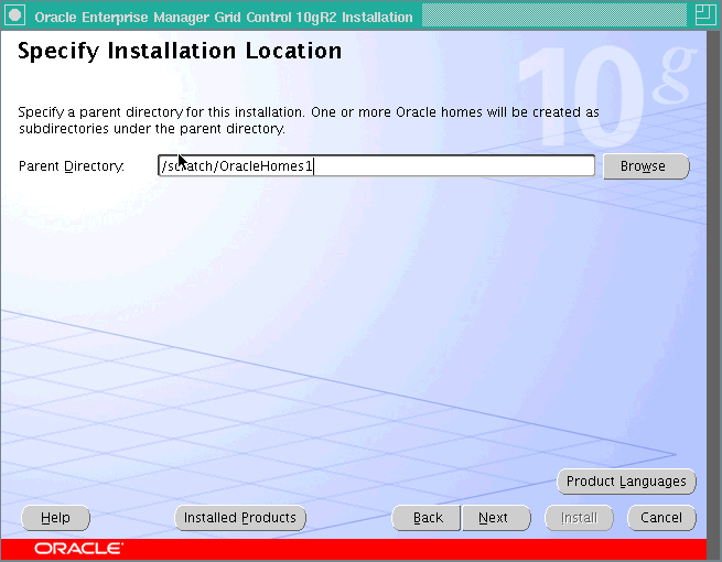

Select the first option (Enterprise Manager 10g Grid Control Using a New Database). By default, this option is selected when you invoke the installer.
Click Next. In the Specify Installation Location screen that appears, specify a parent directory (base directory), for example, /scratch/OracleHomes (on Linux), for the new installation. All the Oracle homes created during this installation are created as subdirectories under this parent directory. For example: db10g, oms10g, and agent10g.
Note: Ensure you do not use symbolic links to specify the Oracle home path. |

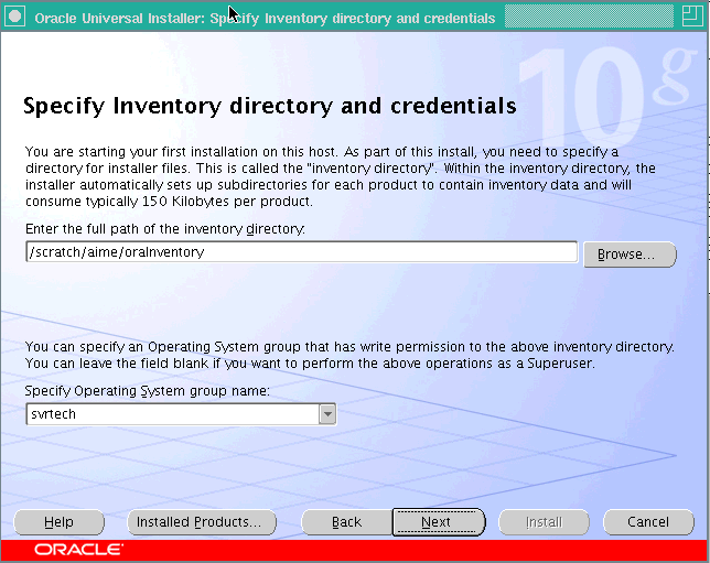

Click Next. The Specify Inventory Directory and Credentials screen appears only if Grid Control is the first Oracle product that you are installing on the machine.
Specify the full path to the directory where Oracle Universal Installer (OUI) should place inventory files and directories. For example, oracle_base/oraInventory (on Linux).
Note: If you are performing the installation on a Microsoft Windows platform, the Specify Inventory Directory and Credentials screen will not appear.On Microsoft Windows, the default inventory files location is |
Refer to the Grid Control online Help for more information on guidelines recommended by Oracle for naming the directories.
Select the appropriate operating system group name that will own the Oracle inventory directories. The group that you select must have write permissions on the Oracle Inventory directories.

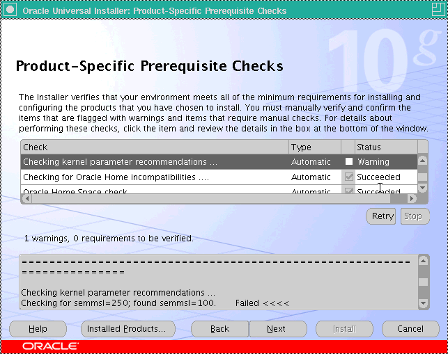

Click Next. The Product-Specific Prerequisite Checks screen appears.
At this point, the installer runs some prerequisite checks to verify if the environment meets the minimum requirements for a successful Grid Control installation.
Early detection of system environment problems such as insufficient disk space, missing patches, inappropriate hardware, and so on results in a smoother installation later.
This screen displays the name, type, and status for all prerequisite checks designed for the installation. Automatic checks are run first, followed by optional and manual checks.
Depending on the status of the automatic checks, you must verify all warning and manual checks. At some point, if you have stopped the prerequisite check and want to rerun these checks, select the checks that you want to rerun and click Retry. As each check runs, a progress bar is shown, and test details (expected results, actual results, error messages, instructions) are displayed in the details section at the bottom of the screen.
Note: You can also run these prerequisite checks in standalone mode, prior to starting therunInstaller. For more information, see Running the Prerequisite Check in Standalone Mode. |
To stop all prerequisite checks, click Stop. At any point in time, click a prerequisite check to view its corresponding details, including the recommended user actions.
To continue with the installation without retrying, click Next.

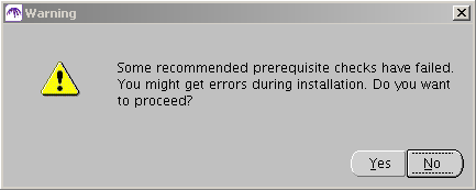

An error message is displayed if some recommended prerequisite checks have failed.
Click No to go back and rerun the prerequisite check. Click Yes to ignore the message and continue with the installation.
Note: It is recommended that you retry checks that were flagged with warnings, failed, or were skipped (stopped by the user) before continuing with the installation. |

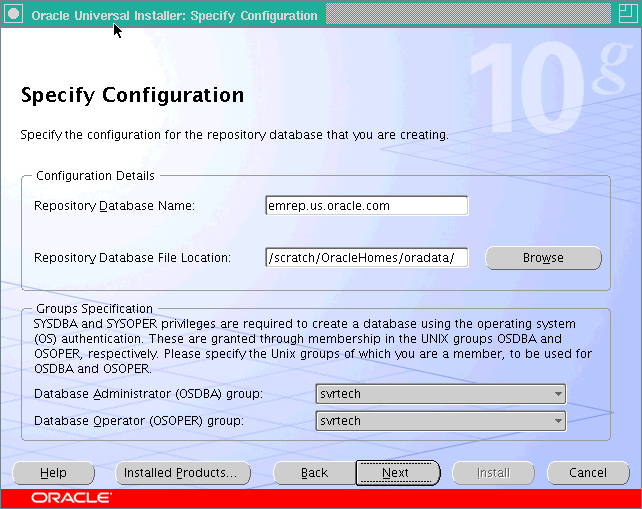

The Specify Configuration screen appears.
You must specify the configuration details for the new database that you are creating, and select the appropriate recipients of the OSDBA and OSOPER privileges (on UNIX only).
Note: Your Management Repository may also require patches to be applied after successful installation. See Operating System, Browser, Target Certification for more information. |
Specify the new Database Name and the Database File Location (location where the new database is going to reside).
Note: It is recommended that you specify a fully qualified database name (for example,emrep.<domain_name>), though appending the database name with the domain name is not mandatory. |
In the Group Specification section, select the OSDBA and OSOPER groups of which you are a member. These memberships are required to grant the SYSDBA and SYSOPER permissions that are, in turn, required to create the new database using the operating system authentication.

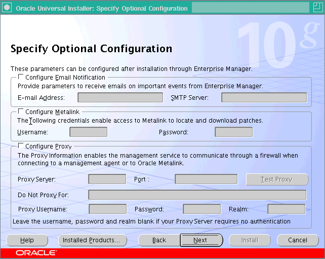

Click Next. The Specify Optional Configuration screen appears.
As the name suggests, all the fields on this screen are optional, and are disabled by default. Select the required check box to enable the corresponding fields.
In the Configure Email Notification section, specify an appropriate e-mail address, and the corresponding SMTP server name. You will receive important information on the condition of the monitored targets, including critical alerts at this e-mail address.
The e-mail address that you specify should be associated with the SYSMAN user to receive notifications.
The SMTP Server is the name of the mail server (for example mail.acme.com). For Linux, the default SMTP server is the local host name. Use the fully qualified host name (including domain).
Note: If you do not provide the e-mail notification information, this feature is not enabled upon installation. You may also choose to configure these settings through the Grid Control console by clicking Notification Methods under Setup. Refer to the Grid Control online Help for more information. |
Specify the My Oracle Support (formerly Metalink) credentials.
If you prefer, you can also enter this information through the Grid Control console after installation by clicking Patching Setup, under Setup.
Note: Grid Control uses these credentials to search for and download patches fromhttp://oracle.com/support/metalink/index.html |
Specify the Proxy Information if Grid Control is using a proxy server for external access. Table 8-4 describes each of the fields under this section.
Table 8-4 Specify Proxy information - Input Fields
| Input | Description |
Proxy Server |
Specify the proxy server host name. For example, |
Port |
Specify the port at which the server is listening. For example, |
Do Not Proxy For |
Specify the URLs that do not need the proxy server to be accessed. You can specify multiple comma-separated values. For example, .here.com, .us.mycompany.com, .uk.mycompany.com, and so on. Note that you must always specify fully qualified host names. |
Proxy User and Password |
Specify the user name and password only if the proxy server has been configured to use these credentials for authentication. These are optional fields. |
Realm |
Specify an appropriate realm value. This becomes a mandatory field only if the proxy server credentials have been configured using a realm. A realm is a string value assigned by the proxy server to indicate the secure space that requires authentication. |
Test Proxy |
Click this button to verify your proxy server settings. |
Note: When you search for a patch, if the proxy properties (saved in thesysman/config/emoms.properties file) are not set, or are set incorrectly, you receive an error message indicating that Grid Control cannot access the My Oracle Support (formerly Metalink) Web site. |
Caution: If the proxy server requires user authentication before providing access, you must specify these credentials here or through the Patching Setup screen under Setup in the Grid Control console. |

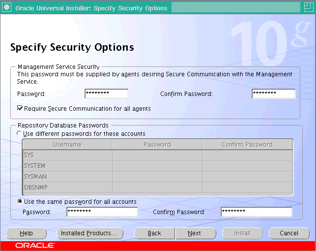

Click Next. The Specify Security Options screen appears.
You must specify the passwords that are used to secure your entire Grid Control environment. This screen has two sections - Management Service Security, and Repository Database Passwords.
Management Server Security: The password that you specify here is used to secure and lock the OMS.
Select Require Secure Communications for all agents if you want the secure OMS to communicate only with secure Management Agents. This is optional, though recommended.
For example, consider you have unsecured 10.1.n agents in the Grid and you have secured the OMS. Now, if you select the Require Secure Communications option, then all communication between the 10.2 OMS and 10.1.n agents fails (because these agents have not been secured).
Note: To secure a Management Agent, run following command. However, note that even after securing the Management Agent, some data might still be transferred over the network without being encrypted.<AGENT_HOME>/bin/emctl secure agent |
Repository Database Passwords: Specify the passwords for each of the administrative database accounts listed in Table 8-5.
Table 8-5 Repository Database Passwords

Super Administrator for the Management Repository database. |
SYSTEM |
Management Repository |
DBSNMP |
Monitoring user for the Management Repository database. |
SYSMAN |
Management Repository, Application Server, and Grid Control |
The default Grid Control Super Administrator and Owner of the Management Repository database schema and the Grid Control application user. The default ias_admin password is the same as the password assigned to the SYSMAN account. This is required to access the Oracle application server ( After the installation, if you want to change this default password, then go to the Oracle home directory of the OMS and run the following command:
If you do not remember the old ias_admin password, then follow the instructions outlined in Document ID 280587.1 that is available on My Oracle Support (formerly Metalink). |
You can use the same password for all four accounts, or specify a different password for each one. These passwords are used to secure the Management Repository database.
To specify a different password for each account, select Use different passwords for these accounts and specify the passwords for each account.
To specify the same password for all accounts, select Use the same password for all accounts and specify one password to be used for all database accounts.
Note: The SYS, SYSMAN, DBSNMP, and SYSTEM users are privileged database users. You must remember the passwords that you specify for them. For more information on password restrictions and recommendations, see Oracle Database Administrator's Guide. |
Password Restrictions and Recommendations
The following restrictions apply to passwords:
Passwords must be between 5 and 30 characters long.
Passwords should not start with a number.
Passwords cannot be the same as the user name.
Passwords must include letters (lowercase/uppercase) and numbers only.
Note: The SYSMAN password can include underscores (_), and hyphens (-), dollar ($), and hash (#) along with alphanumeric characters. Alphabetic characters can be uppercase or lowercase. |
Passwords cannot be Oracle reserved words. See Appendix I, "Oracle Reserved Words" for more information.
Note: Oracle recommends that the passwords you specify have the following characteristics:
Click Next. The Summary screen appears.
This screen provides a summary of the options that you have selected during the installation process. Depending on the installation type, it also provides any or all of the following details:

The Specify Installation Location screen appears.
Specify the full path to the parent directory (base directory), for example, /scratch/OracleHomes. All the Oracle homes created during the installation are placed as subdirectories under this parent directory. For example: oms10g, and agent10g.
Caution: Do not use symbolic links to specify the Oracle home path. |

Click Next. The Specify Inventory Directory and Credentials screen appears if is the first Oracle product that you are installing on the machine. See Figure 8-4, "Specify Inventory Directory and Credentials" for details.
Click Next. The Product Specific Prerequisites Check screen appears.
Depending on the status of the automatic checks, you must verify all warning and manual checks. At some point, if you have stopped the prerequisite check and want to rerun these checks, select the checks that you want to rerun and click Retry. As each check runs, a progress bar is shown, and test details (expected results, actual results, error messages, instructions) are displayed in the details section at the bottom of the screen. See Figure 8-5, "Product-Specific Prerequisite Checks" for details.

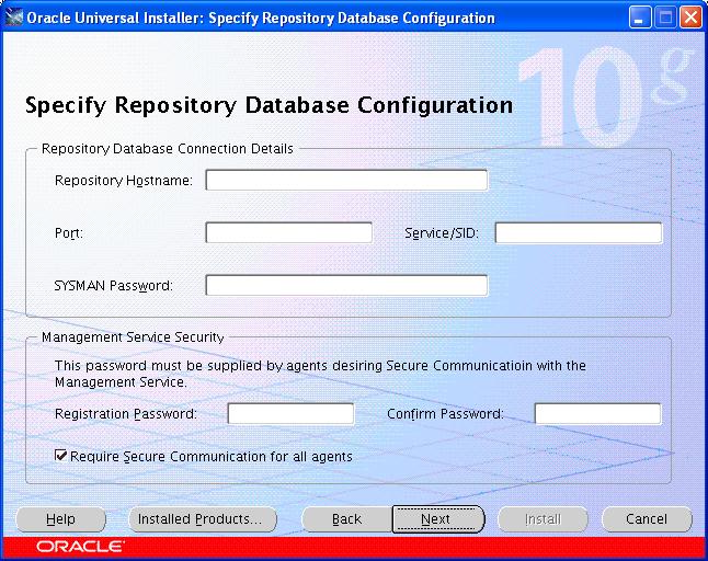

Click Next. The Specify Repository Database Configuration screen appears.
Specify the connection details for the existing database in which the Management Repository should be created. The Management Repository database can be created on the following database releases:
Oracle Database 10g Release 1 (10.1.0.4 and later), Enterprise Edition
Note: If you are performing a Grid control installation using an existing database, ensure the database is of a 10.1.0.3 release or later. |
Oracle Real Application Clusters 10g Release 1 (10.1.0.4 and later)
Note: If you are performing a Grid control installation using an existing database, ensure the existing Oracle RAC database is of a 10.1.0.3 release or later. |
Oracle9i Release 2 (9.2.0.6 and later), Enterprise Edition
Oracle9i Real Application Clusters Release 2 (9.2.0.6 and later)
In the Database Connection Details section, specify a fully qualified host name, listener Port number, SID (system identifier) for the database instance, and the SYS password.
As the name suggests, all the fields on this screen are optional, and are disabled, by default. Select the required check box to enable the corresponding fields.
In the Configure Email Notification section, specify an appropriate e-mail address, and the corresponding SMTP server name in this section. You will receive information on important developments and events in Grid Control, including critical alerts, at this e-mail address.
The SMTP server is the name of the mail server (for example mail.acme.com). For Linux, the SMTP server must be the local host name. Use the fully qualified host name (including domain).
Specify the My Oracle Support (formerly Metalink) credentials if you are going to use a proxy server to access My Oracle Support.
If you prefer, you may also enter this information through the Grid Control console after installation by clicking Patching Setup, under Setup.
Note: Grid Control uses the My Oracle Support (formerly Metalink) credentials to search for and download patches fromhttp://oracle.com/support/metalink/index.html |
Specify the Proxy Information if Grid Control is using a proxy server for external access. See Table 8-4, "Specify Proxy information - Input Fields" for a description on each of the input fields in this section.
Note: If the proxy server requires user authentication before providing access, you must specify these credentials here, or through the Patching Setup screen under Setup in the Grid Control console. |
Click Next. The Specify Passwords screen appears.
Specify the Management Service Security, and Repository Database passwords that are used to secure your entire Grid Control environment.
Select Require Secure Communications if you want the secure OMS to communicate only with Secure Agents. This is optional, though recommended.
For example, if you have 10g R1 (10.1.n) agents in the Grid environment and you have secured and locked the OMS, and selected the Require Secure Communications option, then all communication between the 10g R2 (10.2) OMS and 10.1 agents fails (because these agents have not been secured).
To secure a Management Agent, run the following command from the Management Agent Oracle home of that particular target. However, note that even after securing the Management Agent, some data might still be transferred over the network without being encrypted.
emctl secure agent
See the section on Password Restrictions and Recommendations in this chapter for more information.

In the Specify Installation Type screen, select the third option (Additional Management Service).
In the Specify Installation Location screen, specify the full path to the parent directory (base directory), for example, /scratch/OracleHomes. The OMS home created during the installation is placed as a sub-directory under this parent directory. For example: oms10g.
Depending on the status of the automatic checks, you must verify all warning and manual checks. At some point, if you have stopped the prerequisite check and want to rerun these checks, select the checks that you want to rerun and click Retry. As each check runs, a progress bar is shown, and test details (expected results, actual results, error messages, instructions) are displayed in the details section at the bottom of the screen. See Figure 8-5, "Product-Specific Prerequisite Checks" for more information.
Note: You can also run these prerequisite checks in standalone mode, prior to starting therunInstaller. For more information on running these prerequisite checks in standalone mode, see Running the Prerequisite Check in Standalone Mode. |
You must configure the additional OMS to establish the connections with the existing Management Repository.
Note: The existing Management Repository database must be one of the following releases:
The Management Repository database may also require patches to be applied, prior to successful installation. See Operating System, Browser, Target Certification for more information. |
In the Repository Database Connection Details section, specify a fully qualified host name on which the Management Repository database is installed, the repository port, and the SID (system identifier) for the database instance.
The SID identifies a specific Oracle database and distinguishes it from other databases on the computer.
Note: When selecting an existing cluster database for creating a Management Repository, you must replace the SID value with the Management Service name. |
Enter the password for the SYSMAN user (the default Super Administrator account for Grid Control).
In the Management Service Security section, specify the password used to secure and lock the OMS.
Select Require Secure Communications for all agents if you want the secure OMS to communicate only with Secure Agents. This is optional, though recommended.
For example, if you have 10g R1 (10.1.n) agents in the Grid environment, and you have secured the OMS and selected the Require Secure Communications option, then all communication between the Oracle Management Service 10g R2 (10.2) and Oracle Management Agent 10g R1 (10.1) fails (because these agents have not been secured).
To secure Management Agent, run the following command from the Management Agent Oracle home of that particular target. However, note that even after securing the Management Agent, some data might still be transferred over the network without being encrypted.
emctl secure agent
See the section Password Restrictions and Recommendations in this chapter for more information.
Note: The password that you specify here must be the same as the password that you specified to secure the OMS.Ensure that all OMS instances using the same repository must use the same secure password. |
Select the Configure Proxy check box (optional) if Grid Control is using a proxy server for external access. Specify the properties for the proxy server host name (enter a fully qualified host name), port number, Do Not Proxy for list, and the Proxy user credentials. See Table 8-4, "Specify Proxy information - Input Fields" for a description of the input fields.
Specify an appropriate Realm value. This becomes a mandatory field only if the proxy server credentials have been configured using a Realm, in which case, you must specify an appropriate Realm value.
A Realm is a string value that is assigned by the proxy server to indicate the secure space that requires authentication.
