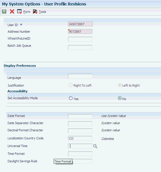

1.5.4 Setting Up User Display Preferences
Access the User Profile Revisions form.
Figure 1-1 User Profile Revisions form
Description of Figure 1-1 follows
Description of ''Figure 1-1 User Profile Revisions form''
Localization Country Code
Enter a UDC (00/LC) that identifies a localization country. It is possible to attach country-specific functionality based on this code by using the country server methodology in the base product.
Language
Enter a UDC (01/LP) that specifies the language to use on forms and printed reports. Before you specify a language, a code for that language must exist at either the system level or in the user preferences. Additionally, you must have the language CD installed.
Date Format
Enter the format of a date as it is stored in the database.
If you leave this field blank, the system displays dates based on the settings of the operating system on the workstation. With NT, the Regional Settings in the Control Panel control the settings for the operating system of the workstation. Values are:
Blank: Use the system date format.
DME: Day, month, four-digit year
DMY: Day, month, year (DDMMYY)
EMD: Four-digit year, month, day
MDE: Month, day, four-digit year
MDY: Month, day, year (MMDDYY)
YMD: Year, month, day (YYMMDD)
Date Separator Character
Enter the character to use when separating the month, day, and year of a given date. If you enter an asterisk (*), the system uses a blank for the date separator. If you leave the field blank, the system uses the system value for the date separator.
Decimal Format Character
Enter the number of positions to the right of the decimal that you want to use. If you leave this field blank, the system value is used as the default.
