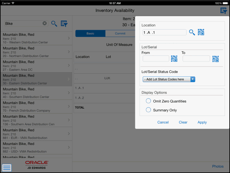

To define filter criteria, tap the Filter button in the top right of the screen.
Figure 43-2 Inventory Availability: Availability Filters - Tablet
You can filter records based on location, a range of lot/serial numbers and lot/serial status code.
(Release 9.1 Update) To filter by location and range of lot/serial numbers, you populate data in the Location and Lot/Serial Number fields using one of these three options:
Use the keyboard on your mobile device to manually enter the data.
Use the camera application on your mobile device to scan the data.
To use this option, tap the QR Code button next to the Location and the Lot/Serial number field. The system launches the device camera and you can scan the barcode of the location and the lot/serial number.
Use a Bluetooth-enabled scanning device to scan the data.
To use this option, tap the Location and the Lot/Serial number field to activate the scanning device. Then, scan the barcode of the location and lot/serial number using the scanning device.
You can review only the summary quantity information by selecting the Summary Only option. You can omit zero quantities by selecting the Omit Zero option.

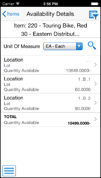

The system displays a list of items depending on your search criteria.
Tap a record to view availability information.
The system displays summary availability information.
Figure 43-3 Inventory Availability: Availability Details - Smartphone
The system displays available quantity for different location-lot combinations and also the total quantity available.

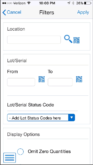

To define filter criteria, tap the filter icon in the top right of the screen.
Figure 43-4 Inventory Availability: Availability Filters - Smartphone
You can review only the summary quantity information by selecting the Summary Only option. You can omit zero on-hand quantities by selecting the Omit Zero Quantities option.

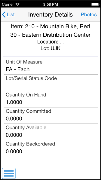

To review inventory availability information, tap a location on the Availability Details screen.
The system displays item availability information including unit of measure, lot/serial status code, on hand quantity, committed quantity, available quantity and backordered quantity.
Figure 43-5 Inventory Availability: Inventory Details - Smartphone

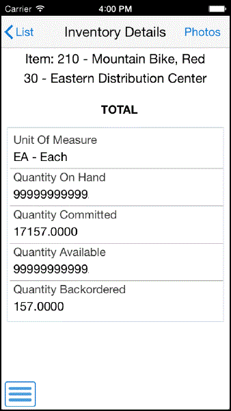

To view total quantity information, tap the Total row on the Availability Details screen.
The system displays totals of all quantities for the item, including on hand quantities, committed quantities, available quantities and backordered quantities.
Figure 43-6 Inventory Availability: Total Availability - Smartphone
To view item photos, tap the Photos button.
To go back to the list of item locations, tap the List button.
