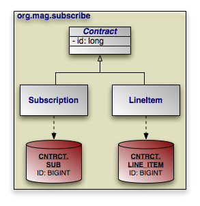

In our model, the abstract Contract class
uses the subclass-table inheritance strategy.
Contract's two direct subclasses,
Subscription and
LineItem, each map all of
Contract's fields into their own tables.

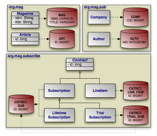

All of the classes in our model except Contract
and LifetimeSubscription
(not pictured) use the new-table strategy.
Most of these classes are either base classes or direct
subclasses of Contract, a
subclass-table class. In these cases, the
new-table strategy is the default.

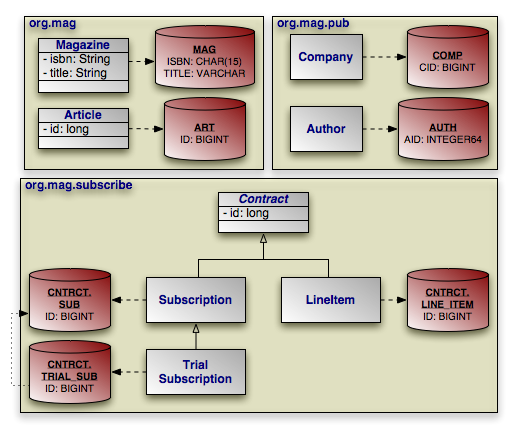

TrialSubscription, however, extends
Subscription, which is itself mapped to
a table. Therefore, TrialSubscription
could have mapped its fields to
Subscription's table.
Instead, TrialSubscription maps its
declared fields to the CNTRCT.TRIAL_SUB
table, and joins to the CNTRCT.SUB table for
base class state. The join is made by linking the
CNTRCT.TRIAL_SUB.ID foreign key column to the
CNTRCT.SUB.ID primary key column. The
example below shows how to represent this in mapping metadata.

Now that we have covered JDOR's inheritance strategies, we can update our mapping document with inheritance information. Here is the complete model:
And here is the corresponding mapping metadata:
Example 15.8. Inheritance Mapping
<?xml version="1.0"?>
<orm>
<package name="org.mag">
<sequence name="ArticleSeq" datastore-sequence="ART_SEQ"/>
<class name="Magazine" table="MAG">
<!-- not strictly necessary, since this is the default -->
<inheritance strategy="new-table"/>
<field name="isbn">
<column name="ISBN" jdbc-type="char" length="15"/>
</field>
<field name="title" column="TITLE"/>
</class>
<class name="Article" table="ART">
<field name="id" column="ID"/>
</class>
</package>
<package name="org.mag.pub">
<sequence name="AuthorSeq" factory-class="Author$SequenceFactory"/>
<class name="Company" table="COMP">
<datastore-identity column="CID" strategy="autoassign"/>
</class>
<class name="Author" table="AUTH">
<datastore-identity sequence="AuthorSeq">
<column name="AID" sql-type="INTEGER64"/>
</datastore-identity>
</class>
</package>
<package name="org.mag.subscribe">
<sequence name="ContractSeq" strategy="transactional"/>
<class name="Contract">
<inheritance strategy="subclass-table"/>
</class>
<class name="Subscription" table="CNTRCT.SUB">
<field name="Contract.id" column="ID"/>
</class>
<class name="LifetimeSubscription">
<inheritance strategy="superclass-table"/>
</class>
<class name="TrialSubscription" table="CNTRCT.TRIAL_SUB">
<inheritance strategy="new-table">
<join column="ID"/>
</inheritance>
</class>
<class name="Subscription$LineItem" table="CNTRCT.LINE_ITEM">
</class>
</package>
</orm>
