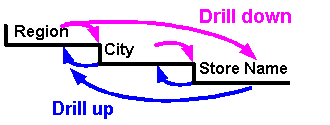

A drill hierarchy is a set of related items that provide a predefined path to help Discoverer users navigate worksheets. The figure below shows a typical drill hierarchy based on geographical region (that is, Region, City, and Store Name).
Using the example drill hierarchy above, drilling down into a region enables a worksheet user to analyze data about cities in the selected region.
Drill hierarchies are created by the Discoverer manager. If a worksheet item is included in multiple drill hierarchies, Discoverer assigns the last hierarchy used and saved as the default drill hierarchy. The default hierarchy items are displayed in a -drill menu. Other hierarchy items are displayed under the All Hierarchies menu option.
To select a drill level from other hierarchies available, select the All Hierarchies option on the drill menu. In the example below, the other hierarchies available are Geographical hierarchy and Video Analysis Store Hierarchy.

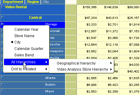

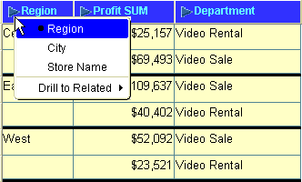

To drill down using a drill icon:
Click the drill icon next to the heading of the worksheet item you want to drill down into.
For example, to drill down from Region to City, select the drill icon in the Region item heading.
Select a level of detail below the current level of detail.
Hint: The current level of detail is indicated by a black dot.
For example, to drill down from Region to City, select the City option.
Discoverer updates the worksheet with the drill level you selected. For example, if you drill down from Region to City, Discoverer expands the worksheet to show City information.
To drill up using a drill icon:
Click the drill icon next to the heading of the worksheet item you want to drill up from.
For example, to drill up from City to Region, select the drill icon in the City item heading.
Select a level of detail above the current level of detail.
For example, to drill up from City to Region, select the Region option.
Discoverer updates the worksheet with the drill level you selected. For example, if you drill up from City to Region, Discoverer collapses the worksheet to only show data summarized at the Region level.

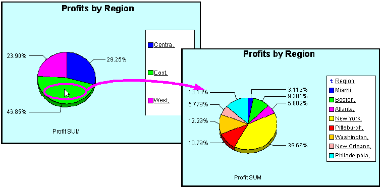

To drill down using a graph label in graph data:
Display the graph you want to analyze.
Select the underlined graph label for the item value you want to drill down into.
For example, select the West graph label to drill down to data for the West region. Discoverer displays data for the next level down in the current drill hierarchy.

Notes
When you drill in a graph you only drill using the current drill hierarchy.
In pie charts, you can also drill directly down into each segment. In the example below, to display detailed profits data about cities in the East region, you double click on the East segment (that is, labeled 46.85%). Alternatively, select the axis label East in the graph legend to drill down.
When you drill into a graph, the worksheet data is also updated (if displayed) to match the graph.
You can drill directly into a bar on a bar graph by double clicking on the bar.

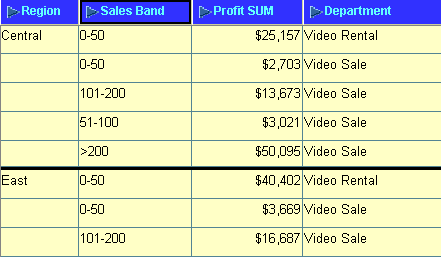

You drill to a related item to add a related item to the worksheet. For example, if you select Department, the Department item is added to the worksheet. Related items are items that are not currently in the worksheet but are in folders used by the worksheet. The item you drill to does not have to be in the same drill hierarchy as the item you drill from.
In the example below, you want to add information on sales bands to a worksheet. Although you could do this by editing the worksheet to add the Sale Band item to the worksheet, you can also use the drill menu to quickly add this information.

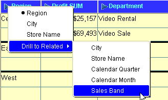

To drill to a related item using a drill icon:
Click the drill icon next to the heading of the worksheet item you want to drill from.
A pop up list is displayed.
If there are too many items to display in a drop down list, you choose the drill item from the "Select item to drill dialog".
From the pop up list, select the Drill to Related option.
Discoverer displays a list of related worksheet items.
Select a worksheet item from the pop up list to drill to that item.
Discoverer adds the related item that you selected to the worksheet (unless you changed the advanced settings on the Drill dialog).

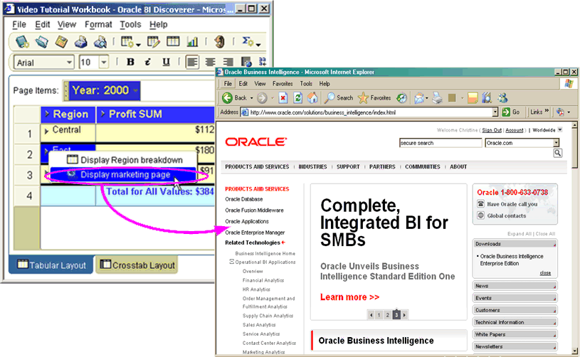

This section explains how to use drill links in Discoverer, and contains the following topics:
A user defined drill link is a way to access (or drill out to) another worksheet or Internet page from a particular worksheet cell value. For example, you might select a drill link in a worksheet cell in the Region item to display a worksheet containing more detailed information about the region in the cell you selected. Or, an Internet site containing a map of the region.
In Discoverer Plus Relational, you can create you own drill links in worksheet items. When you add drill links to a worksheet, the drill links are available when the worksheet is accessed in Discoverer Viewer and Discoverer Desktop. In addition, the Discoverer manager might set up drill links for database files (for more information, see "About drill links defined by the Discoverer manager").
Drill links enable you to navigate from one worksheet to another (in any workbook that you have access to) and from a worksheet to an Internet URL.
When you create a drill link for a worksheet item, a drill link icon is displayed in every worksheet cell value in the worksheet for that item.
You can create multiple drill links for a worksheet item. When you select a drill link on a worksheet item that has multiple drill links, Discoverer displays a list of drill links available. In the example below, the Region worksheet cell has two drill links (that is, Display Region breakdown, and Display marketing page).
Figure 10-7 Multiple drill links in a worksheet cell

You use drill links that you set up yourself (or are set up by the workbook creator) to drill out to other worksheets or Internet URLs (for more information, see "About user defined drill links").
Drill links enable you to interconnect worksheets and Internet pages to enable both Discoverer Plus Relational and Discoverer Viewer users to analyze a wider range of data quickly and easily. For more information about creating drill links, see "How to create drill links".
In the example below, the drill link on the Region item in the Tabular Layout worksheet displays the Breakdown worksheet with data for the selected region (for example, East).
A worksheet item can have multiple drill links. In the example below, the Region worksheet item contains two drill links, which are displayed when you select the drill link icon. Selecting the 'Display marketing page' link displays the Oracle Corporation Business Intelligence page in a browser.

You use drill links that you set up yourself (or are set up by the worksheet creator) to drill out to other worksheets or Internet pages. You can also drill out to a file stored in the database. For more information, see "About user defined drill links".
You can drill to another worksheet, Internet URL, or file stored in the database using:
a drill link icon (for more information, see "How to drill out to a worksheet or Internet URL using a drill link icon")
the Drill dialog (for more information, see "How to drill out to a worksheet or Internet URL using the Drill dialog")
You drill out to analyze data or information external to the current worksheet. For example, you might want to:
display a different worksheet in a new tab window
display an Internet page in a browser window
display a file (for example, a Microsoft Word file) in a separate application
To drill out to a worksheet, Internet page, or file:
Select the drill link icon in the worksheet cell you want to drill out from.
Discoverer displays a pop up list of drill links available. Select the link you want to use from the pop up list.
Discoverer behaves as follows:
if you drill out to a worksheet in the same workbook, Discoverer displays the worksheet in a new tab window
if you drill out to a worksheet in a different workbook, Discoverer closes the current workbook and opens the new workbook and worksheet
if you drill out to an Internet page, Discoverer displays the Internet page in a new browser window
if you drill out to a file, Discoverer displays the file using associated application (for example, a text editor)
To drill out to a worksheet or Internet URL using the Drill dialog:
Select the worksheet item or cell you want to drill on.
Choose Tools | Drill to display the "Drill dialog".
Hint: You can also display the Drill dialog by right-clicking on a worksheet cell and selecting the Drill option.
If you did not select a worksheet cell in step 1, use the Where do you want to drill from? drop down list to select the worksheet item you want to drill on.
Select Drill to Link from the Where do you want to drill to? drop down list.
Select an item from the list.
Click OK.
if you drill out to an Internet URL, Discoverer displays the Internet page in a new browser window
