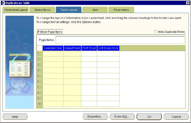

You duplicate a worksheet when you want to quickly create a worksheet that is very similar to an existing worksheet. For example, you might want to transform a duplicate of a crosstab worksheet into a table worksheet.
Duplicating a worksheet also enables you to work on a copy of a worksheet, leaving the original worksheet intact. For example, you might want to work on a temporary worksheet that you discard later.
To duplicate a worksheet:
Display the worksheet you want to duplicate.
Choose one of the following options, depending on whether you want the new worksheet to be a table worksheet or a crosstab worksheet:
Choose Edit | Duplicate Worksheet | As Table to duplicate the current worksheet using the Duplicate as Table dialog
Choose Edit | Duplicate Worksheet | As Crosstab to duplicate the current worksheet using the Duplicate as Crosstab dialog
Discoverer displays the Duplicate as Table dialog or Duplicate as Crosstab dialog, which enables you to change the default position of the new worksheet.
(optional) Use the tabs on the Duplicate as Table dialog or Duplicate as Crosstab dialog to change the default settings for items on the new worksheet.
For example, you might use the Select Items tab to add items to the duplicated worksheet, or you might use the Format tab to change the default display style of worksheet items.
Click OK to save the new worksheet and close the dialog.
The new worksheet is now displayed ready for you to analyze. The default worksheet name that Discoverer assigns is the original worksheet name appended with a unique number. For example, if you duplicate a worksheet named Sales Analysis, the new worksheet is named Sales Analysis 2.
You might want to change the default name of the new worksheet (for more information, see "How to rename worksheets and workbooks").
Hint: Use the tabs at the bottom of the Discoverer work area to navigate between the original worksheet and the new worksheet.

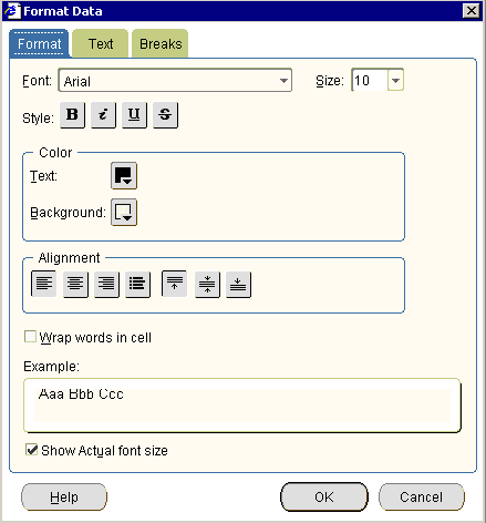

You change the format of worksheet items to change the default look and feel of a worksheet. For example, you might want to:
change the text color of worksheet values
modify the number of decimal places displayed
change the background color of headings and totals

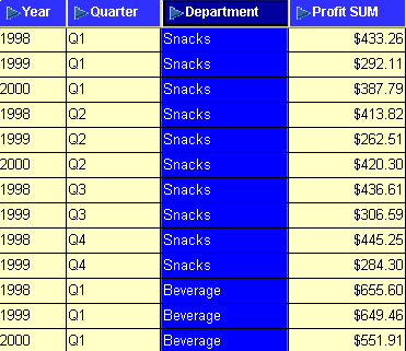

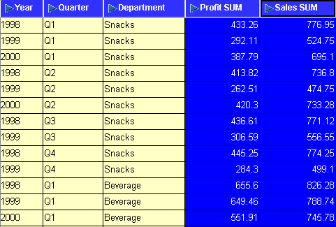

To change the format of worksheet items:
Display the worksheet you want to edit.
Select one or more worksheet items you want to edit.
For example, click one or more item headings in the data area.
Hint: You can select multiple items by pressing the Ctrl key and clicking another item. In the example below, the Quarter and Department items are selected.
Choose Format | Data to display the "Format Data dialog".
Note: The tabs that you see on the "Format Data dialog" depend on the number and type of worksheet items you select, as follows:
if you select a single worksheet item or multiple worksheet items of the same type, you see a Format tab and a Breaks tab, and a tab corresponding to the worksheet item type (for example, Text, Number, Date)
if you select multiple worksheet items of different types (for example, a numeric item and a text item), you see a Format tab and a Breaks tab only
Use the tabs on the "Format Data dialog" to change the worksheet item settings, as follows:
use the "Format Data dialog: Format tab" to change the text style (for example, text font or text color)
use the "Format Data dialog: Date tab" to change the format of date items (for example, to change the date format for a Year item from YY to YYYY)
use the "Format Data dialog: Number tab" to change the format of numeric items (for example, to add or remove decimal places, specify a currency symbol (for example, $), or create a custom number format)
use the "Format Data dialog: Text tab" to change the format of text items (for example, to change the text style to UPPERCASE, lowercase, or Capitalized)
use the "Format Data dialog: Breaks tab" to change the group sorting style (for example, to insert a blank row after each set of rows to separate areas of the worksheet)
Click OK to save the changes you have made and return to the worksheet.
Discoverer updates the worksheet with the changes that you specified.

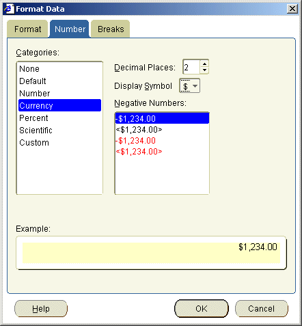

You can specify the currency symbol to use for numeric values on a worksheet. For example, you might want to display the dollar symbol next to sales figures.
To set the currency symbol for a numeric item:
Select one or more numeric worksheet items to edit.
Hint: You can select multiple items by pressing the Ctrl key and clicking another item. In the example below, the Profit SUM and Sales SUM items are selected.
Choose Format | Data to display the "Format Data dialog: Format tab".
Display the "Format Data dialog: Number tab".
Select Currency in the Categories list.
Select the currency symbol to use from the Display Symbol drop down list.
Click OK to save the changes you have made and close the dialog.
Discoverer displays the selected currency symbol in front of the worksheet item values. The example below shows the dollar ($) currency symbol displayed next to Profit SUM values and Sales SUM values in a worksheet.

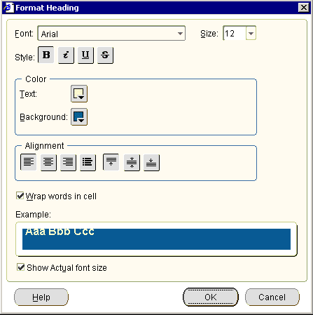

You change the format of worksheet item headings to change the default look and feel of a worksheet. For example, you might want to change the default alignment or background color of a column heading.
To change the format of a single worksheet item heading:
Select the worksheet items you want to format.
Choose Format | Heading to display the "Format heading dialog".
Use the "Format heading dialog" to change the format of the selected item headings.
Click OK to save changes and return to the worksheet.

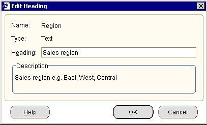

You change the text in item headings to change the text that is displayed at the top of a column or the side of a row (on crosstab worksheets). Item names are usually descriptive enough to use as the heading. However, sometimes you might want to change the heading to something more descriptive.
For example, you might want to change the heading of the Calendar Year item from Calendar Year to Year. In the example below, the item headings are Year, Quarter, Department, Profit SUM, and Sales SUM.
To change the text in an item heading:
Select an item on the worksheet.
For example, click an item heading in the data area. In the example below, the Department item is selected
Note: If you select multiple items, the Edit Heading option is grayed out. You can only edit one item heading at a time.
Right click on the item heading and select Edit Heading to display the "Edit Heading dialog".
Use the "Edit Heading dialog" to change the heading text.
