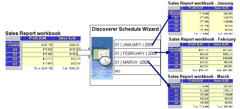

In the example below, Discoverer processes the Sales Report workbook once per month, which produces a set of scheduled workbook results each month.
When you create a scheduled workbook, Discoverer makes a copy of the workbook that you schedule and processes this copy. If you update the original workbook, you must create a scheduled workbook to implement the updates. For example, you create a scheduled workbook to process Workbook 1 once per month. Discoverer takes a copy of Workbook 1 and processes it once per month. If you update Workbook 1 (for example, add an item to a worksheet) you must create a scheduled workbook to process Workbook 1.

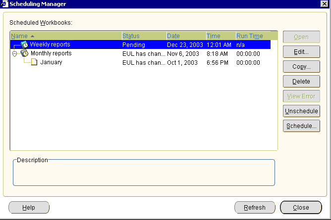

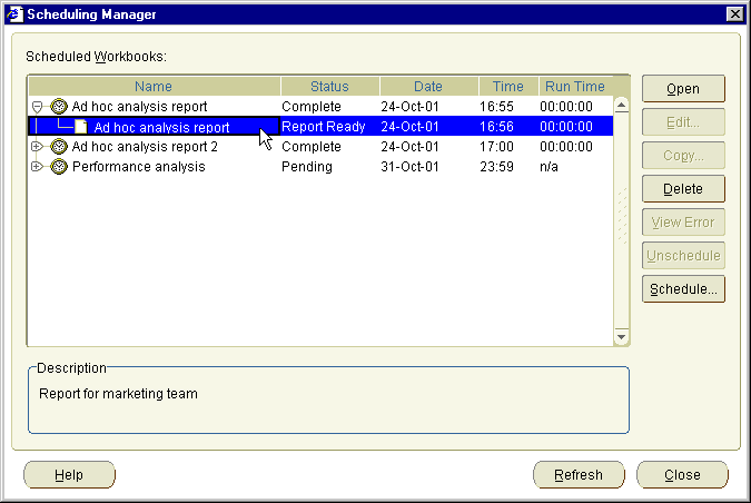

You manage scheduled workbooks using the Scheduling Manager (choose File | Scheduling Manager to display the "Scheduling Manager dialog").
You do not have to be running Discoverer for Discoverer to process scheduled workbooks. For more information about how workbooks are processed, see "About how scheduled workbooks are processed".

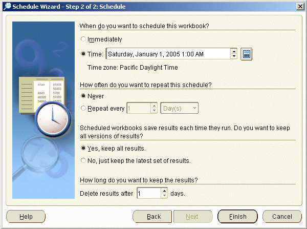

In this example, you want to process a workbook called Sales Report once per week at 1.00 A.M. You want to keep all scheduled workbook results sets so that Discoverer users can access reports for any week.

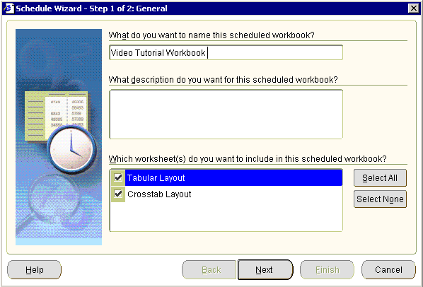

In the Schedule Wizard, you specify the following:
In the When do you want to schedule this workbook? field, you specify the date on which you want to process the workbook for the first time. In the time area of the field, you specify 1.00 AM.
In the How often do you want to repeat this schedule? field, you specify 1 and Weekly in the Repeat every fields to specify once per week.
In the Do you want to keep all versions of results? field, you select the Yes, keep all results check box.
The figure below shows how you use the Schedule Wizard to schedule a workbook to be processed once per week at 1.00 A.M, and keep all scheduled workbook results.

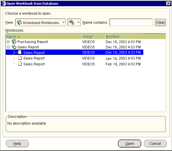

The figure below shows how to use the "Open Workbook from Database dialog" dialog to open a scheduled workbook results set.
Scheduled workbook results sets can be opened in Discoverer Plus Relational or Discoverer Viewer. You can open scheduled workbook results sets at any time when connected to Discoverer.

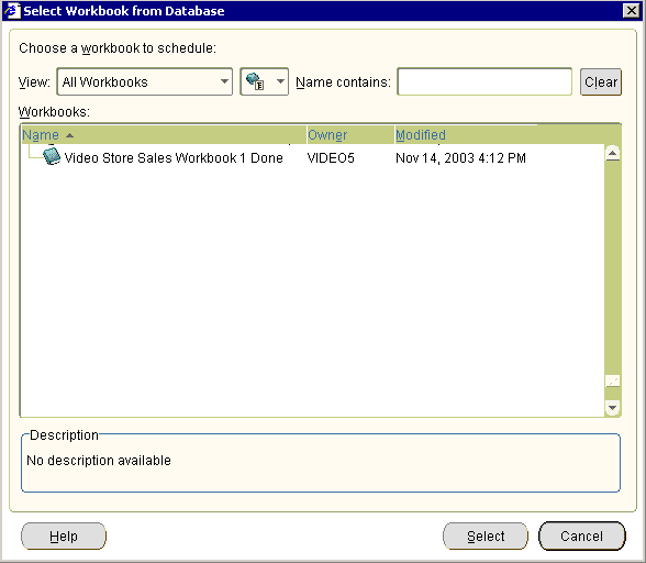

Click Schedule to display the "Select Workbook from Database dialog", which displays a list of workbooks to which you have access.
Select the workbook you want to schedule in the Workbooks list and click Select to display the "Schedule Wizard dialog: General tab".

Use the "Schedule Wizard dialog: General tab" to define a name and description for the scheduled workbook, and specify which worksheets you want to process.

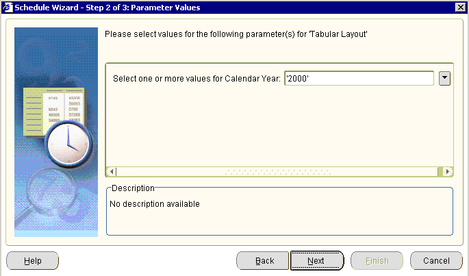

If parameters are required for the worksheets that you have selected, use the "Schedule Wizard dialog: Parameter Values page" to specify values for parameters.
Use the "Schedule Wizard dialog: Schedule tab" to specify when to process the workbook and how frequently it is processed.

To monitor the progress of scheduled workbooks, choose Tools | Manage Schedules to use the "Scheduling Manager dialog".

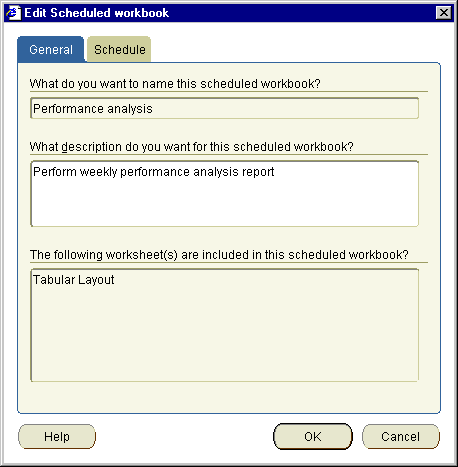

You edit a scheduled workbook when you want to change the instruction to process a workbook. For example, you might want to change the frequency of a scheduled workbook from weekly to monthly.
You cannot edit the read-only copy of a workbook that Discoverer processes.
Note: Changing the instruction does not affect the Discoverer workbook that is being processed.
To edit a scheduled workbook:
Choose Tools | Manage Schedules to display the "Scheduling Manager dialog".
Select the scheduled workbook you want to edit in the Scheduled Workbook list.
Click Edit to display the "Schedule Wizard dialog: General tab".
(optional) Use the "Schedule Wizard dialog: General tab" to change the description of the scheduled workbook.
If parameters are required for the worksheets that you specify, use the "Schedule Wizard dialog: Parameter Values page" Values tab page to specify values for parameters.
Use the "Schedule Wizard dialog: Schedule tab" to change the instruction to process the workbook (for example, change the time or frequency).
Click OK to save changes to the scheduled workbook.

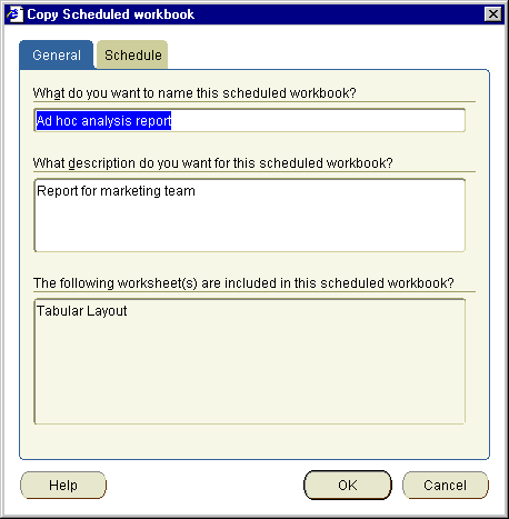

You copy a scheduled workbook when you want to quickly create a instruction to process a workbook based on an existing scheduled workbook. For example, to process the same workbook and worksheets as an existing scheduled workbook.
To copy a scheduled workbook:
Choose File | Scheduling Manager to display the "Scheduling Manager dialog".
Select the scheduled workbook you want to copy in the Scheduled Workbooks list.
Click Copy to display the "Schedule Wizard dialog: General tab".
Use the "Schedule Wizard dialog: General tab" page to change the default name for the scheduled workbook.
If parameters are required for the worksheets that you specify, use the "Copy Scheduled Workbook dialog: Parameter Values tab" to specify values for parameters.
Click OK to save the scheduled workbook.
The new scheduled workbook is displayed in the "Scheduling Manager dialog".

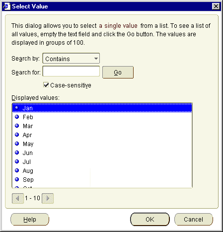

This section describes how to improve productivity using Lists of Values (LOVs) in Discoverer, and includes the following topics:
A list of values (LOV) contains a list of predefined values for a worksheet item. For example, a LOV for a year item might contain the values 1998, 1999, and 2000 (see figure below).
LOVs are created for you by the Discoverer manager.
You use LOVs in:
parameters
conditions
the Discoverer item navigator
the Discoverer Export wizard
the Discoverer Print wizard
LOVs offer the following benefits:
When used in parameters, conditions, and export, LOVs enable you to select predefined values rather than enter arbitrary values in a text field.
When used in the Discoverer item navigator, LOVs enable you to apply conditions to worksheets without defining conditions criteria. For example, choosing January from a LOV in the Discoverer item navigator filters a worksheet to display only data for the January.

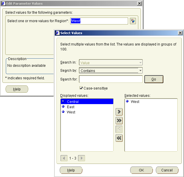

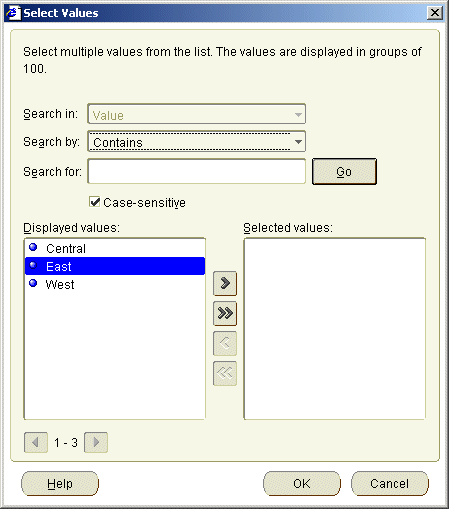

In the figure below, a LOV has been created on the Region item, containing the regions Central, East, and West. If a LOV was not defined on the Region item, you might enter 'South' here, which would result in an empty worksheet because the database does not contain data on the South region. The figure below shows the value West being selected from a LOV in the Select Values dialog.

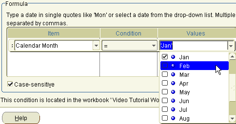

LOVs are also used when you create conditions. For example, in the figure below, the LOV containing months is used to choose values against which to match worksheet data. The figure below shows the value Feb (that is, February) being selected from a LOV in a condition dialog

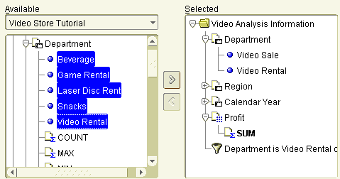

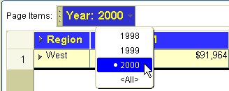

LOVs are also used in the Discoverer item navigator. For example, in the figure below, the LOV values Video Sales and Video Rentals are selected for display on a worksheet. In other words, the LOV values are used to filter the worksheet. The figure below shows the values Video Sale and Video Rental being selected in the Discoverer item navigator.
Note: LOVs in the Discoverer item navigator might be turned off. Contact the Discoverer manager for more details.

When LOVs contain a large number of values, you select single LOV values using the "Select Value dialog". For example, to analyze data from the year 2000, you select 2000 from the LOV.
To select single values from long LOVs:
Display the "Select Value dialog".
from the "Edit Parameter dialog" or "New Parameter dialog", click the down arrow next to the What default value do you want to give this parameter? field, then choose Select values.
from the "Edit Condition dialog" or "New Condition dialog", choose Select values from the Values drop down list.
If the Displayed values list contains the value that you want, select the value from the Displayed values list.
(optional) If you cannot see the value that you want in the Displayed values list, do one of the following:
Use the scroll bar to navigate up and down the values in the current group.
Use the Next and Previous buttons to display the next or previous group of values in the LOV.
(optional) Limit the values in the Displayed values list using the Search by and Search for fields, as follows:
Use the Search by drop down list to specify how you want to match LOV values.
For example, Starts with or Equals.
Enter a search term in the Search for field.
For example, if you choose 'Starts with', type A to find LOV values that begin with A.
(optional) Select the Case sensitive check box to match upper and lowercase letters exactly. For example, when selected the value 'CPM' would not find details containing 'Cpm' or 'cpm'.
Note: For quicker searches, select the Case-sensitive check box.
Click Go to start the search.
Values that match the search criteria are displayed in the Displayed values list. Values are displayed in groups. For example, groups of 50 or groups of 100.
Select the value that you want from the Selected values list.
Click OK to choose the selected LOV value and close the dialog.
The LOV value that you specify is selected.
When LOVs contain a large number of values, you select multiple LOV values using the "Select Values dialog". For example, to analyze data from the values beginning with 'CPM', you select CPM from the LOV.
To select multiple values from long LOVs:
Display the "Select Values dialog".
from the "Edit Condition dialog" or "New Condition dialog", choose Select multiple values from the Values drop down list
If the Displayed values list contains the values that you want, move the values from the Displayed values list to the Selected values list.
(optional) If you cannot see the values that you want in the Displayed values list, do one of the following:
(optional) Select the Case-sensitive check box to match upper and lowercase letters exactly. For example, when selected the value 'CPM' would not find details containing 'Cpm' or 'cpm'.
To select the values that you want in the Displayed values list, move LOV values from the Displayed values list to the Selected values list.
Click OK to choose the selected LOV values and close the dialog.
The LOV values that you choose are selected.
Notes
To deselect LOV values, move LOV values from the Selected list to the Displayed list.

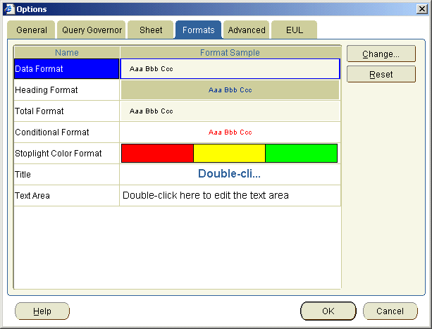

To change default settings:
Choose Tools | Options to display the "Options dialog: General tab".
Display the appropriate tab for the properties you want to edit.
The table below describes the tabs available on the Options dialog.
| Tab | Use to |
| "Options dialog: General tab" | Specify how Discoverer displays data when worksheets are first opened. |
| "Options dialog: Query Governor tab" | Specify how Discoverer uses summaries, and how Discoverer manages execution of queries. |
| "Options dialog: Sheet tab" | Specify how Discoverer displays worksheet headers, titles, text area, gridlines. |
| "Options dialog: Formats tab" | Specify the format that Discoverer displays new worksheet headings, titles, text area, data, totals, stoplight colors, and conditional formats. |
| "Options dialog: Advanced tab" | Specify how Discoverer queries the database, and uses joins. |
| "Options dialog: EUL tab" | Specify a default End User Layer (EUL) if the Discoverer manager has given you access to multiple EULs. |
Click OK to save the changes that you have made and close the Options dialog.
The changes to Discoverer's default appearance and behavior take effect when you close the dialog.
Notes
After changing format settings on the "Options dialog: Formats tab", you can revert to the original default format settings using the Reset button (see "How to revert to the default format settings").
Do not change settings on the "Options dialog: Advanced tab" or "Options dialog: EUL tab" unless asked to do so by the Discoverer manager.

To revert to original default format settings:
Choose Tools | Options to display the Options dialog.
Display the "Options dialog: Formats tab".
Select the default format you want to reset.
For example, Data Format or Heading Format.
Click the Reset button to revert back to the default settings for the selected default format.
Click OK to close the Options dialog.
If you reset the default formats, these original default formats apply when you close the Options dialog.

To change the default worksheet format:
Select a format to change from the Name list.
Click Change to display the appropriate format dialog.
For example, the "Data Format dialog (Default Options)", the "Heading Format dialog (Default Options)", or the "Total Format dialog (Default Options)".
Use the format dialogs to specify your changes.
Hint: The Example field shows the effect of the changes that you make.
Click OK to save the changes you have made and close the Formats dialog.
The default formats that you specified are used for new worksheets that you create and for new items that you add to existing worksheets. For example, if you set the default data format style to a blue font with a yellow background, any new items that you add to worksheets would have this format.

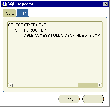

You view a SQL Execution Plan when you want to see the underlying instructions that Discoverer is sending to the server.
To view the execution plan used by Discoverer:
Choose Tools | Show SQL to display the SQL Inspector dialog.
Display the Plan tab to look at the underlying execution plan.
(optional) To copy the execution plan text into memory, click Copy.
You can then switch to a different application and paste in the text.
Click OK to close the SQL Inspector dialog and return to the worksheet.
