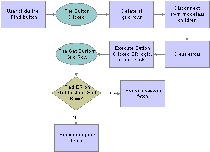

If you set up a custom fetch routine, you will want to make use of Get Custom Grid Row. To perform a custom fetch, attach logic to this event to fetch a single row. To indicate that there are more records to fetch, use the system function, Continue Custom Data Fetch (set it to True).

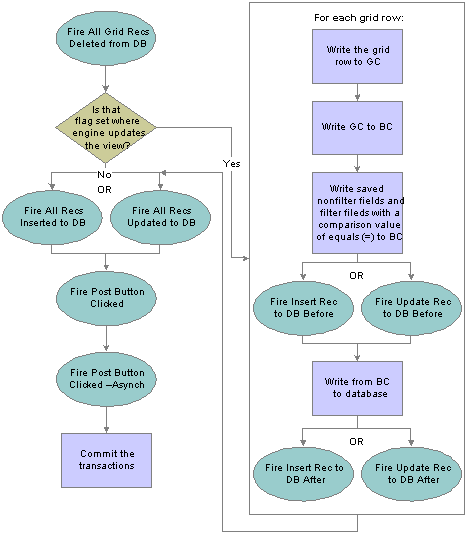

The pattern for adding and updating records is to fire an event immediately before and after commit. Then, runtime fires another event after all the records have been processed. This is a list of applicable events:
Add Grid Rec to DB - Before
Add Grid Rec to DB - After
All Grid Recs Added to DB
Update Grid Rec to DB - Before
Update Grid Rec to DB - After
All Grid Recs Updated to DB

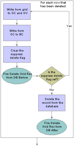

The pattern for deleting a row is similar except that runtime notifies you before and after the user action as well as the commits:
Delete Grid Rec Verify - Before
Delete Grid Rec Verify - After
Delete Grid Rec from DB - Before
Delete Grid Rec from DB - After
All Grid Recs Deleted from DB

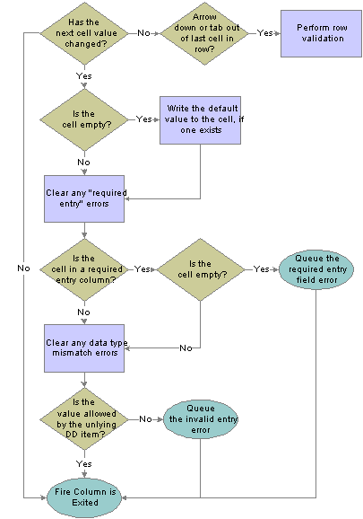

Row is Entered
Row is Selected (Web Only)
Row is Exited

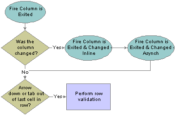

Row Exit & Changed - Inline
This event fires after Row is Exited if the grid is an update grid and the row has been changed since the last time the row was exited.
Row is Exited & Changed - Asynch
This event fires after Row Exit & Changed - Inline if the grid is losing focus, or if another row is entered. Row is Exited & Changed - Asynch is equivalent to validating the contents of the row. It is often used for the Edit Line master business function.
Kill Focus on Grid
This event fires whether the user or runtime changes the focus.

This flowchart illustrates the steps that occur when find is initiated:
Grid control find button processing

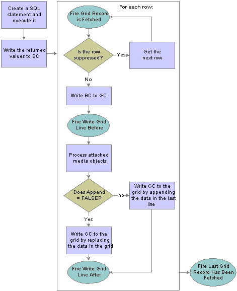

This flowchart illustrates how the system performs an engine fetch:
Grid control fetch processing

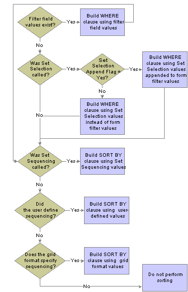

This flowchart illustrates how the system creates the SQL statement:
Grid control SQL processing

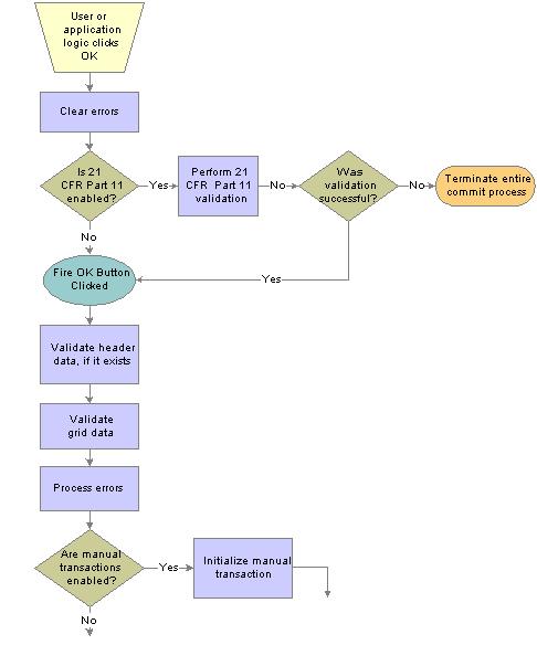

This three-part flowchart illustrates how runtime processes the act of writing data from the grid and committing the change to the database:
Grid control database commit, part 1 of 3
Grid control database commit, part 2 of 3
Grid control database commit, part 3 of 3

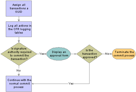

This flowchart illustrates 21 CFR 11 validation:
Grid control 21 CFR validation
This two-part flowchart illustrates grid data validation:
Grid control data validation, part 1 of 2
Grid control data validation, part 2 of 2

Set Lower Limit
Description
Use this system function to create the WHERE clause of a SQL search statement for use in a succeeding fetch when you are searching against a table that employs a ragged hierarchy.
Parameters
Grid |
Input, required. The grid FC to affect. |
Table |
Input, required. The source from which to acquire comparison data. Set the parameter to an alphanumeric constant (<Literal>), <Null>, or an applicable object from the object list. |
Alias |
Input, required. The column of the table from which to acquire comparison data. Set the parameter to an alphanumeric constant (<Literal>), <Null>, or an applicable object from the object list. |
Comparison Type |
Input, required. The comparison operator to use. Set the parameter to the comparison operator to use (<Equal To>, <Not Equal To>, and so forth). |
Comparison Value |
Input, required. The comparison value to use. Set the parameter to an alphanumeric constant (<Literal>), <Blank>, <Zero>, or applicable object from the object list. |
And/Or |
Input, required. Indicates whether to append another WHERE clause to the SQL statement and how the new statement relates to the one before it (AND or OR). Set the parameter to <And>, <Or> or <None>. |

Set Selection
Description
Use this system function to create the WHERE clause of a SQL search statement for use in a succeeding fetch.
Parameters
Grid |
Table |
Alias |
Comparison Type |
Comparison Value |
And/Or |
Additional Notes
In general, this system function should not be used in cases where the user can affect the select. For example, QBE and filter fields are ways the user can affect the select. If the user can affect the select, then the user's select information should always be taken into consideration. This system function can be used in conjunction with Set Selection Append Flag to either append or replace the QBE or filter selection with the system function selection.
See Also

Set Sequencing
Description
Use this system function to create the ORDER BY clause of a SQL search statement for use in a succeeding fetch.
Note. Use of this system function implies that grid formats that include sequencing will not be used in the SQL.
Parameters
Grid |
Table |
Alias |
Sort Order |
Input, required. Whether to sort in ascending or descending order. Set the parameter to <Ascending> or <Descending>. |
Additional Notes
See Also
