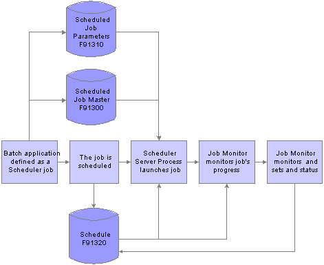

The following graphic illustrates the scheduling process:
The scheduling process
When you define a scheduled job, the parameters of that job are stored in the Scheduled Job Master table (F91300).
After the job is scheduled, the system writes records to the Schedule table (F91320), indicating each time that the job should be launched. As the job runs, the Job Monitor monitors the progress of the job.
When the job ends, the Job Monitor assigns an end status to the job and updates the record of the job in the Job Schedule table to indicate that the job either ended successfully or in error.
